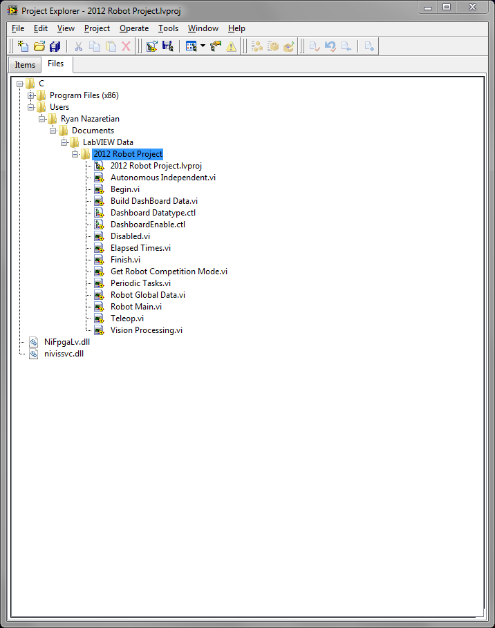

  1. Open your project.
  2. Click on the files tab.
  3. There should be basically two folders that all your files should be in:
    a) Your project folder.
    b) The Program Files folder.
    If you have any of your own files, or files important to the robot code, you will need to move them inside of the project explorer.

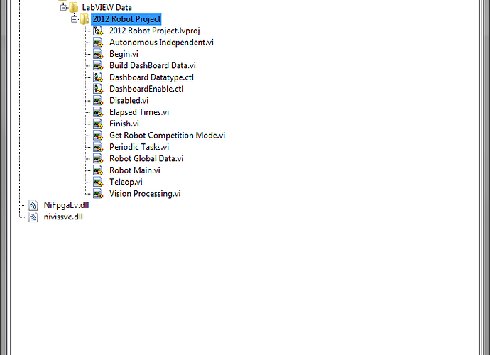

You should have something in the end that looks like this:
