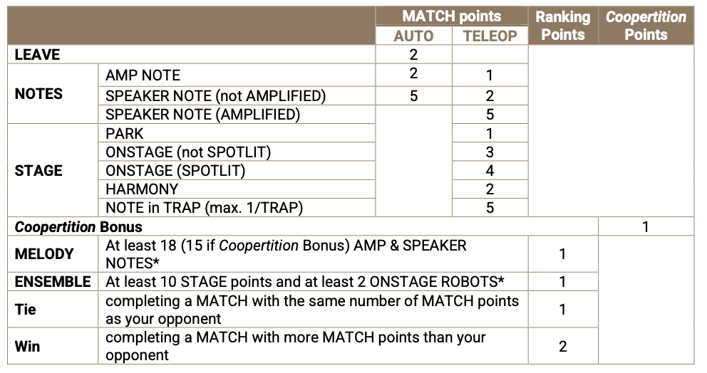

Does a note scored in the trap in endgame count towards your 18 notes (15 if coopertition) melody ranking point? Say you have 17 notes scored and you can score in the trap, do you need to score 1 more in the speaker/ amp or can the last one be the one scored in the trap?
Trap isn’t an Amp or a Speaker, is it? Table 6-2 in Section 6.5.6 of the Game Manual specifies that it’s for Amp and Speaker.
Also, Trap is actually part of the Ensemble RP, per the same table (it’s Stage points.)
Eric beat me to it. Per Table 6-2 Only Amp and Speaker notes count towards the RP
