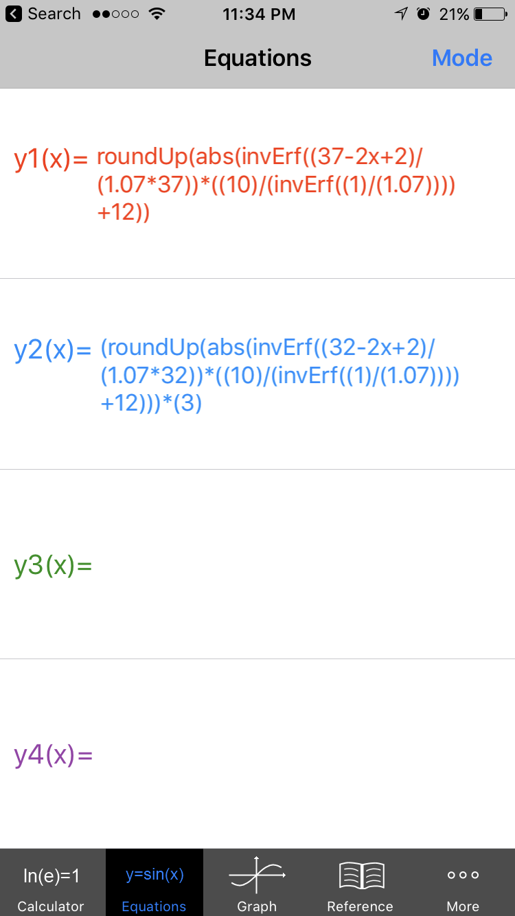

I personally keep the equations in my phone on a free graphing calculator app. I attached a screenshot of what they look like in the app. It works well since the app also has a table function.
37 in Y1 and 32 in Y2 represents the n (number of teams) in the equation.

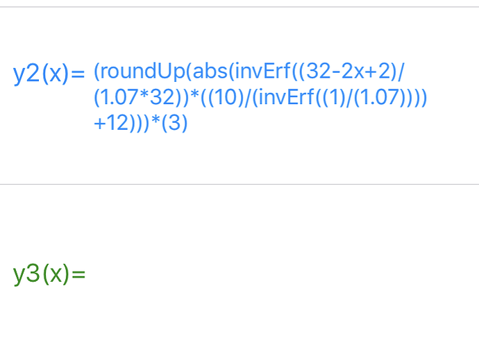

Y1 is setup for a regular district. Y2 is set up for a DCMP (only difference is the *3 part)
Feel free to ask anymore questions if you want to.
