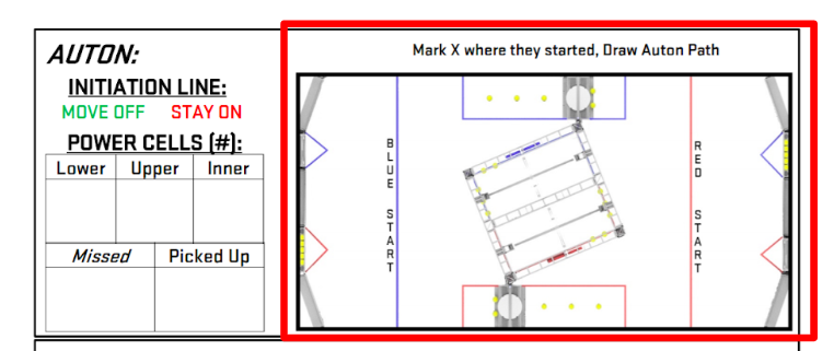

Our team has a section of our match scouting sheet dedicated to autonomous paths. We have our scouters simply draw a line and trace the path that the robot follows during auto and tally the number of balls scored in where. While this does seem like a complicated process, we have had success and accurate data over the years using this method.

Just wondering, is that on paper or electronic?
i think it is paper

Yes, we do our scouting on paper and then enter our data into excel
How do you enter the auto paths into excel?
I should’ve been more specific. All quantitative data is entered into an excel sheet. Our team really only uses the drawn auto paths to determine how much variability teams have in auto as well as auto consistency. As mentioned above, the auto paths are used a lot in discussion with other teams and in the creation of match strategies.
