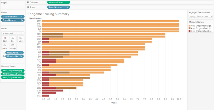

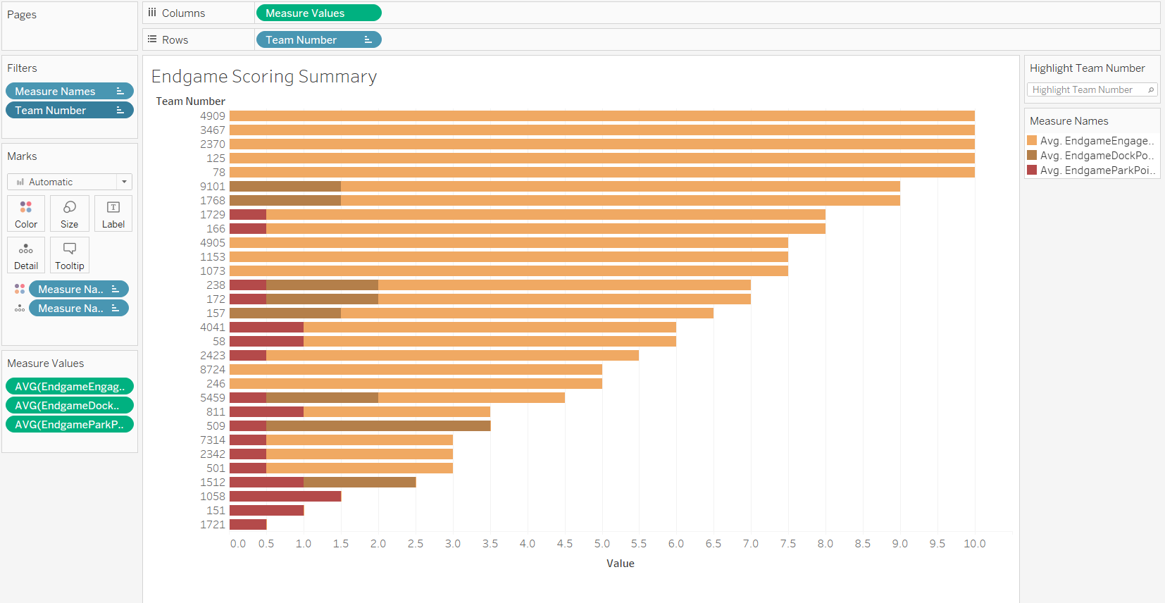

I don’t have exactly the setup that ash4fun is describing, but some of the visualization that we’ve been working on utilizes stacked bar charts. These charts are made in Google Sheets, and use the Google Charts engine, but the point is visualization more than the technology behind it.
I like to start with an objective. We want to see what each team’s mobility success rate is, so let’s create a simple chart for that - see the gauge chart in the top left of the dashboard. We want to see if teams favor cones or cubes. So let’s find a chart that gives us the information in an easy to consume way. Stacked bar charts allow us to see if teams favor cones or cubes and, at the same time, let us see which height of the scoring nodes they favor - see the middle top chart. These objectives go on until we fill out the dashboard below.

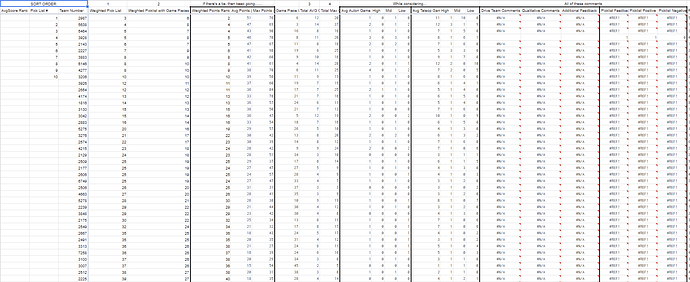

I think a couple people mentioned it above, but there’s really 3 use cases for scouting data… The 2 most obvious ones are strategy (like Corey highlighted above) and alliance selection/picklist development with the third optional one being predictions.

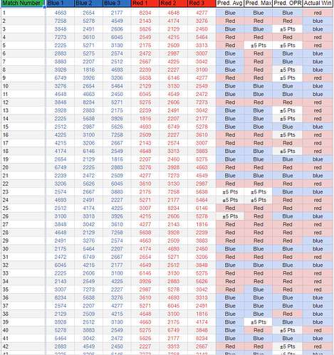

For strategy, my team has been using pure statistics for the past several years. We just threw in a performance (points) graph this year, so we’ll see how much that gets used. The biggest issue with match data that I’ve been wanting to tackle is not only validating data (again, Corey has a pretty good way his team does that) but figuring out how to quantify data with variability, as match schedules can help or hurt them (ie. Defense) and with robot issues some matches (broken down) and then coming back strong in others. Right now my team is using averaging of matches and that has seemed to work pretty well.
Pick Lists is another major area for teams. I’ve been wanting to tackle this issue for several years, and finally have gotten around to it this year (just got a working prototype done a couple of minutes ago actually). This is where you let your data shine in all it’s glory :slight_smile: It’s all about identifying the right metrics/rankings to sort on, how to sort them, and how to weight them.
The third area is mainly just for fun, but it can serve a purpose to give you a rough idea of where you’ll end up for alliance selection. When I was on the team with Corey, we were able to predict Saturday Qual matches at the 2013 KC regional with a 97% accuracy and the Minnesota North Star regional with an 88% accuracy. Though some games lend themselves better for prediction then others (ie. the links in this year’s game have the potential to significantly influence match results).
As you can see in our examples, we’re really focused on the numbers and less so on charts. What I like to tell clients in my day job as a Data Engineer/Architect, is that as long as the data is there, the rest will eventually figure itself out. This is really true in these graphics, as each year new iterations and improvements are made. And there’s definitely things that can be implemented without charts, think colors & sizes. Make the HIGHS and LOWS stand out. Does a team do something really well? You obviously want to consider them when picking an alliance.

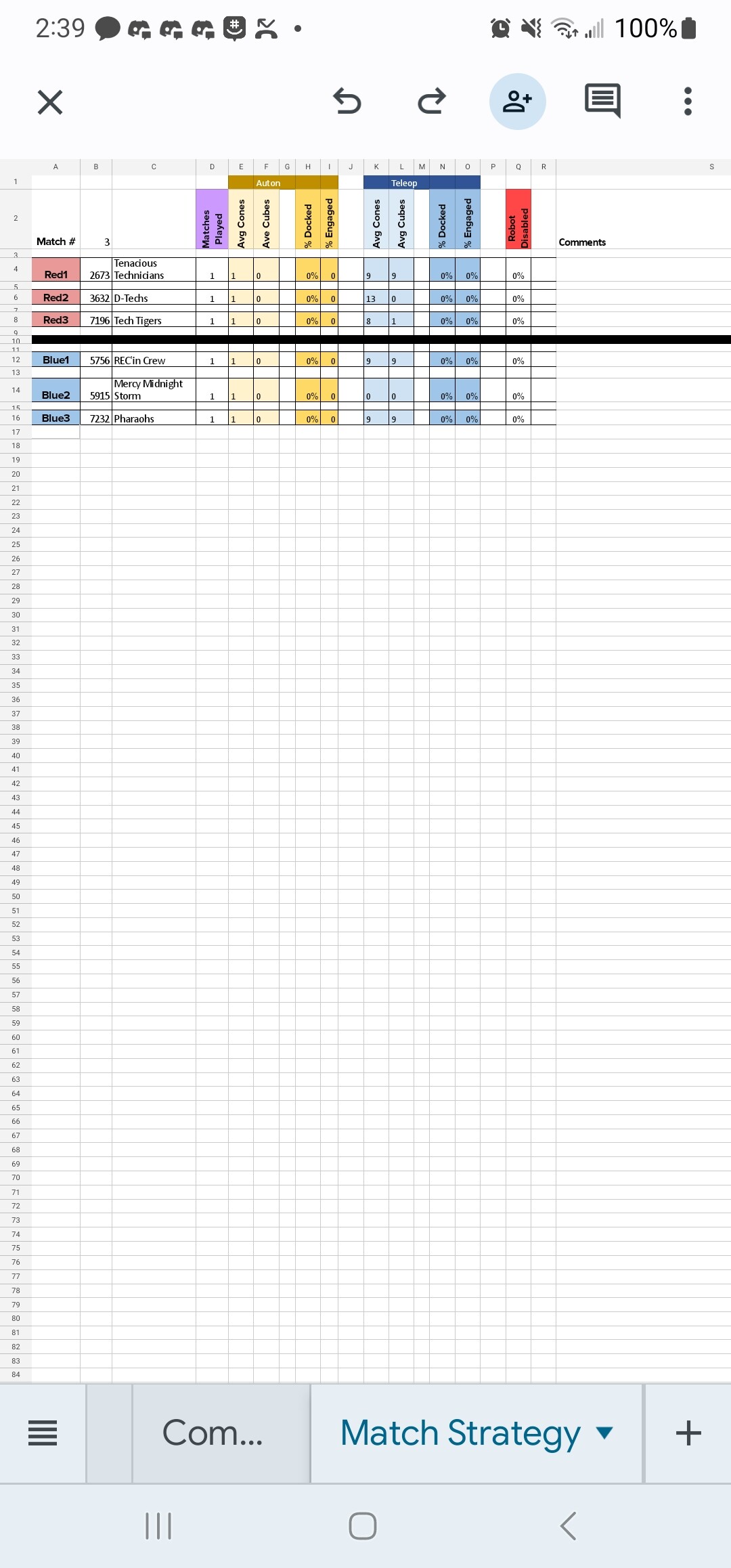

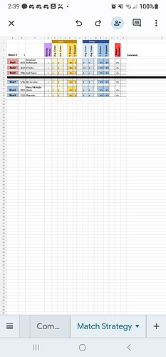

We really just started on a “system” last year. Until then it was very shrouded in mystery by whoever was in charge of Scouting. We’ve had a difficult time transitioning from year to year. (Then covid killed it for sure so we started over last year)
We focus on getting data for match strategy. Which we give to the drive team and they handle the strategy part. We run new current data to them for whatever their upcoming match is each time. Then we focus on picklist data. (Is the same data, just used differently) We don’t really do any predictive strategy or anything like that yet.
As far as our system goes, the data that the scouts collect is dumped into a speadsheet that calculates all of it. We ask the drivers every year what kind of match data they want to see, and how they want to see it. (But We don’t really do charts of any kind, we just display the data.)
I’ll ask questions like: When planning your strategy, do you care where a cone is placed? Or are you just looking for cycle time? Do you need to know chassis size? (Pit scouting) Do you want to know the same things about your partners as you do about your opponents? Based on their answers we make a tab in the spreadsheet just for match strategy.
All the information is automatically filled in when you put the match number in. And gives the most up to date information we have. (Including "comments for any given team. Which is easily inputed from a separate tab. That way we can write qualitative data and observations as well)

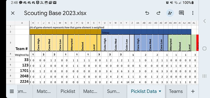

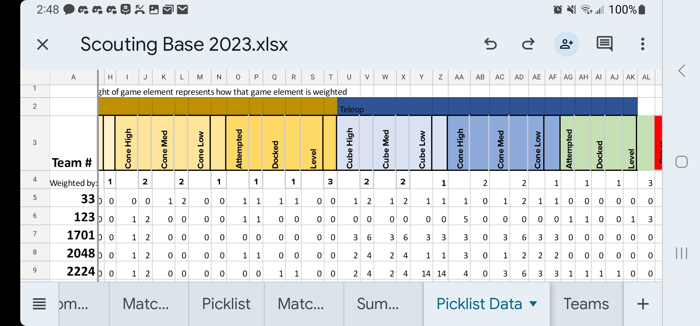

Our picklist is generated by giving a “weight” to whatever we think is the most important features we’re looking for in an alliance partner. And the totals are simply multiplied by the weight.
Such as in this example, we gave a multiplier of 2 to high and mid cones, but only a 1 to low. The total number of cones they placed will be multiplied by that number to give it more “weight”. Then team ‘scores’ are totaled and ranked. This allows us flexibility to easily change the weight and thus change the ranked picklist between our first pick and second pick. (Because you usually chose each for different reasons)
We then take that list and review it along with any comments that were made on each team (while adding the drivers experiences to any teams they played with or against) and manually move teams up or down the list as needed.
It’s not super fancy, but its fairly easy to understand and explain to new students. It’s also almost all automated so all we have to do is input the match schedule in the morning and add the raw data throughout the day. Hit the match strategy tab, put in the match number and you can see the teams playing and how they’ve been doing. Hit the picklist tab and it’s updated everytime new data is added, or the weights are changed.
