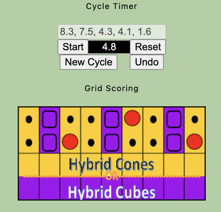

The biggest new feature is the new Clickable Image component. (Thanks @pirate_raider!)
  • Unlike the old field_image, this component allows the configuration of the number of clickable boxes to assign to an image.
  • You can also change the behavior of clicks through configuration. You can allow only one click on the image, one click per box, or unlimited clicks.
  • Finally, the clickable_image can be tied into a Cycle Timer.
Why?
We made a clickable image of the Grid. Now you can easily track where and what game piece a team scores on the Grid. It’s also a simple process to then calculate how many cones and cubes were scored as well as what level (hybrid, medium or high) game pieces were scored.
But that’s not all! The clickable image of the grid is tied into the Cycle Timer in the Teleop page. Start the timer when teleop starts. When a team scores, you just need to click the image and the Cycle Timer records the time and resets the timer for the next cycle. If a team drops a game piece you can manually record the cycle by clicking the New Cycle button.
See how easy it is by trying our 2023 demo.
