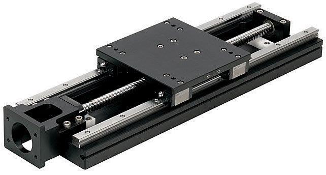

Anyone ever try a screw drive? Was it worth it or nah? Thanks!

You can see the image. Basically the threaded rod spins which moves the carriage. Some 3D printers also use this.
Oh gotcha, just a worm-gear centered mechanical power transmission?
We did a lead screw setup for our elevator in 2015. Great because it was hard to back-drive so we didn’t need to worry about our motors burning up holding the tote in place. Horrible because it was hard to backdrive, which made positioning by hand pretty sucky unless we greased it up just right.

Ahh, you mean a ball screw or a lead screw.
Many teams have used ball screws for motion. Many choose to use a standard threaded rod with bronze nuts to cut cost. Actual ball screws can be quite pricey. Examples used to come with the kit of parts - I’m not sure if they still do anymore.

What you’re describing is a ball screw or lead screw. Teams certainly have used them in their robots, but there are often better ways to get the motion you want. (Of course, that depends on your design priorities; in some cases they are the best way)
Ball screws are often prohibitively expensive for the common lengths of FRC elevators. They are almost always back-driveable, and have up to 90% efficiencies.
Lead screws are not suggested because they are highly inefficient, usually 20-25%. That means that your motor needs to be 4x more powerful than otherwise, and it draws 4x more power from the battery. They are reasonably cheap though, and are usually not back-driveable.
Instead of these, you can use a “standard” chain-driven elevator. This style is likely more efficient, lighter, and cheaper than either option.

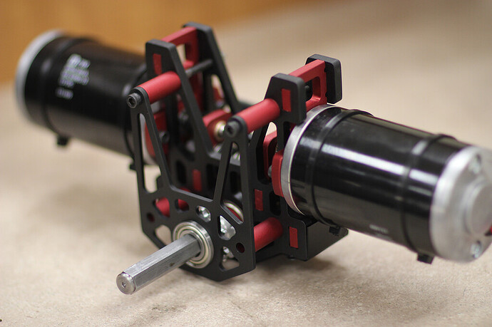

Team 3512 used the AndyMark Worm Box in 2016 and 2017 as our climbing gearbox.
Overall, we were pretty satisfied with it’s performance. A neat thing about it is that because it’s made to be driven by a CIM, you can instead use a VersaPlanetary w/ CIM output which gives you a myriad of different ratio and motor options. Because of tight tolerancing, the Worm Box can be a struggle to put together sometimes and in general definitely has a learning curve before you get good at quick assembly and disassembly. It’s a fairly large gearbox, and especially with a VP mounted to it, it’s a bit of an awkward shape. It doesn’t back drive when unpowered, which can both be a blessing and a curse depending on the application.
Overall it’s a solid product, however now that VEXpro has released a ratchet for it’s VersaPlanetary ecosystem combined with the power of the 775Pro motors, my team probably won’t be using the Worm Box w/CIM in the future for any applications were we need to prevent back driving in a subsystem. The VP ratchet + 775pro combo is lighter, cheaper, and smaller.
