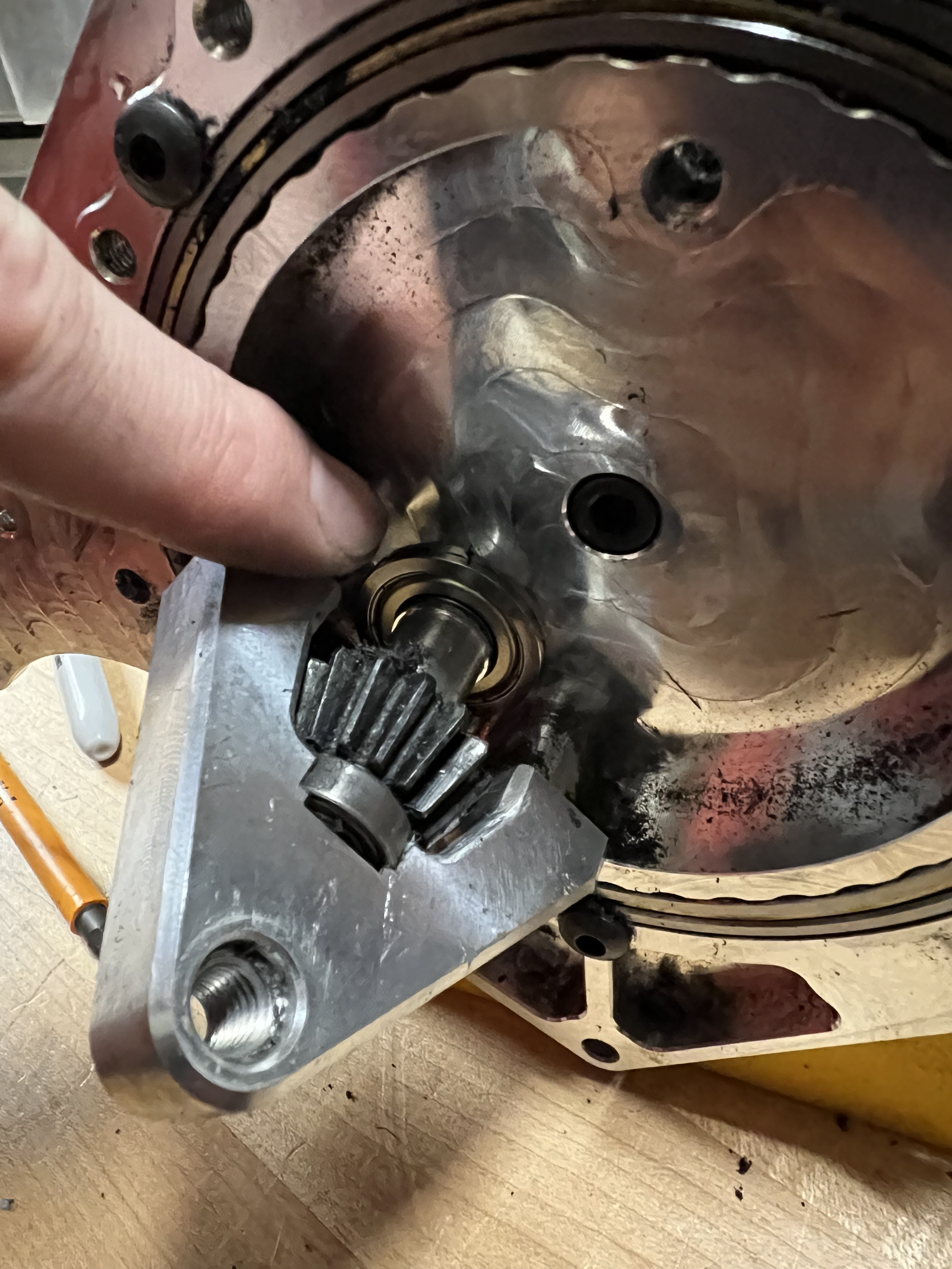

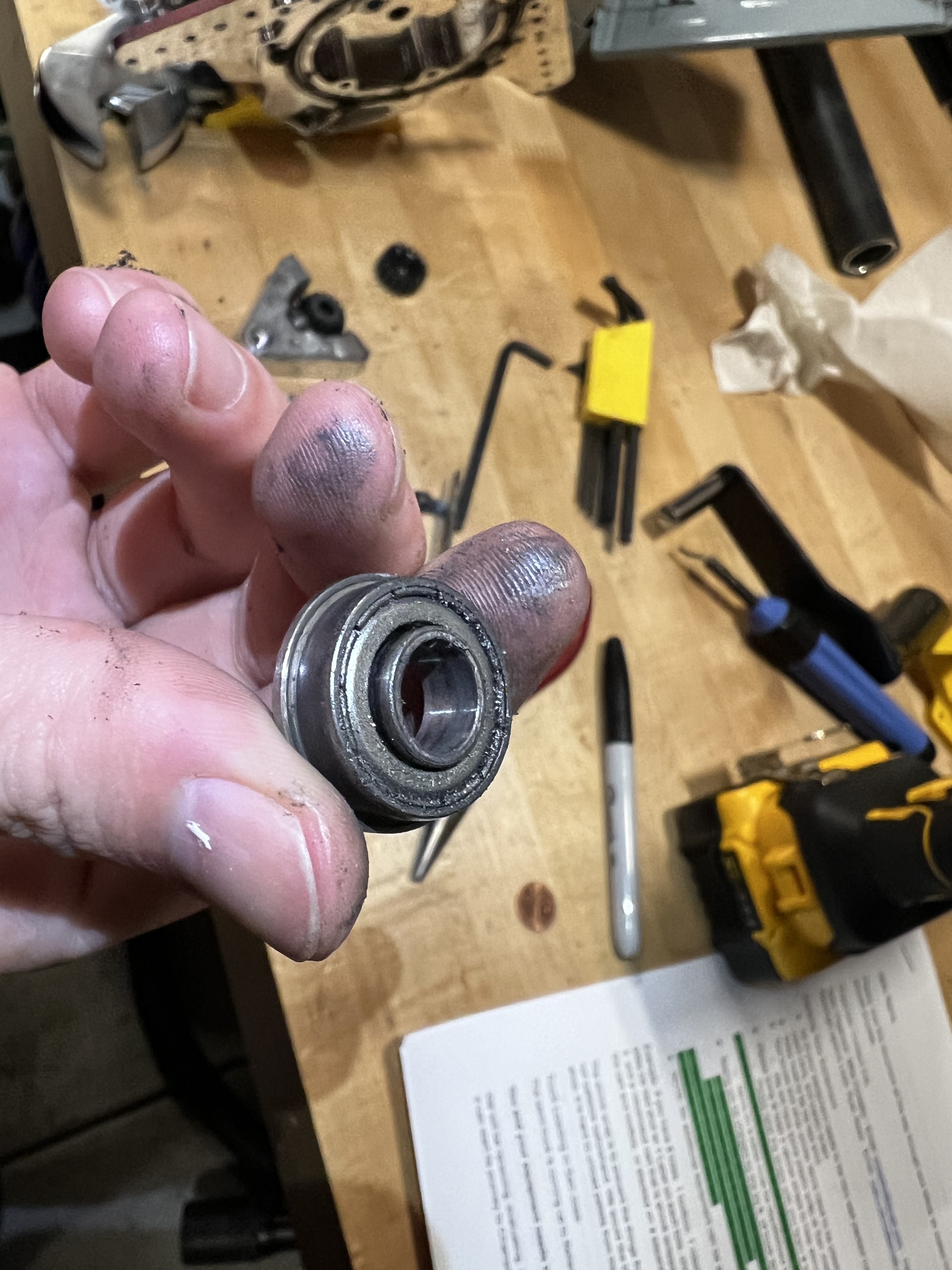

Has anyone experienced this failure mode on the SDS MK4is? We noticed that our drive wheel was binding, and upon further investigation discovered that the 10.25mm ID bearing had ground itself into powder. We are guessing it seized at one point and then ground down.
Is this a fluke one-off or have others seen this? We plan to replace all our bearings as a precaution.

It’s a shielded bearing, so we did not additionally lubricate it. And no we didn’t do anything crazy before the failure, just normal driving.

Perhaps it’s just a faulty bearing, or a lubrication issue (either out of the factory or after use). We flood the 4” X-contact bearing with machine oil but didn’t think to do that with these smaller, shielded bearings.
I guess it’s possible that this bearing is more sensitive to lubrication issues due to the slight thrust load it takes and it’s proximity to carpet dust?
Sometimes you just get a defective bearing. It happens in the real world too.
FRC isn’t the real world? :stuck_out_tongue: /s
But yeah that’s possible. We just like to fully understand all the failures we get, and this was an interesting one. Thanks all who have chimed in so far!

My suspicion is that the load path from wheel to forks to bearing through tiny overlapping corners is applying big bending loads which deforms the balls and ruins the bearing. The WCP Swerve X with screws clamping the inner race I think is a better load path and may be an improvement the “MK5” could do.
Question: is that the new E-clip version of the intermediate shaft, or the original version (with the countersunk #12 screw)? What does the top of the shaft look like? Any witness marks that would indicate that the shaft (or the screw for the older version) was hitting the steering transfer gear? It’s possible that if the shaft was hitting the steering gear, you may have had some impact side loading on this bearing. I still would not have expected it to destroy the bearing, but it may have contributed to some pitting in the races that might have then led to this…
This is the new e-clip version. The top looks pristine.
We had a similar issue with a bearing under the bevel gear (the one in the triangle piece) failing, that module also had excessive wear on the bevel gears so we assume that the bearing failure caused the excess wear.
