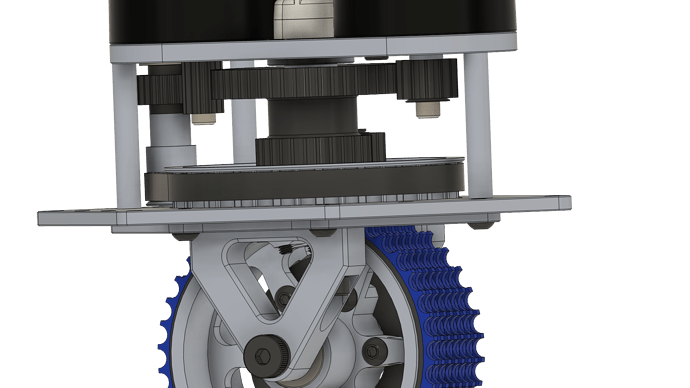

@afk7890 A related question, do you know why the NEO shafts have to be cut? Looking at the CAD, there seems to be plenty of space (0.53 inches when cut, so 0.28 inches when not cut) between the tip of the motor shaft and the next surface. So why do they need to be cut shorter?
(The picture above is when the shafts are cut, but there is 0.53 inches of space so it seems like it should be fine without cutting the shafts?)
We looked as well after finding shaft cutting more of an exercise than we anticipated. It looks like the CAD you are showing has the 9mm steering belt while the more recent MK4 modules have a 15mm belt. Ours are the more recent, so that costs 6mm or maybe a bit more off of the 0.53" so you are getting down to needing to get the extra 0.25" out for clearance.
Ah, okay, that makes sense. Thanks for the quick response!
