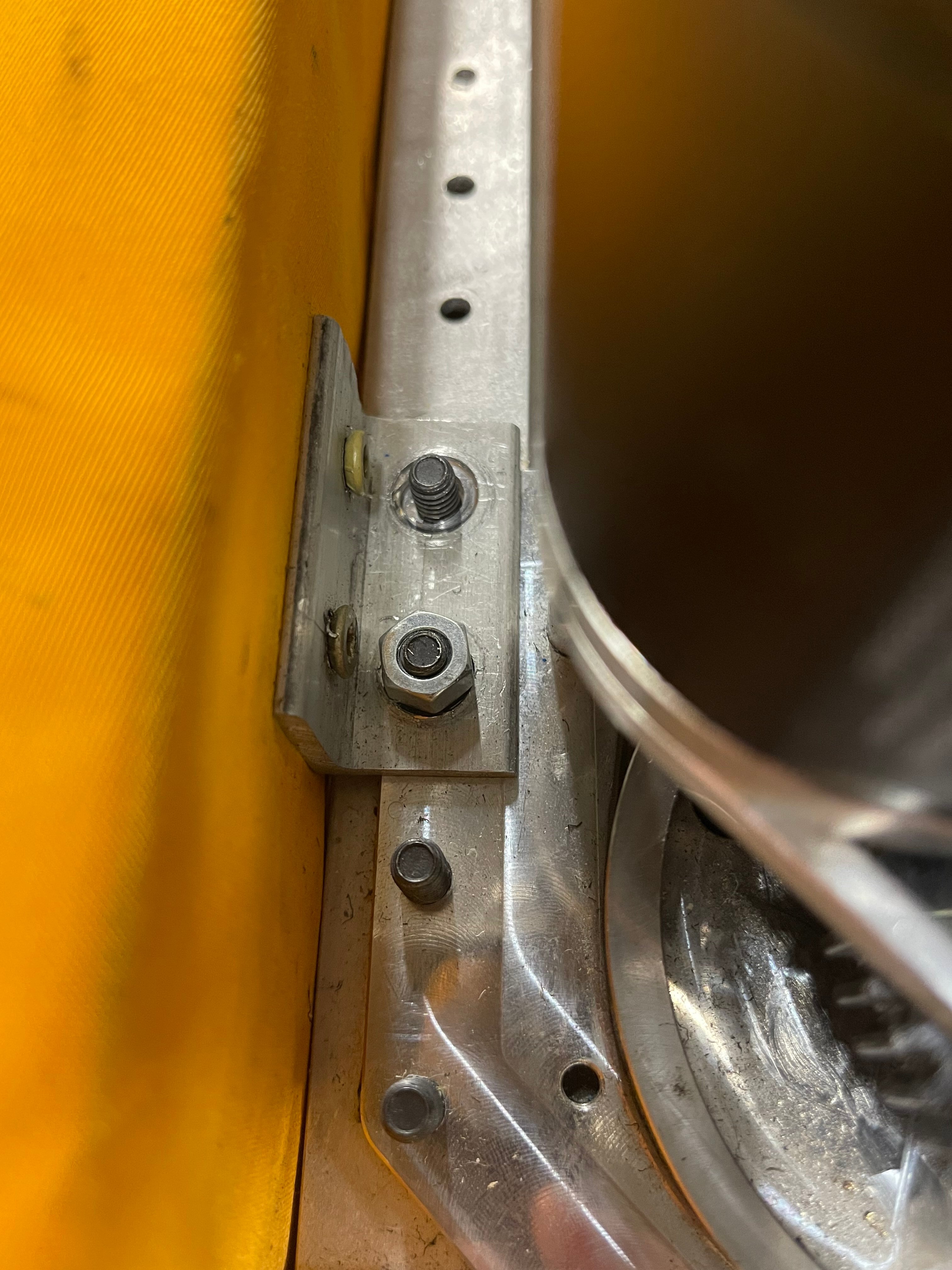

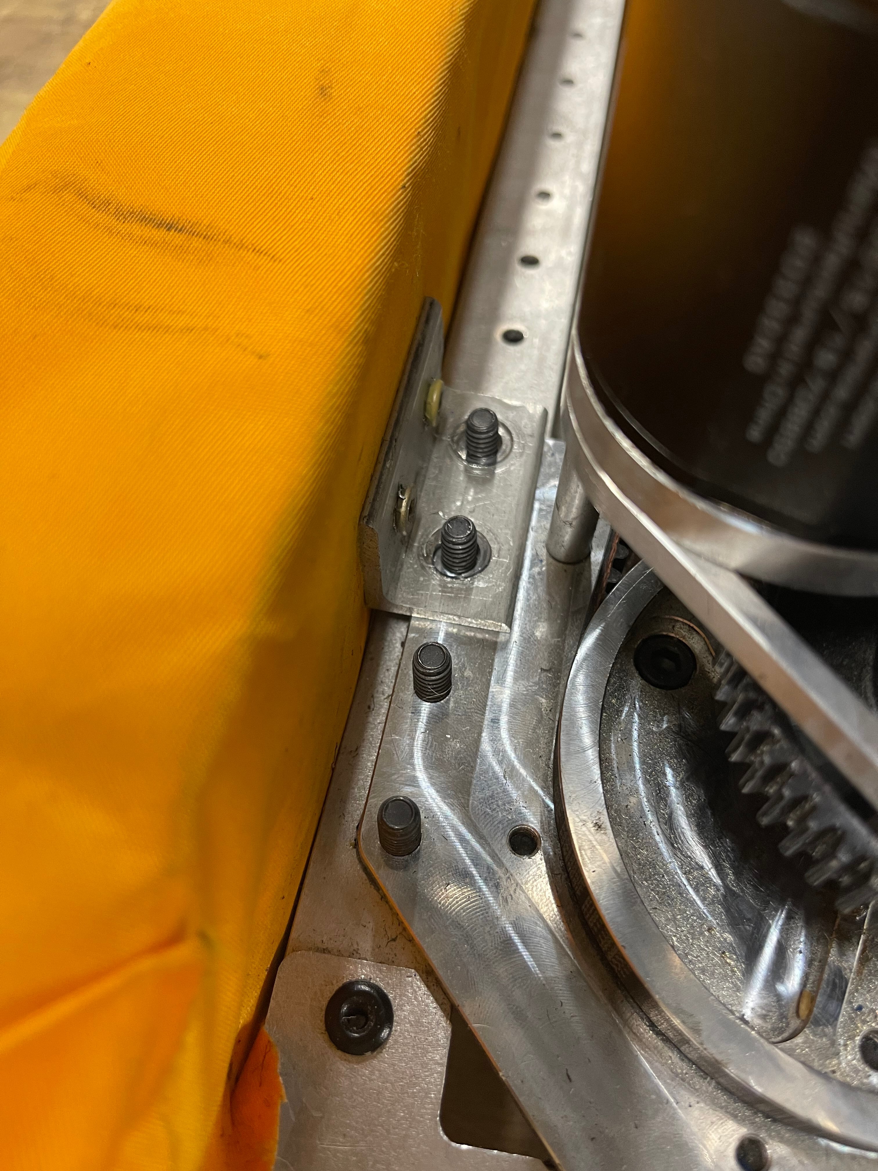

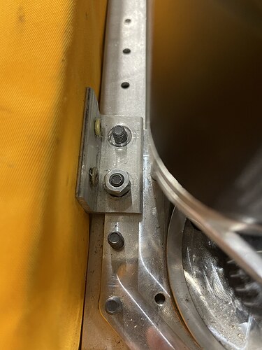

You probably don’t need all 8 bolts per module. If you use threadlocker you can likely get away with 4 per module.
@ToddF This is the way that we (2910) mount swerve modules to the frame and how I would recommend doing it. We use qty 6, 1/4-20 X 3/8"L screws. We drill out the holes in the bottom of the frame so that the head of the screw can pass through the 2 X 1. We typically do not use the screws closest to the corner and instead use them for a rivet on the bottom corner gusset. We use medium strength thread lock on the screws to prevent them from backing out.
I’ve also seen teams use the 1/4-20 tapped holes as 10-32 clearance holes. Which seems sort of sketchy, but in reality works totally fine.
The way we mounted our MK3 Modules onto this was by similarly making clearance holes for the bolt heads. However, we had a slightly different gusset design that allowed us to have more rivets and and module mounting bolts:

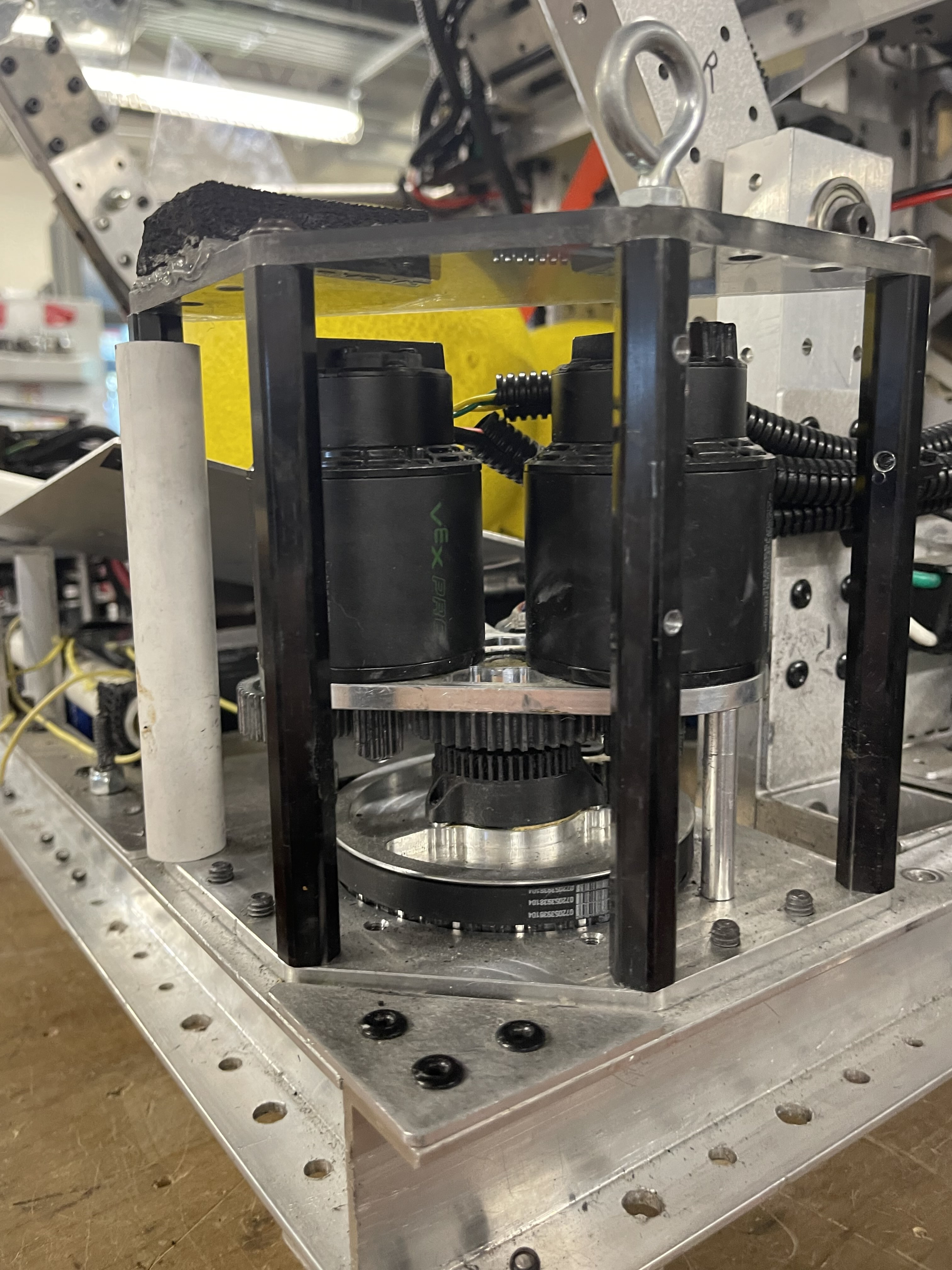

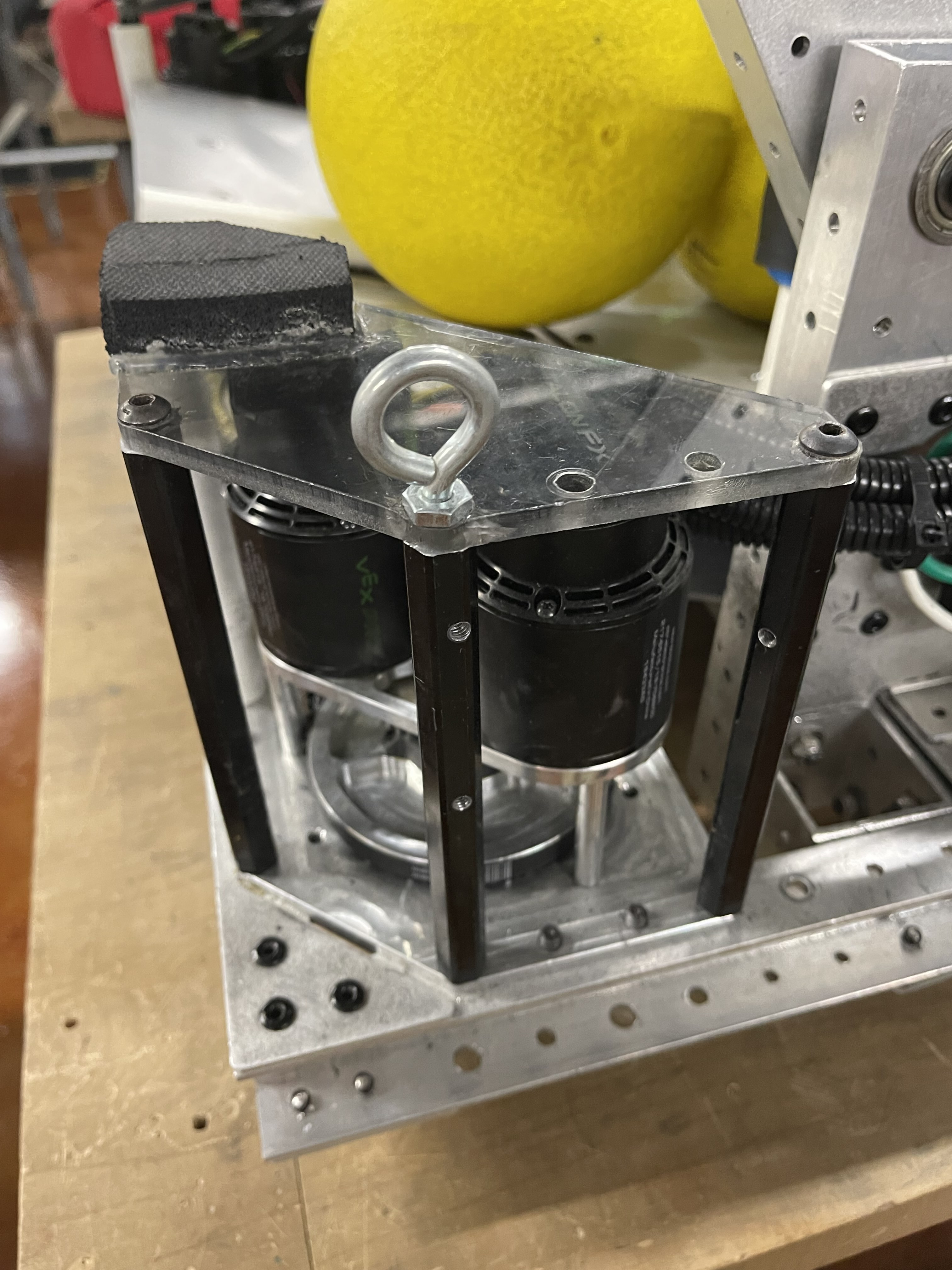

We did the same thing with the 1/4-20 bolts. We love that the plates are tapped. They make great connection points for bumpers.
We also used them as stand-off mounts for thunder hex. These gave our modules some extra protection and provided an anchor point for eye bolts that we use for lifting the robot.

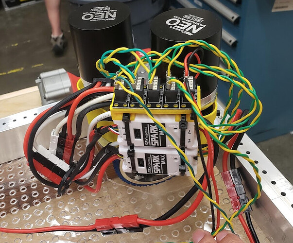

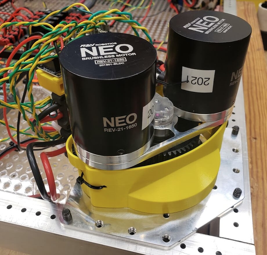

Maybe this will help other teams. Triple Helix is mounting motor controllers and a CAN connector board to some 3D printed shields. This makes the module a removable subassembly with minimal wiring connections.
You can download the assembly from grabcad and print your own. If you do, post pics…
So you know this isn’t just vaporware…
Yes, the wiring will get neater.
Looks great guys.
Obviously, where you choose to define the boundary of the subassembly can have an effect on the steps needed to swap out a module. We have always left the motor controllers outside of that boundary and chosen to break/make the wiring connections between the motor and the motor controller rather than between motor controller and the robot. This is primarily because the motor controllers need to be configured on the CAN bus, so if you swap out one set of motor controllers with another set when you swap the module, you will have some configuration tasks to do to get that running. Plugging a new motor into a motor controller that is already identified on the CAN bus should not require any additional steps. Once the motors are plugged in to the existing motor controller, you should be ready to run.
We, too , are using NEOs so we have this option. If you had Falcons where the motor controller is integrated into the motor, then you don’t have a choice. The motor controllers are inside the boundary and you need to do the configuring of those new devices on the bus.
You probably need to calibrate the zero reading on the azimuth encoder but there is probably not a good way to keep that encoder on the outside of the subassembly boundary such that you would not need to do this step.
Yes, having software reconfiguration be a necessary part of swapping modules is fairly terrifying. I can see coming back from a match with a damaged module, and physically swapping in a new one as doable. Also reconfiguring the CAN network and calibrating the encoder no longer makes the swapout a 5 minute task. I could see the requirement for a rapid swapout driving us to keep the drivers on the robot.
