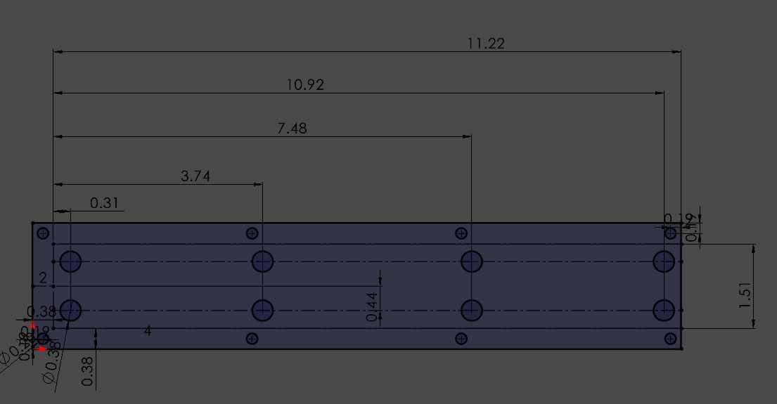

SDS Mk4 Tread Drill Jig

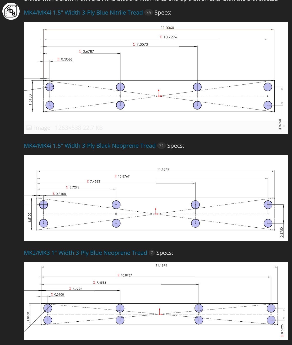

I designed this tread jig back in February of 2022 for our SDS Mk4 modules. A similar design would work for most treaded wheels of this size. I made it using 3/8" thick polycarb, because we had a scrap piece of about this size and it was the same thickness as the tread and the WCP drill bushings that we used as well.
I was told that I needed to make the black tread holes slightly further apart than blue tread, so I added 1/16" between each. We’re choosing to keep it, but it felt slightly too loose, so if I were to do this again I would reduce the current C-C by probably 1/32" for black tread. For blue tread, move the c-c in about 1/16", and shorten the overall length correspondingly in both cases.

We made something very similar, without the drill bushings just straight lexan and it held up to 16+ treads last year: Onshape
I actually went on this same quest two nights ago since before this season we only changed them twice a year since it was such a hassle. We just wanted something fast and simple, cut a 1/8" Alum plate on our WAZER waterjet (Honestly hand machining would work just as well) and clamped the piece to it. I found the drawing files on a CD post from earlier in the year and based it on that, fits absolutely perfectly.
