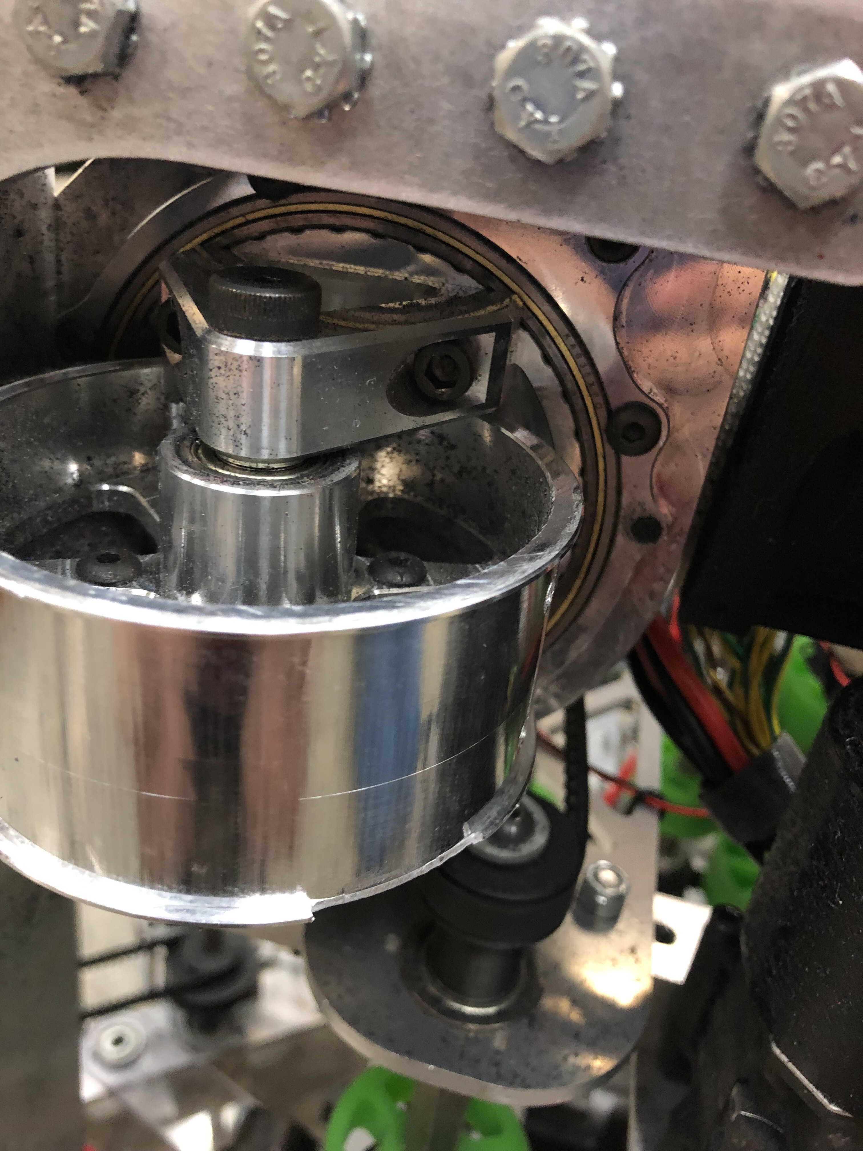

The flanges on the billet wheels can fail because they are too thin. It doesn’t really affect performance once the damage is removed and the burrs are filed off, but I can’t see the flanges surviving multiple competition seasons.
Flange failure images
Do you happen to know what caused the failure?
Run in with the cable protector? Fall from hangar?
I do not know, we just observed them after a comp and we have both fallen from the hangar and crossed the cable protector many times.

We had the exact same damage to the wheel flanges. Between our 3 sets of wheels, we had 4 wheels damaged. We haven’t see any performance issues with it.
We believe its from the cable protector as we have fallen earlier in the season with no damage.
Around week 5 of competition we started to see it as our driver got more aggressive.
