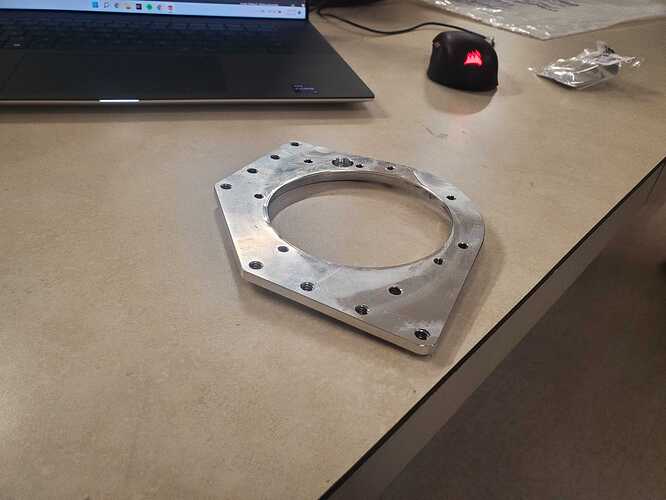

The plates can fail.
We’ve had one of our mk4 (not 4i) plates fail and bend at DCMP, not sure whether a fall or the cable protector caused it, but the bearings were just fine.
What match? And I would love to see a pic of the plates that bent.
Unfortunately we forgot to take a picture of it and we don’t know when it got bent, we just noticed randomly in the pits that one of the plates was bent. It was our front-left module that got bent if you bent, the inner-most corner was raised about 10 degrees and we hammered it back into place to get it back into alignment and haven’t noticed any driving or path following problems after the plate was hammered back.
Team 166 did this in a match at Pine Tree
These swerve drive plates definitely bend with enough impact (ex. falling off traversal) although I imagine the flipped versions are likely harder to bend

I chatted with some of your members on this at BC22. Did you do anything to combat this after your first plate bent?
Be sure to use an absolute encoder to measure the steering direction. Trying to align the module by hand at the start of the match is not viable outside of a testing environment. The Rev Through-bore encoders are absolute encoders and could be used to initialize the encoder position in the Neo.
We had only encountered the issue once and it was at worlds. We considered it a fluke and were fine for the rest of worlds so we didn’t make any attempt to prevent it from happenning again.
Day 2 of battlecry we bent one even worse but ran through the majority of elims with it and were still able to drive perfectly fine. (I’ll post a picture once I get one)
