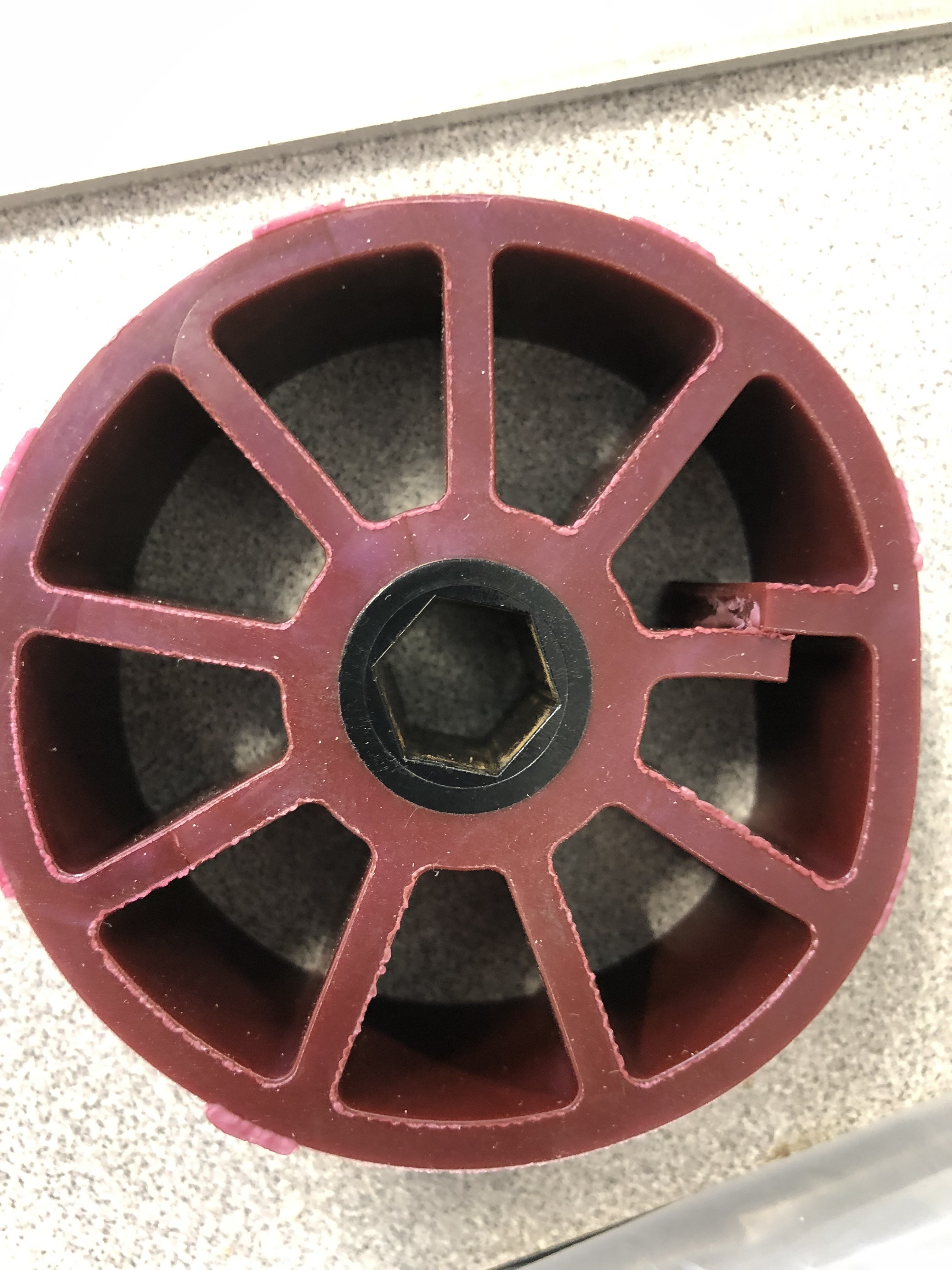

Has anyone else had failure along a “spoke” seam? All 4 wheels and our two replacements have had failure in same exact place.
Just us or is this a common problem?
Have you contacted andymark about this? If not one of their staff members is most likely going to see this but it’s still worth an email. We’re you spinning these very fast? If yes, do you know what RPM you were running the wheels at?

If I remember correctly those are molded wheels so there should be no seams. Parting lines, but not actual seams.
#7
Tom, I didn’t think there were “seams” either, believing all were molded, but every wheel failed in the same exact place. Same exact support “spoke.” (You can tell it is the same by a molding line on the hub and what really looks like a seam.) I didn’t take pics of all of them, but all 6 of 6 have same break.

Hi there!
Thanks for giving us this heads up about this. We’re currently investigating this, and will report back soon about what we’ve found. As a precaution, we’ve halted sales of all Maroon (45A) durometer Compliant wheels.

It looks like it could be a moldflow issue with that parting line. My assumption is that the “drop” where the hot rubber enters the mold is the opposite side of that spoke (should see a little circle imprinted)? If that’s the case then my guess would be that the rubber is cooling off too much before the two flow paths connect, resulting in a poor connection at that parting line.

Hello again,
After some investigation, we did indeed find an issue with some maroon 45A durometer AndyMark Compliant Wheels. We’re reaching out to our customers who have purchased affected part numbers right now. Please note that other durometers of AndyMark Compliant Wheels are not affected by this issue.
Thanks to @Tsquared for bringing this to our attention.
