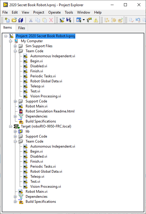

If you want to simulate your robot and deploy to your robot, I added a sample FRC 2020 project to the repository pointed to in the link above. This project combines the standard arcade robot with the shooter simulation robot and field. A robot can be programmed and tested in the simulation, as long as the I/O match the simulated robot (PWM, DIO, AI).
Someone on the NI forum asked about how this project was created. It is essentially a squish of the robot arcade template and the shooter simulation. A more detailed response is here.
