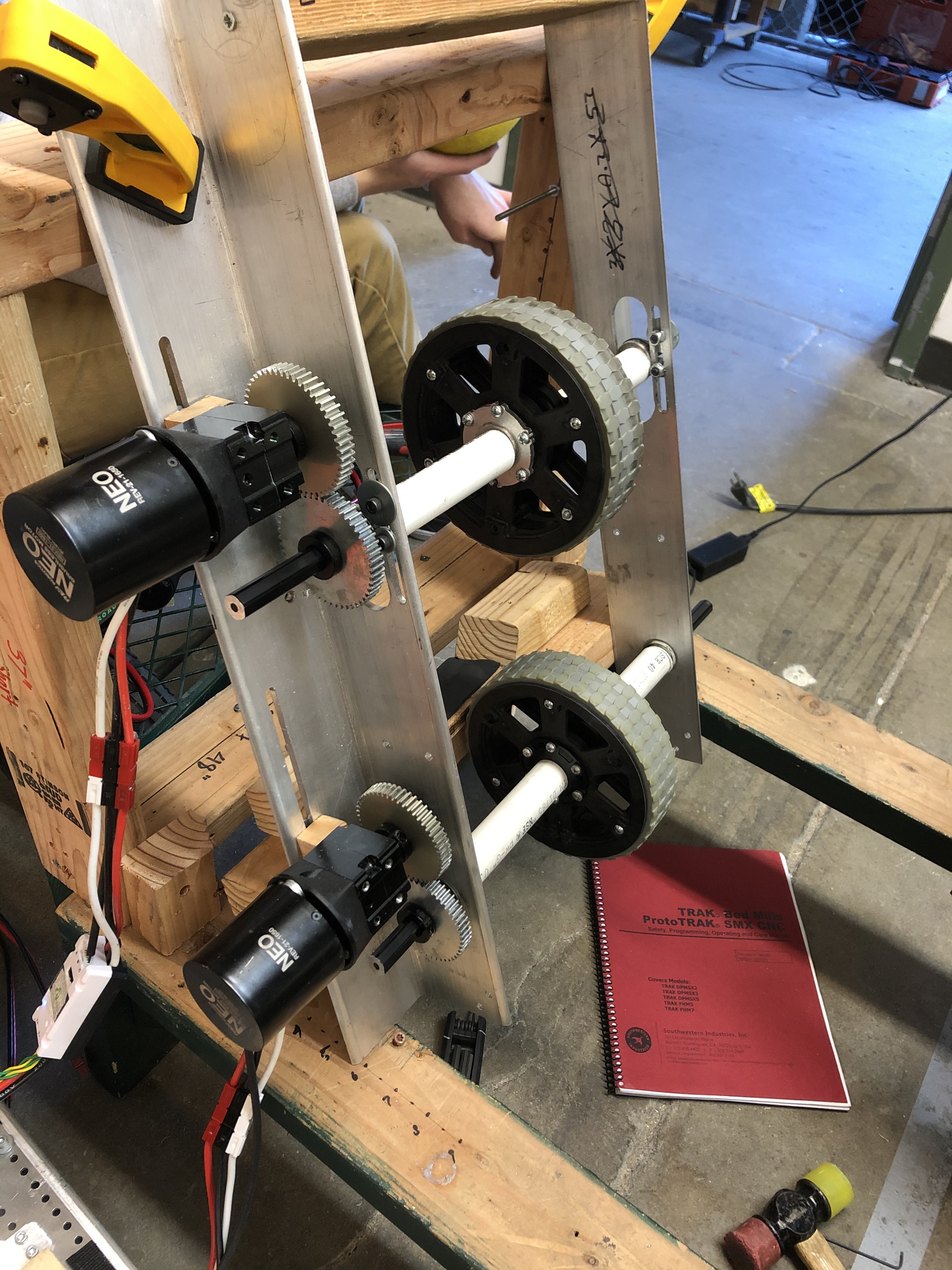

We put our shooter prototype at the sector line distance and gave it a go tonight.

That’s insane. What is your setup?
Motors?
Wheels?
Angle?
Hood Material? (If hooded)
I agree. This is crazy impressive.
I too would love specs but wouldn’t be surprised if they are reluctant to release them (which I am okay with, as they have a right not to).
Guess i got a new regional to keep my eye on week 2…
I will say that it uses two Falcon motors, and two of these wheels. https://www.mcmaster.com/2476k37-2476K8

This is with only basic PID control on the flywheel. No vision at all. The shooter is literally cargo strapped to a KOP tote and a furniture dolly. I believe a lot of the inconsistency is do to the students hand loading the shooter.

Is there an inertial flywheel or are you relying on the falcon torque to get back to speed?
What RPM is the flywheel running at?

Are you willing to give any more information? Such as if your shooter is hooded and just using 2 wheels, or if the wheels are positioned linearly with one another, either horizontally or vertically. Thanks!

Yeah, though I’d tell most people to just use 4 inch andymark stealth wheels in 60A because they have hex bore.
You can take a look at ours. It has a similar range and scoring rate.
If you are looking for a jumping off point for your design we have all of out spec on here. We were testing at 48’ with a 8/10 score rate.
