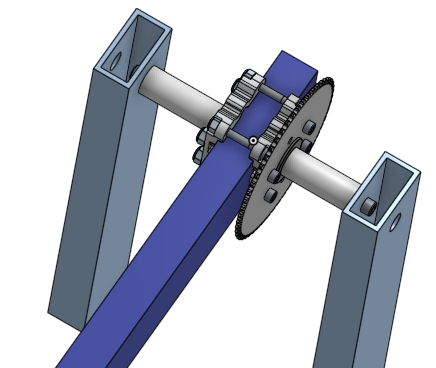

What are some good design options for securing a dead axle in a highish-load pivot application? The model below shows a 3/4" rod bolted into supports as a dead axle and an arm pivoting around that axle using Oilite sleeve bearings or similar. For simplicity, nothing is shown to set the arm position between the supports.
Under load, with sleeve friction, the dead axle wants to become a partially live axle, rotating relative to the supports on the threads of the bolts attaching the axle to the supports. Tightening the axle bolts provides limited friction to stop the axle from rotating. Over time, rotation of the dead axle and bolts would cause wear and enlargement of the mounting holes in the supports if the bolts rotate with the axle or the bolts will come loose from the axle.
Some potential options to manage the situation:
  • Increase the thickness of the support tube wall with another plate inside the tube, Loctite those bolts in the axle, and just live with the wear in the axle mounting holes - hope you can remove the bolts without damaging the axle too much if you need to swap out the arm
  • Embrace the partially-dead, partially-live axle concept and mount the axle to a plate-reinforced tube wall with a little sleeve bearing and shoulder bolt to control the wear
  • Mill some flats on the ends of the dead axle and add a slotted plate on the inner surface of the support tubes so the axle cannot rotate - milling flats adds complexity and a slotted plate would limit the direction in which the dead axle could be removed
One of these options might be acceptable, but I’m sure there are some better ways to install a dead axle so it doesn’t rotate, but it also maintains that primary dead axle feature of being very easy to remove for quick replacement of the pivoting assembly. What are your favorite designs?

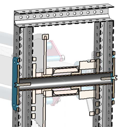

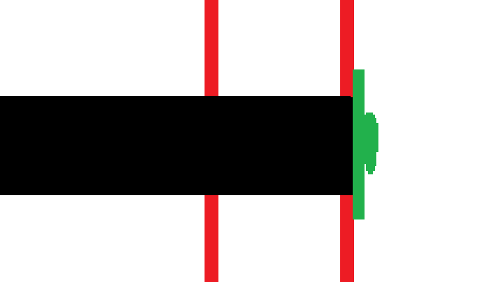

b. While we did implement it in the same manner you did for maintenance reasons, we generally prefer to put a clearance hole for the axle itself in the inside wall of the vertical supports and bolt into the end of the axle through the outer wall. This gives you a much larger bearing surface if the axle starts rotating which should resist wear better, but it harder to disassemble. You can see an example of that on the arm crossbar just below the main axle. We also did opt to add some plates to effectively increase the tube wall thickness near the axle mount point.
Another option in line with this may be to drill a 3/4" hole through both walls of the vertical supports, and add some plates on the end to capture the angle. This way you’re fully supporting the OD of the axle and you can remove the plates to push the axle out without having to splay the tubes apart.

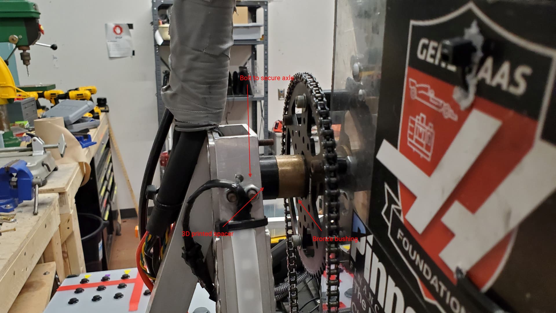

c. I have in the past used airline safety wire for applications like this in FRC; I do think that’s a great solution.

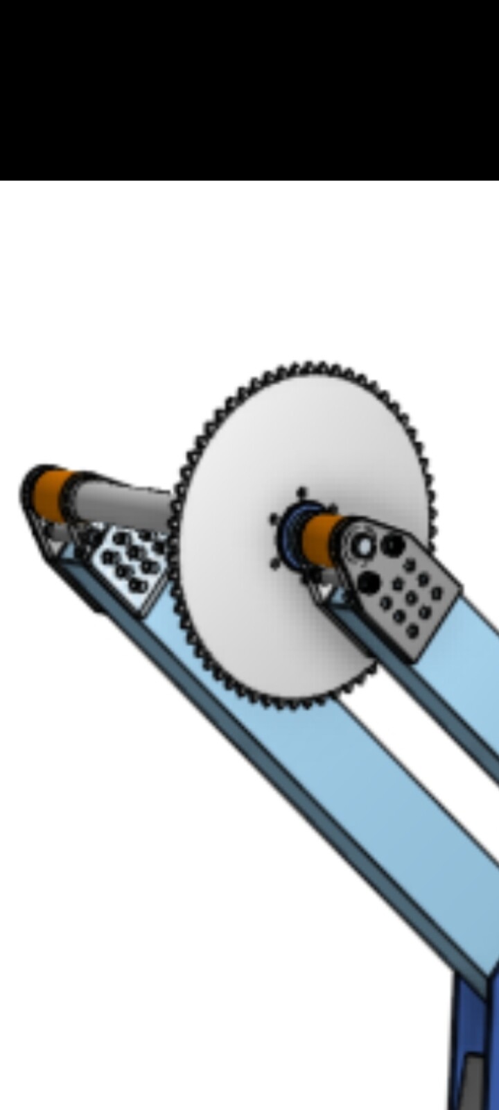

Our team had a very similar dead axle situation, we originally had bolts on a dead axle exactly like the picture. The bolts sheared, and we ended up enlarging the holes and just putting the shaft completely through both tubes, with e-clips on the ends to stop it from falling out.
If you don’t want to make grooves, you could still do tapped ends with a washer-just make sure the washer is flush with the shaft so that the shaft stays supported by both parts of the tube

  2. do what @MisterGrapfruit diagramed to support the rod to offload the axial load from the shaft.
  3. 3d print a plug for the end of the tube with a cross hole and cross drill the upright if it still spins.

One thing to note is that if you decide to index the dead axel through the 2x1 you may consider indexing it through both sides and have a gusset on the outside as the final mounting point. This is to make assembly/disassembly easier because you can slide out the axel without needing further disassembly of the frame which could be a chore. See 7461’s 2023 arm for an example of this. Always design for repair!

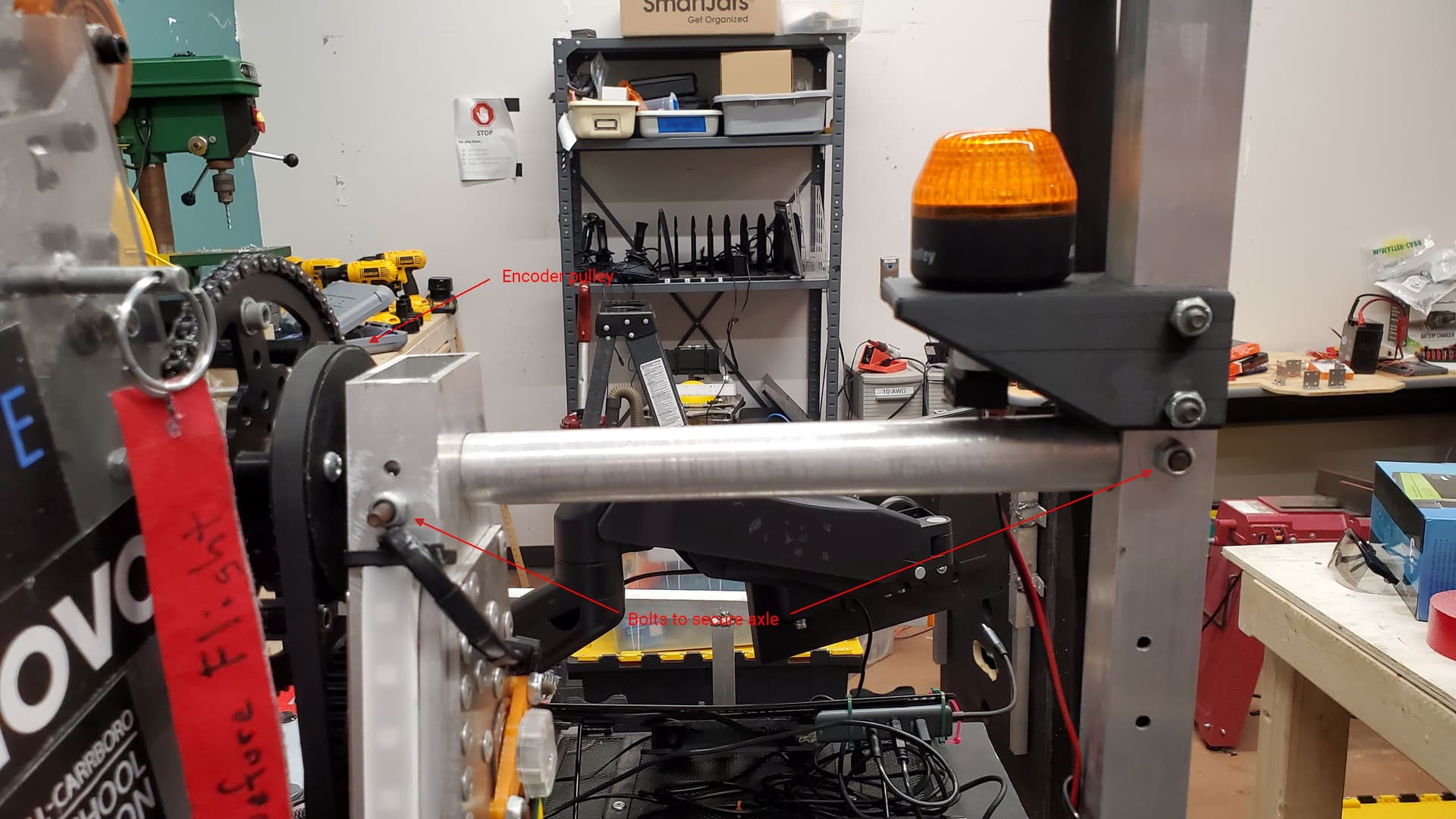

Zombie axles can be useful, especially when you can easily plop an encoder on there.
A good number of the 330 arms worked like that, sometimes with bushings but often just whatever bearing block was handy. Using the same joint style regardless of live or dead axle is more flexible, though may require an additional crossmember between the supports.

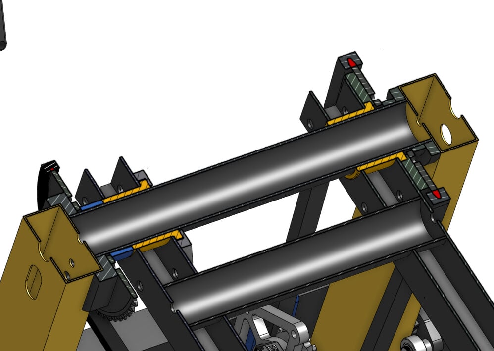

I like this design a lot. Alternatively, one side can just have one wall of the 2x1 pass the whole tube through, with a small hole on the other side. I would definitely not just rely on the shear strength of the bolt or tube nut to secure the tube - instead, run the round tube through at least one wall of the 2x1 so that the wall of the 2x1 supports it and takes the bulk of the load.
We also had something very similar for our elbow joint this year: a 17mm steel rod as a dead-axle with bushings pressed into the second arm tube rotating around the axle. To secure the axle to the first arm tubes on either side, we actually threaded the steel axle to M16 and used locknuts to hold it in place. We were debating drilling and tapping like you did, but having a large thread that we could torque down made the whole first arm structure a lot stronger. Since the bottom axle of the first arm (aka the shoulder joint) was live-axle with the first arm, the whole first arm became a solid rectangle that was very hard to deform.
