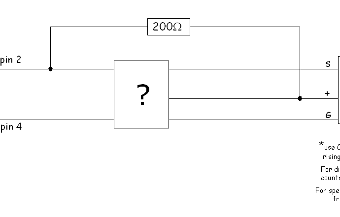

*1a) What is the most reliable and accurate way to connect the signal on pins 2 and 4 of the Bosch Seat Motor to the roboRIO and decode the signal to obtain an output shaft position?
1b) How could you connect those pins to an SRX to do closed-loop position control in the SRX?

**Here’s another kick.
What goes in the box with the “?”**
As suggested I tried a schmitt trigger…seems like the logical choice. Unfortunately the one’s I found only trigger between 2V and 3V. Should have looked closer at the spec sheet :(. MM74HC14 not the right choice.
Sorry, will try and fix that for next year and update the spec sheet after we get some team feedback on what works best with RoboRIO and SRX.
It’s actually an analog output but not in the sense that most may assume. The voltage falls pretty sharply and looking at it may in some way be read as digital if only you could get the drop to fall to zero.
***@ Kevin: what would the scope trace look like if you used, say, a 2000 Ohm resistor instead of 200? **

Update: I did a quick check with 5V and my home scope. You get no signal above around 500 ohms. ~300 ohms you start getting a lot of noise. The sweet spot seems to be between 100 and 250 ohms. 120 ohms gives 1V drop (4.6V-3.6V) 220 ohms gives 1.28V drop (4.2V-2.9V)

The problem is there are only 2 pins (pin4 and pin2). Pin2 serves as both signal output and power input. So when the Hall circuit drops the signal voltage, it also drops its own circuit supply voltage.
A Schmitt trigger with properly set thresholds should do the trick. Anybody willing to give it a try?
BTW, credit goes to Richard Wallace for that suggestion :slight_smile:
Seems like a Schmitt trigger would definitely do the job. Just a matter of finding one in the right trigger range. If that is not possible, I wonder if an Arduino mini could do a similar function. A bit overkill but the benefit is you can customize.
Or brew your own with two cheap BPJ transistors and 5 cheap resistors (resistor ohms selects upper and lower threshold?).
Great Idea! Sure beats spending $10 on a microprocessor.
Update: First test went very well for using the suggested transistor based Schmitt trigger circuit. I got 3V drop square wave using some trial and error and an online calculator. Is that enough for a good read by the SRX and RoboRIO DIO?

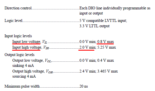

If hi is greater than 2.0V, and lo is less than 0.8V it should work for the roboRIO

Hmmm.:mad: Guess it’s back to further playing with resistor combinations. I was getting something on the order of 4.7V to 1.7V. Will also check again if maybe there was an error on the breadboard.
