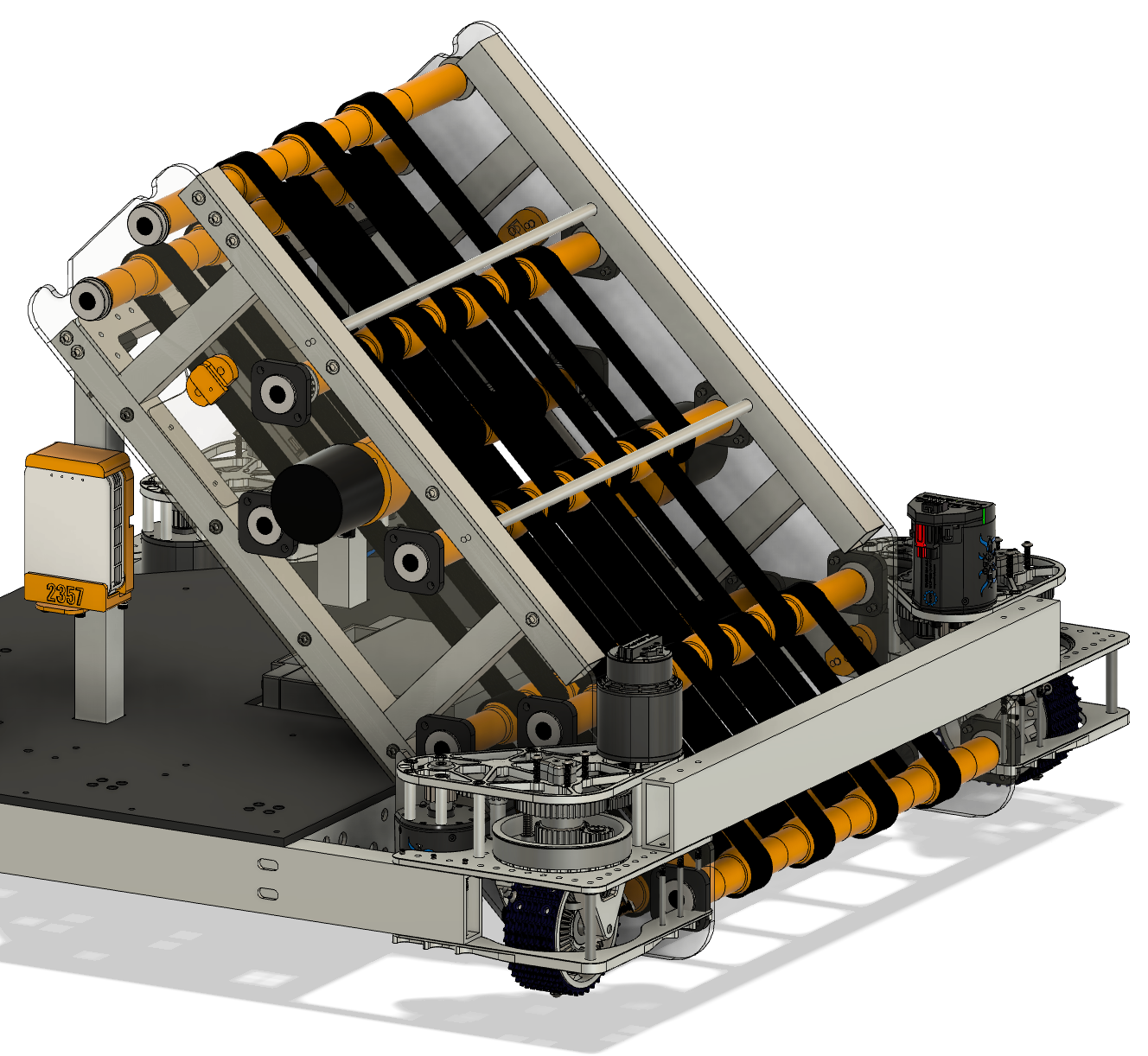

Any suggestions on how to detect note when it gets in the intake?

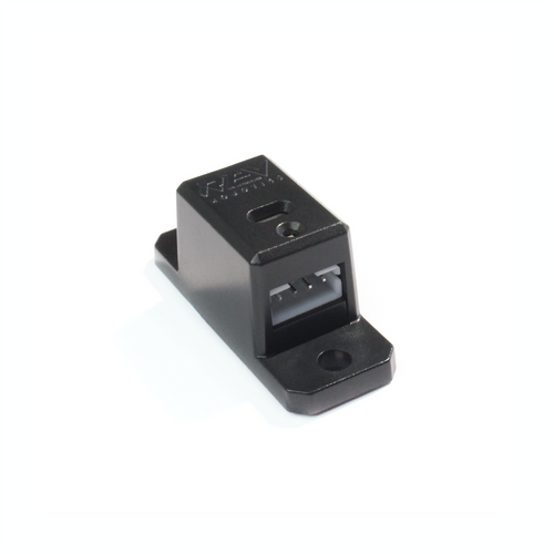

we have found success using a rev color sensor in proximity mode to detect notes. if on hand, itll work however a beam break or similar is probably better.

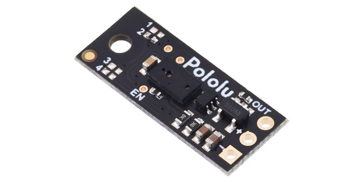

I especially like this one: Pololu Distance Sensor with Pulse Width Output, 50cm Max. It’s cheap, variable distance, it’s relatively simple to read the distance (DutyCycle (WPILib API 2024.3.1)), and since it’s TOF rather than a simple infrared it should be a little more robust. But you should be able to configure the one linked to do the same by changing some jumpers (they are the same board).
