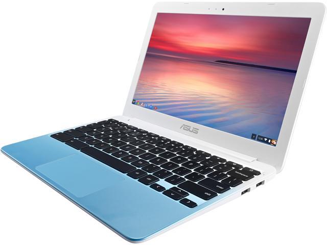

This is legal:
But yet this might not be:
And this might not be either:
Al, I love you guys a lot (seriously, the LRIs have like the worst job because of people like me who constantly needle them) but these battery rules are broken. They’ve been broken for several years since portable USB battery packs became very prevalent.
I can use the same basic technology if it is inside of a cell phone but yet it’s not legal if the battery isn’t sold with the widget as is the case with this carrier board for a TX1 that has an integrated charging/discharging circuit: http://auvidea.eu/images/auvidea/products/tx1/J140/J140_top_bottom.jpg
And I haven’t even talked about super-capacitors which can be used as part of a custom circuit and that seems perfectly legal.
I get that you don’t want to encourage teams to play with batteries and start fires. I really do. BUT the battery rules need to move to the paradigm that many of the other rules have adopted of “allow and explain”.
It makes no sense to me that a team can use a kangaroo PC with a battery built in to it because it is assumed that it is somehow safer than the above linked TX1 carrier that we would need to add a battery to ourselves. If neither is part of the control pathways for the robot and the robot can be safely disabled then what is the harm? Obviously the current rules don’t prevent robots from catching on fire as it is.
