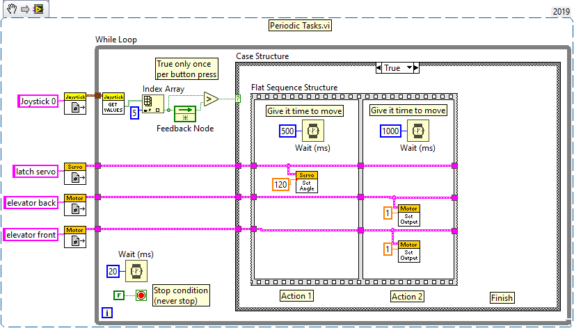

Setting a delay to a motor

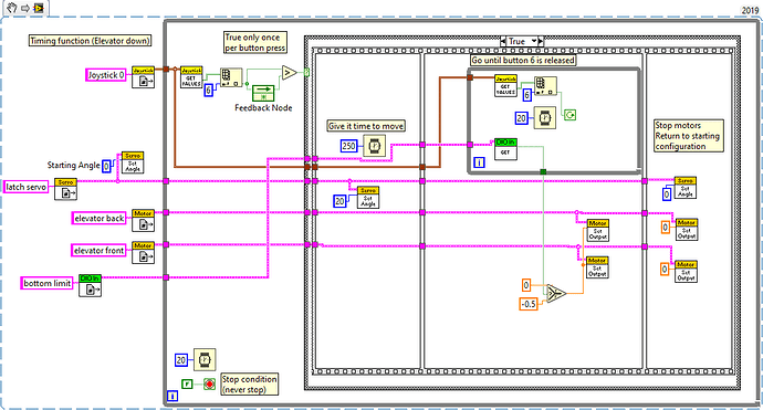

We will check your revised code if you would post it. (either a screen shot or a snippet-highlight code, choose “Create VI Snippet from Selection” and it’ll create an image that’s actual code)
Did you place the code in the Periodic Tasks.vi? (That’s required because of the loop)
Do you call your servo anywhere else? (other calls can/will override the calls in this loop)

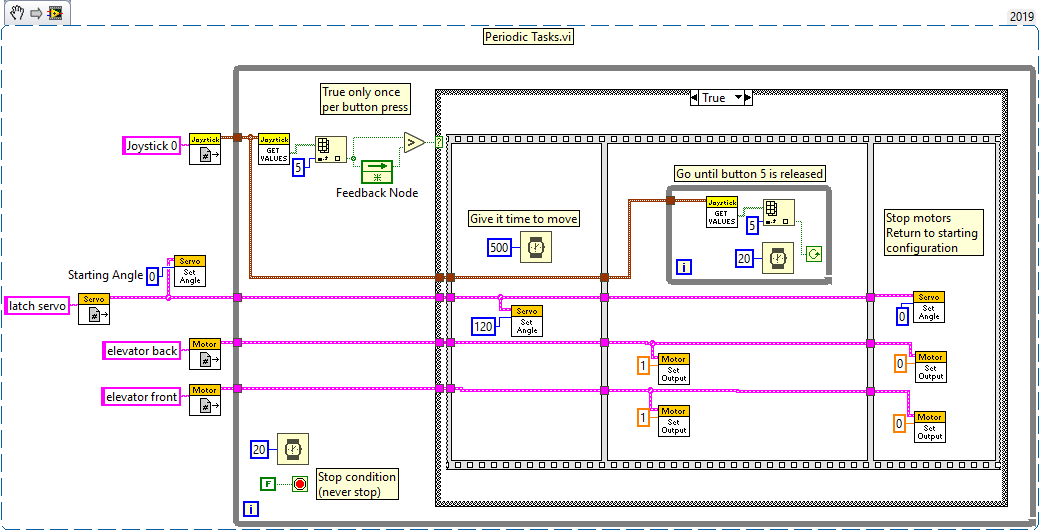

Here’s the snippet (For reference, the servo is the one I want to go immediately and the elevator motors are what I want to delay)
Suggest that you add another sequence tab at the end to turn the motors off.
I’m assuming that safety config for these motors is turned off since they are not being written to periodically?
It’s probably lucky that it didn’t work.
You forgot to stop the elevator motors, so they would run forever.
This is in the Periodic Tasks.vi?
You needed to add in a while button is held check.
The servo would not move if it’s already at the 120 degree position.
Angles are in integer units, rather than floating point.
A half second might not be a long enough time to give a servo to move, but it ill continue to move as the elevator starts.
Something along these lines:

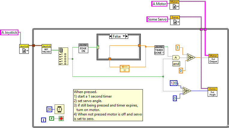

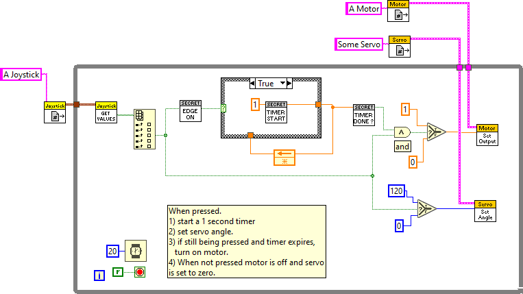

The last reply looks like a really good example. In case you wanted another way to do the same thing, I put another sample below. This one doesn’t block using waits. Instead it starts a timer and checks for completion to start the delayed action. (Instruction on how to make the timers and edge detection are in the book referenced above.)
The False case looks like this.
Operationally the examples do the same thing. The biggest difference is that this one doesn’t block. So it writes a value to the motors every 20 milliseconds.

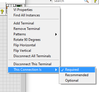

  5. For inputs, right click on the input terminals and select “This connection → is required” This will cause an error if you use this subVI and forget to wire an input. This will save you a lot of time debugging!!!.

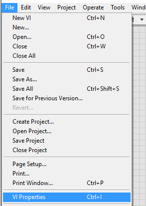

  9. Set the execution parameters. On the menu, select FILE, then select VI PROPERTIES.
Select the EXECUTION category and change the settings to look like this.

For this to work, would I have to disable the elevator motors in teleop? Or remove them from teleop entirely? I tried this example in the code, but it seems like the loop doesn’t activate at all (As in, the elevator works when the button is pressed but there’s no delay and the servo doesn’t activate)
As for @JSIMPSO , that looks very interesting! I’ll definitely give it a try
You can’t command the elevator in two different places.
Both Teleop and Periodic Tasks are running at the same time, so the elevator would get conflicting orders and whatever Teleop is doing would win.
I removed the elevator stuff in teleop and it worked like a charm! Thanks!
A side note: I usually program limit switches in teleop, but since I can’t use teleop for these elevators, is there a way to do limit switches where it doesn’t interfere with periodic tasks? (EX: When DIO 1 is activated, cancel the elevator loop)
You can put everything in Periodic Tasks.
Treat it just like Teleop, but with the code in forever loops.
You’d want to check the elevator limit switches during the automatic jobs, too.

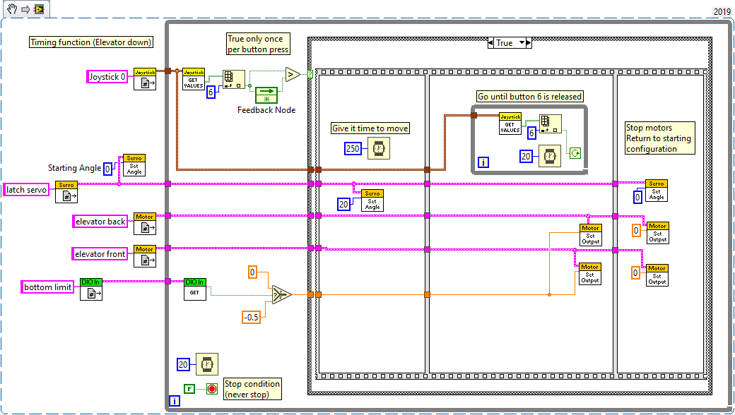

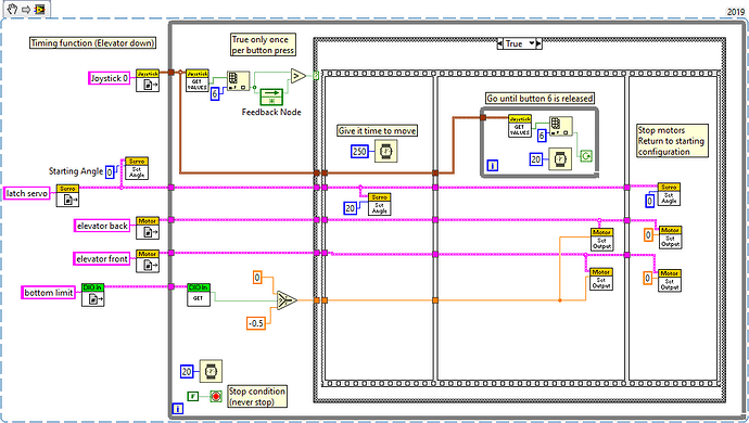

So would that be like this?
Almost.
That only checks the elevator limits before it starts, not while it is going.
I’d probably move the limit Get and both the motor Set Outputs into that little loop in the second frame.
Then it checks every 20ms and stops the motors as long as button 6 is held down.

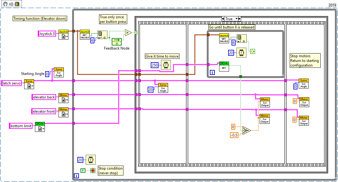

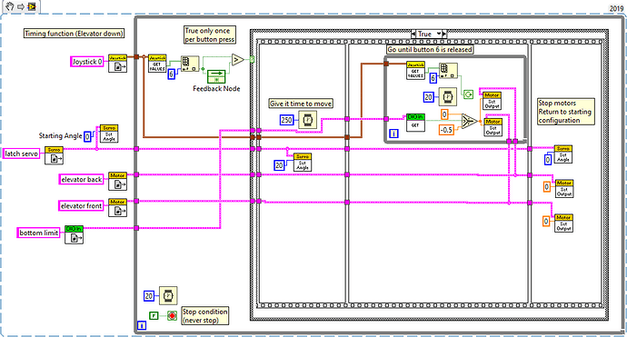

Is this right?
Almost.
The motor set outputs need to be inside that little loop also, so they can be turned off when the DIO says so.
So everything you now have in the second frame needs to be inside that loop.
I tried this, but the elevator motors don’t activate, only the servo (not sure if I connected them right)
For the sake of clarity, these limit switches have to be in periodic tasks, right? (I’m really sorry for dragging this on for so long, maybe I should make a new topic for it at this point…)
I’m away from my computer right now, so I can’t test your code.
I suggest running this through highlight execution or probing the wire values to see if the limit switch is set for the correct direction.
The way you have it assumes the limit switch is wired Normally Closed.
There are two ways the switch can work :slight_smile:
  1. Normally Open (returns true when not depressed)
  2. Normally Closed (returns false when NOT depressed)
See if the limit switch value is what you think it should be.
You can add a DIO Get just in the main loop for you to watch the limit switch value without having to trigger the whole sequence.
