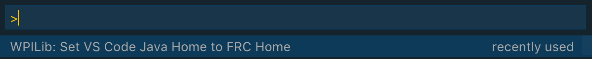

I was following the ScreenSteps guide for installing VS code when I ran into a discrepancy.
My VS code:
Running the command results in this error:
Any ideas on what is going on? I could not find any references to setting the value manually.

We’ve been noticing that on some systems that error happens. The manual solution is to go into your vscode settings, and set java.home
to youruserfolder/frc2019/jdk
. We’re looking into if anything changed in the java extension recently for why this is happening.

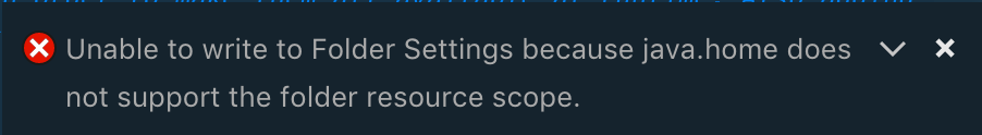

I removed the Java Pack extension and the java home path from the json file, reloaded - same error when attempting a robot build. I do get Unable to Write Folder Settings because java.home is not a registered configuration when attempting to set the java home to frc home

The $ sign will definitely mess up the folder traversal. Have you verified where the jdk directory actually is?
Open a terminal, type cd and press Enter.
Then type this command:
find /Users/PaulC -type d -name jdk
(This assumes that your username is PaulC) . If you’re unsure of your username, open the System Preferences, and look at the Users and Groups applet.
The output of that command will give you an absolute path to your JDK directory. Copy that path, and insert that into the settings.json file for your java.home setting.
I installed the new WPI software and was able to run the ‘Set Java.home to FRC Home’ command!
