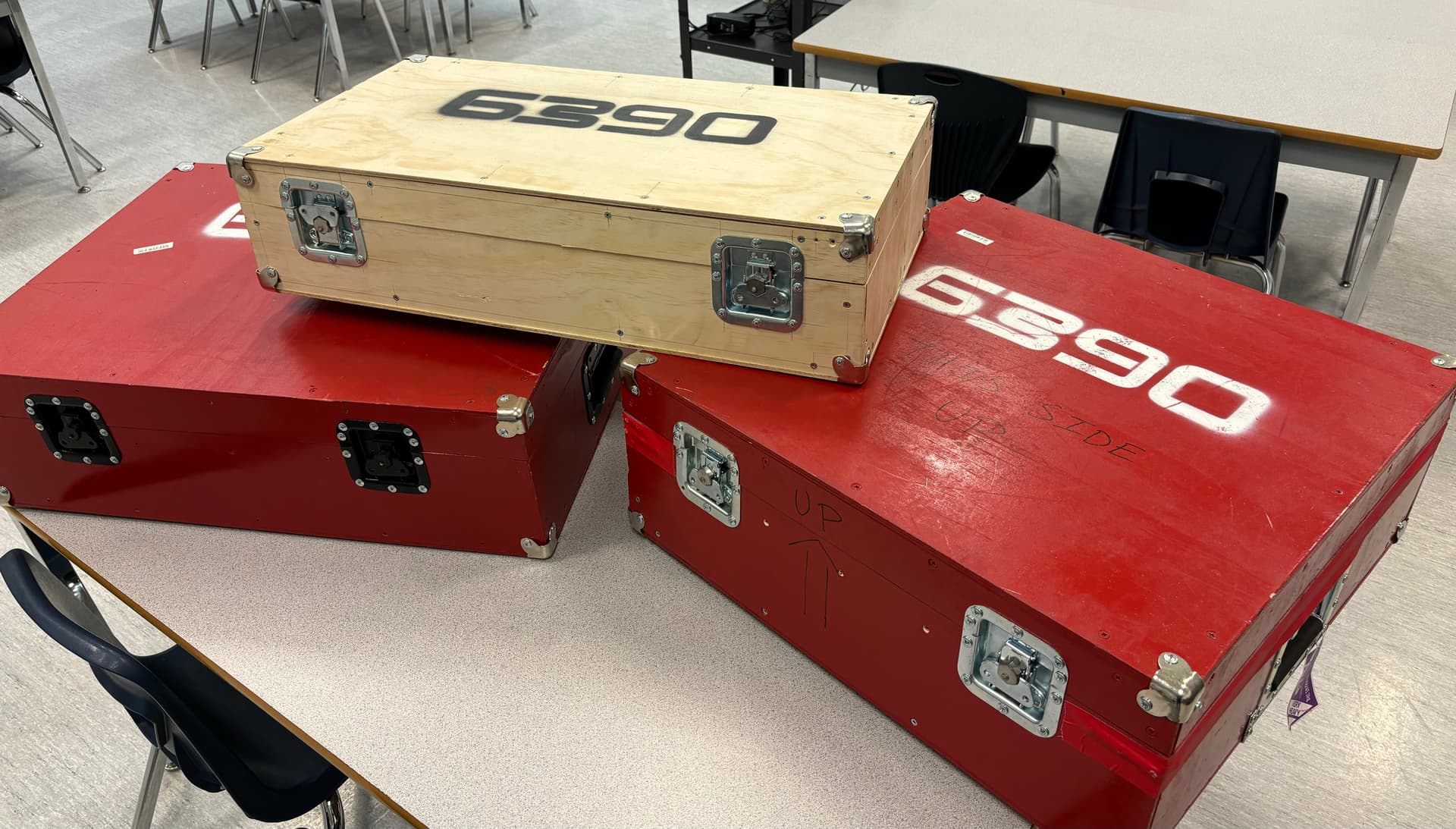

Last year we did the opposite of you guys and travelled down to California for the Silicon Valley Regional. We opted to build our own cases, broke the robot down into sections and brought them on the plane as checked baggage. It took some careful planning when designing and building the robot as we knew it was going to come apart for transportation. However, our modular design worked out well and it was easy to travel with. We were able to have the robot back together in the hotel room without too much difficulty.
Make sure to check your airline’s maximum size and weight restrictions. Our cases managed to meet the criteria which save a ton on cost. Overall we brought three cases, two duffle bags loaded with bumpers, two crates and a cart. A team member took one thing each and it saved us from having excess baggage. Don’t forget to drop an AirTag in each case for piece of mind.
