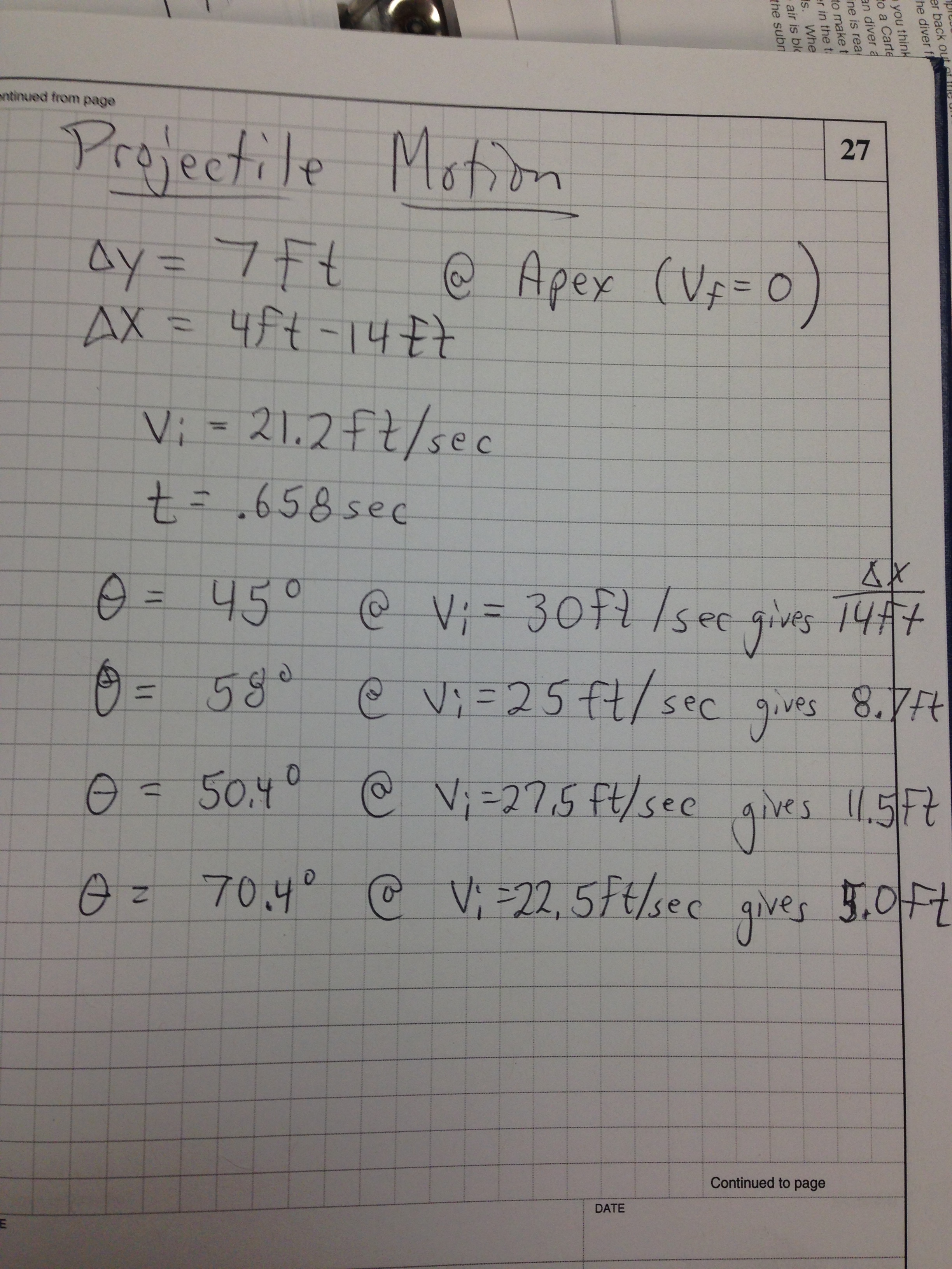

Hello. First of all, I’m going to preface this with a few details about my situation. My team has never successfully integrated vision tracking or sensor data. This is our fifth year, my second. I am the only programmer/control systems person. We use labview. Unfortunately we do not have a programming or electronics mentor.
Those things aside, I am determined to put together a shooter that through angle actuation and rpm modulation is able to send a ball through the high goal from any distance with a final y velocity of 0.
I’d like a final y velocity of 0 so that the ball enters the goal flying straight, and therefore does not shorten the goal surface area (or lack of surface area).
So after a long conversation with one of our mentors, he and I determined that the code should accept an input distance from the vision tracking (not sure if this needs to be distance to goal or to base of goal), and give an rpm and an angle as an output to the shooter.
I figure that the best way to do this would be to use a calculator of some kind to find the values of rpm and angle required for every possible distance (up to a reasonable maximum) and feed those values to a table. Then the code could reference the table rather then have a calculator running constantly, eating up processing power.
I have several problems. Firstly, I don’t know how to create a calculator to do this. I’ve looked at Ether’s calculator (beautiful by the way), which outputs two distances (not necessarily with y velocities of 0) which you can fire from at an input speed and an input angle. Perhaps I can edit this calculator to input distance, and output rpm and angle. I don’t know how to do that…
I also don’t know how to create a table that labview can use, or utilize any sort of table in labview.

You are given one variable, distance, and want to find 2 output variables, power (wheel speed) and angle. So, you really have two problems you want to solve. At distance d: what angle does the shooter need to be at? What power does it need to be at?
You can solve this problem via regression. Get a bunch of data points, and fit a function to it in excel or a similar program. Then, put the regressed equations into your program. In the end, you would have 2 equations, one that solves for angle and another that solves for wheel speed.
It isn’t a table, but it does the same thing and is easy to program a basic math function.

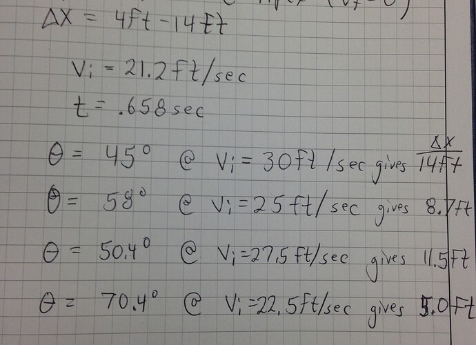

No. You are given two values: the horizontal distance to, and vertical height of, the apex relative to the launch point.
From that information, you can directly compute the parabolic (no air drag) launch angle and speed.
It’s all explained here.
For coordinate system XY whose origin is at the launch point,
the equation for the parabola is:
y = ax^2 + bx
Let the (known) apex coordinates in XY be [xp,yp]
then
a = -yp/xp^2
b = 2*yp/xp
So now you know the equation of the parabolic trajectory,
and from that you can find the launch angle theta and launch speed V:
theta = atan(b);
V = sqrt((g/2)/a)/cos(theta);

It’s not clear to me what you’re having trouble solving.
In my earlier post I gave the formula for finding launch angle and launch speed, given the coordinates of the apex of the parabola (the horizontal and vertical distances xp & yp from the launch point to the center of the goal).
This assumes there is no air drag, so it may be quite inaccurate.
If you want to include air drag, you’ll have to measure (or calculate) the relevant drag coefficients… or measure the terminal velocity of the ball.
And when you include air drag, I don’t think there’s a closed-form solution. You’d have to use numerical methods and iteration. Not hard to do, just not as straightforward as an explicit solution.

We actually had a bit of a breakthrough today. One of our teachers figured out that if the apex is at the same height (the height of the goal remains constant of course), the y-velocity and time to the apex must be the same. If the y-velocity is the same, then we can enter it along with our other variables, and calculate the combined velocity, angle, and distance. Now we have a corresponding velocity and angle for each distance. We haven’t factored in drag, and I’m not sure we will, since these values were just some estimates to get us ready for the experimental value.
But we’re happy it’s done. Thank you all for your help!
