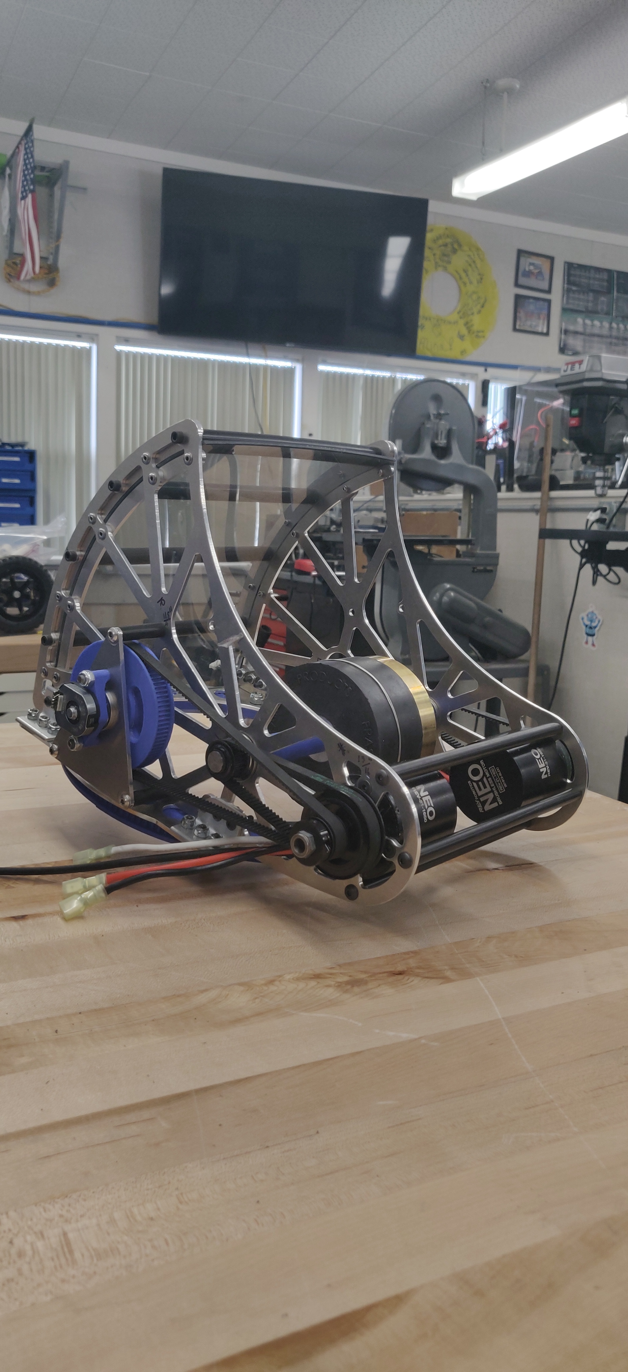

3512 used an AMT103V (one of the ones @ClayTownRo suggested) for our 2020 shooter geared down 4:1:
We were really happy with it’s performance as a shooter encoder and will probably use it again for our 2022 shooter.

That’s a good-looking shooter, although I’m a bit skeptical with having the motor leads that close to a spinning belt.
They were property routed and secured once installed on the actual robot.
