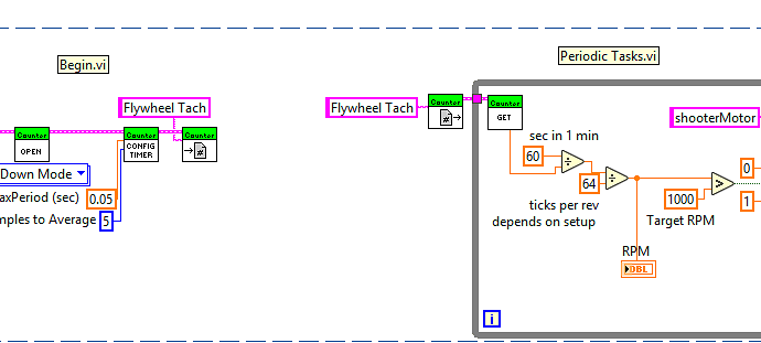

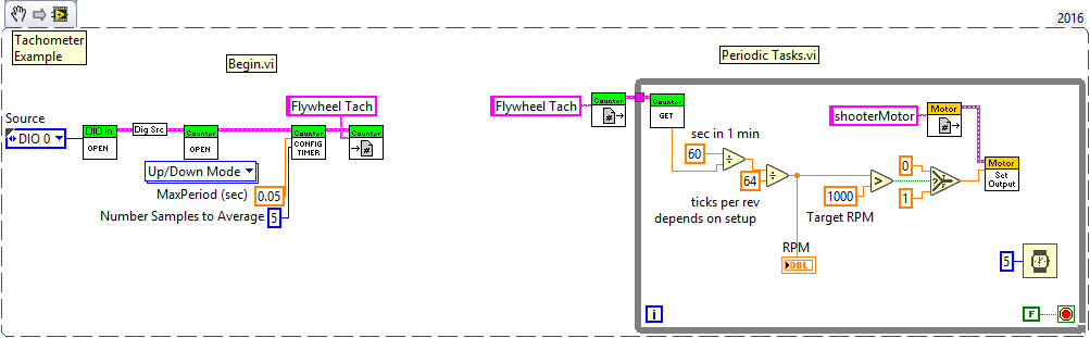

Here’s an example of a simplistic bang-bang shooter using just one channel of the encoder you already have.
It can give you an idea of how it works before filtering.
Average RPM will be a bit higher than your target RPM depending on the mass of your shooting wheel (heavier wheel=better performance), but most people are picking target RPMs arbitrarily anyway-as long as the value remains consistent.
This can add PID in place of the 0 or 1 to give smoother performance at the cost of a slower return to the target RPM.
The Wait time delay is what I was talking about throttling loops so they don’t suck up all roboRIO CPU resources.

Just comment out the Encoder and use the same DIO input as one of the Encoder channels A or B. You can’t Open two things on the same DIO input.
A counter just counts encoder ticks from one channel. It doesn’t care about the direction you get from comparing Encoder A & B channels.
You can configure your encoder as a counter.
If you enter Mark’s simple bang-bang example into LabVIEW, you’ll be able to click on the icons you don’t understand (like the counter) and you’ll get pop-up help explaining what they do.
