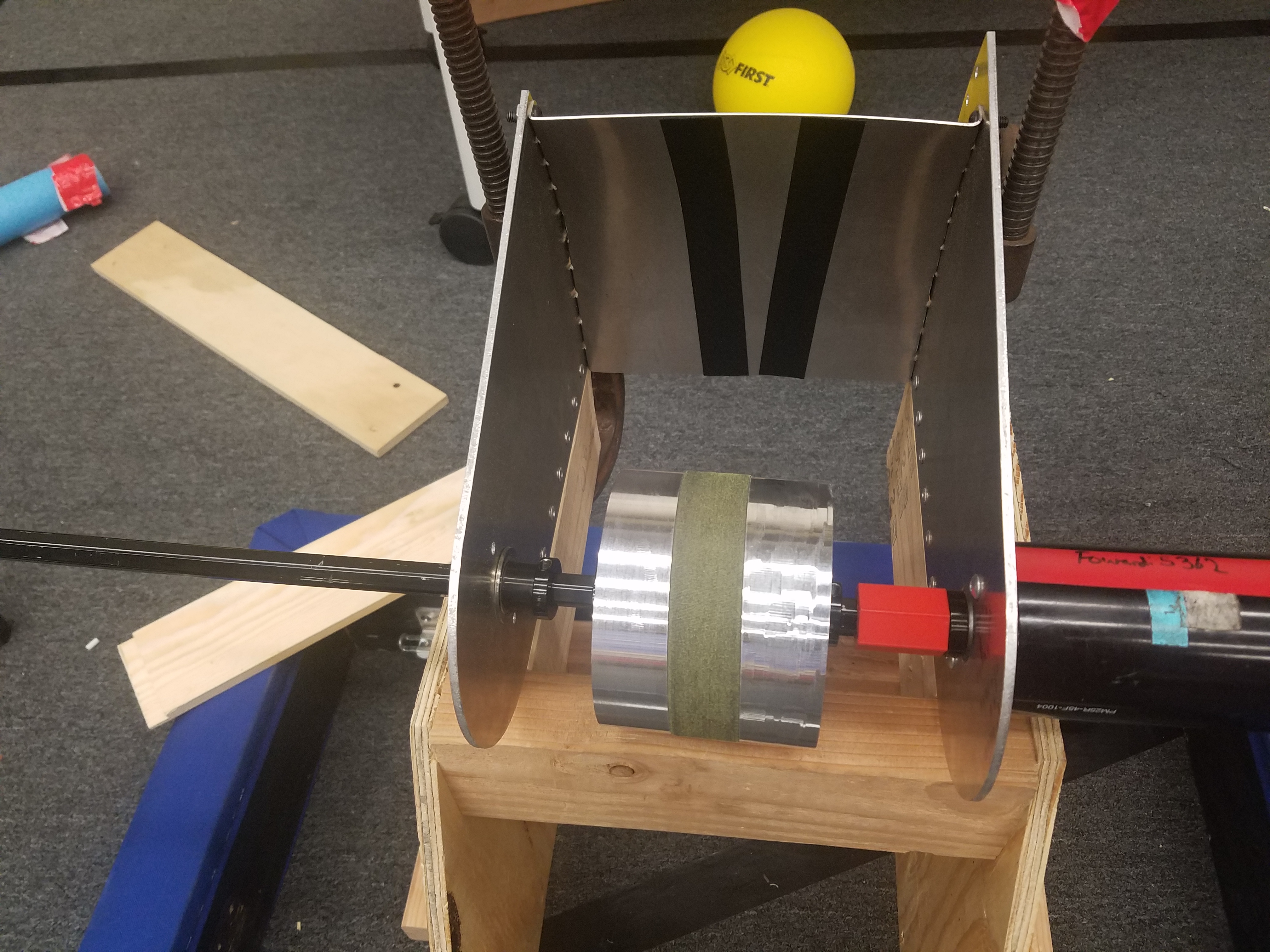

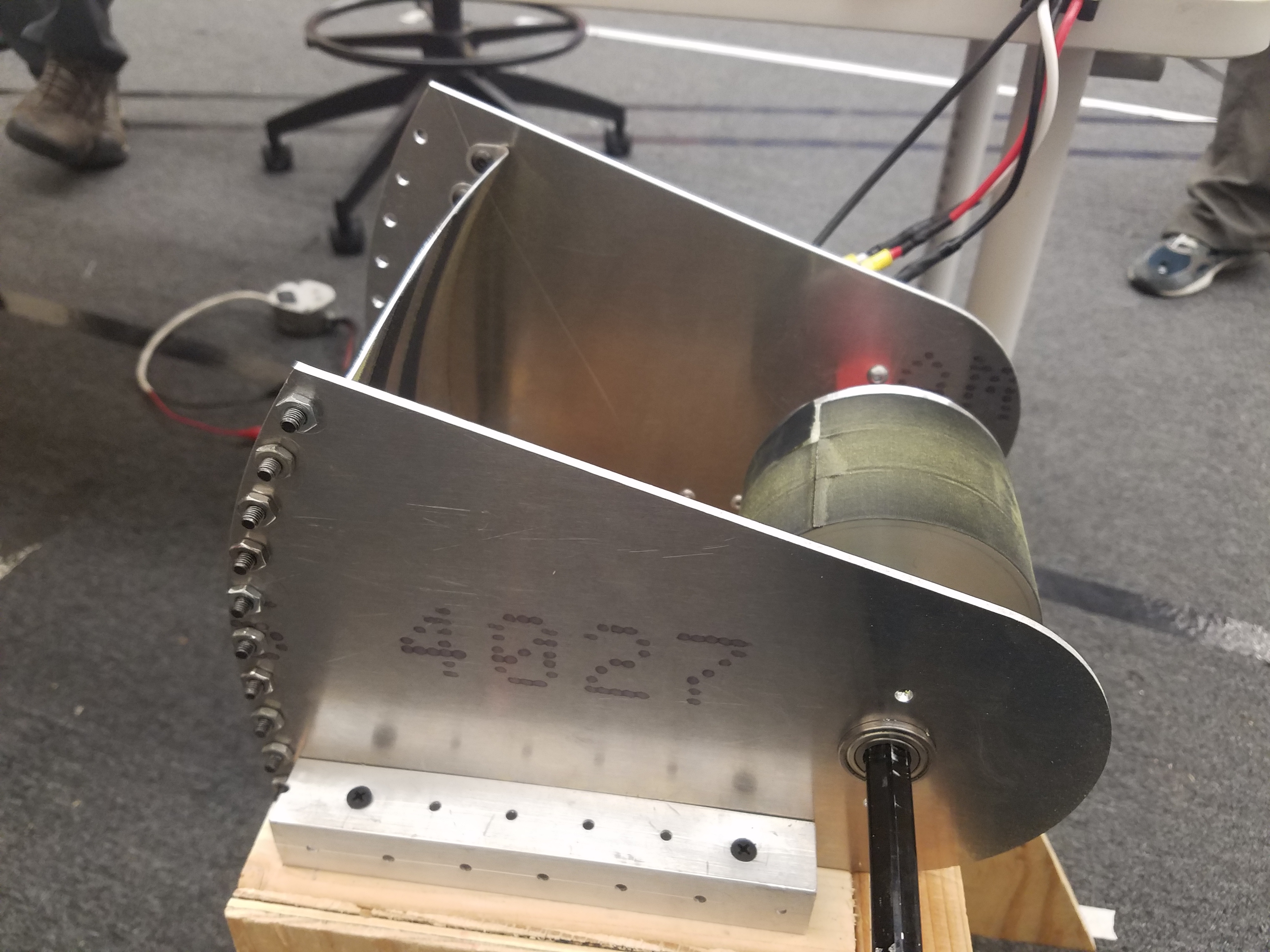

Keeping the inertia up during the shots. We found that an aluminum drum coated in the KoP grip tape worked really well. It fit the soft game piece hard wheel model we liked and keeps the packaging small. 0 expansion keeps the compression consistent.
Not too concerned about the cheeto dust on the wheel as that’s after well over 1000 shots
What motor configuration are you using for that? we leaned away from 4" wheels due to the loss of surface speed being transferred
We have looked at 1 Cim, 1 Mini, and 1 Neo all direct drive. We are going with the Neo now, about 5k rpm gets us shots from a safe spot in the trench when we have a deflector on top (holding a piece of plywood at the top). Without that we can shoot from against the wall in front of the goal. Still not a final rev. RPM loss per shot is I think ~200 but recovers fast enough for 2-3/sec with some SW
