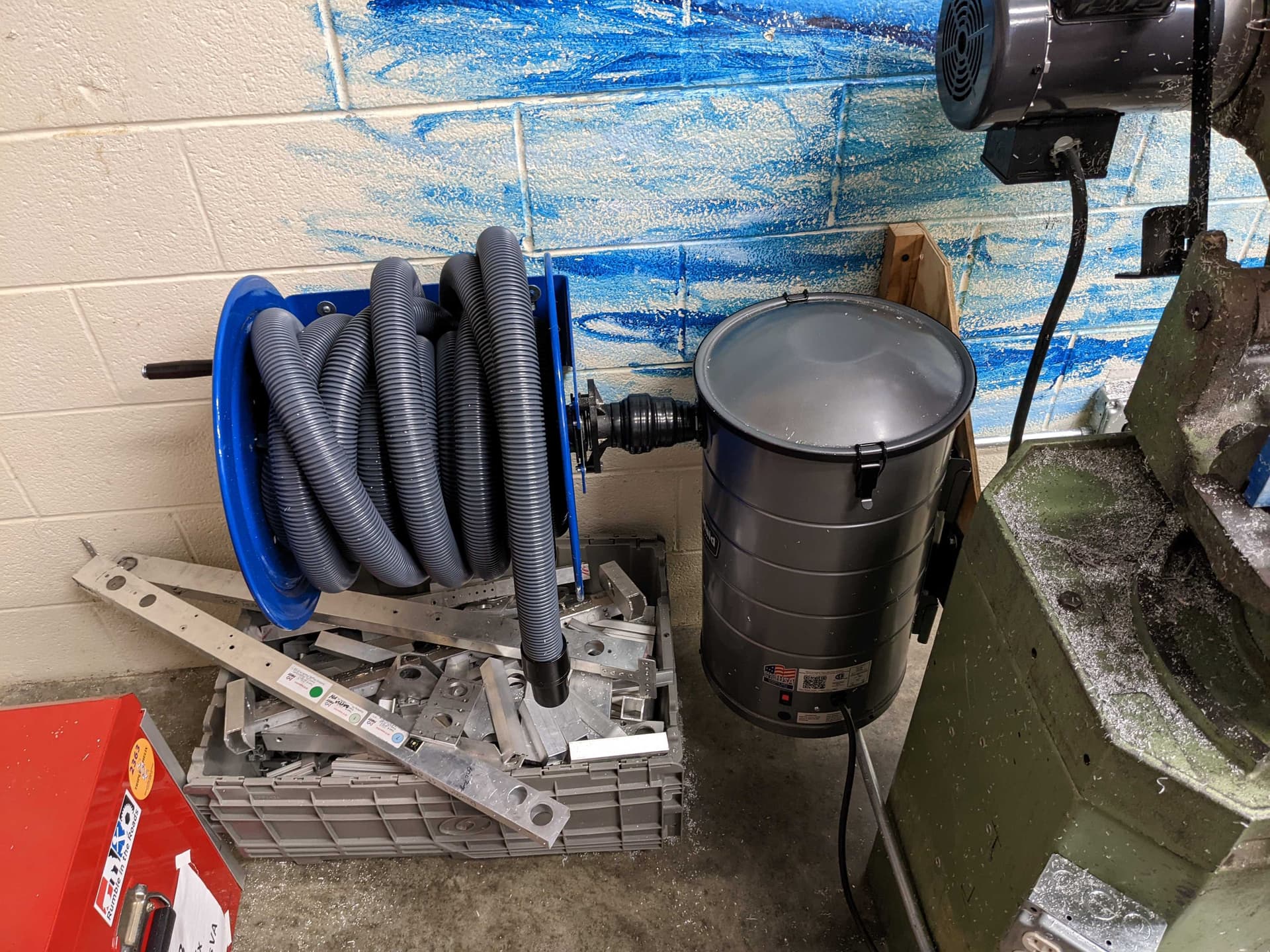

We were also on the broom + shopvac system until fall 2021. The shopvac usually sat on the floor, at the back of the shop, covered in metal shavings.
We set up a wall-mounted vacuum and hose reel. The hose is long enough to reach the other side of the shop. Also wired up the vacuum to a nearby switch.
Vacuum
https://vacumaid.com/product/garage-vac/
Hose reel
Cox Reels V-117H-835
https://www.coxreels.com/v100-series_8_126.html
