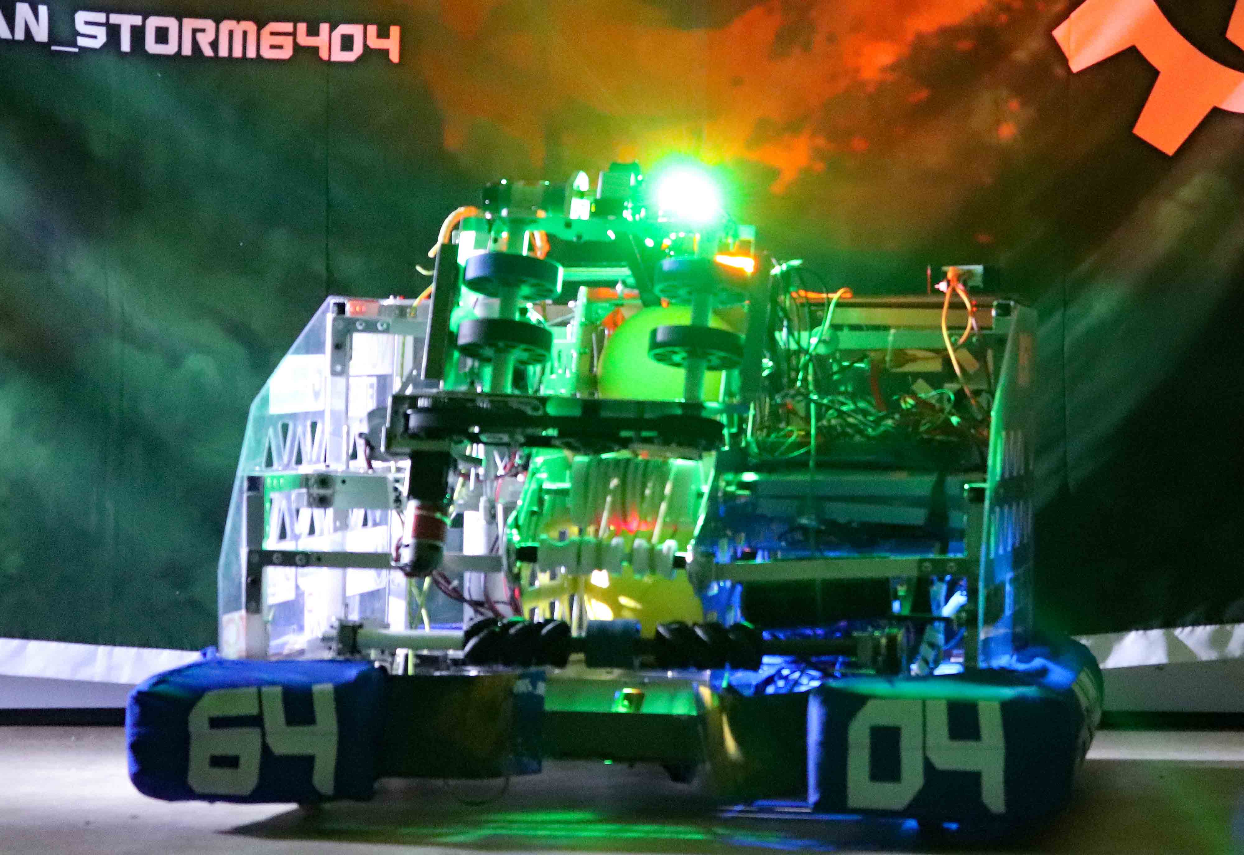

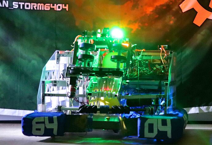

The strongest points of our previous robots were their agility and speed, so we went for a low, light (<90lbs) robot, with the option to go under the control pannel, and as we went with a doble roller shooter, because we had done one in the off season, it would be harder to integrate it with a taller robot
You saw that up and close :grin:
