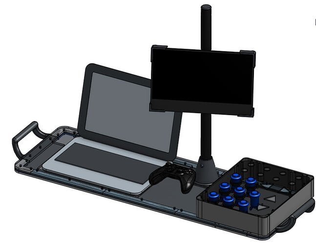

We were pretty happy with our new driver station this year. Unfortunately, I don’t have any real-life pictures of it but it’s pretty close to the CAD.
We’ll be making several changes this offseason to the setup based on what we learned using it.
  • Biggest change will be to increase the gap between the upper and lower main plates by about 2" to address two issues. First, it’s a bit flexy right now. Second, we want space to contain all the wires.
  • Design a controller holder that will mount the monitor post.
  • Add a second monitor to the post.
Here is the CAD if anyone is interested.

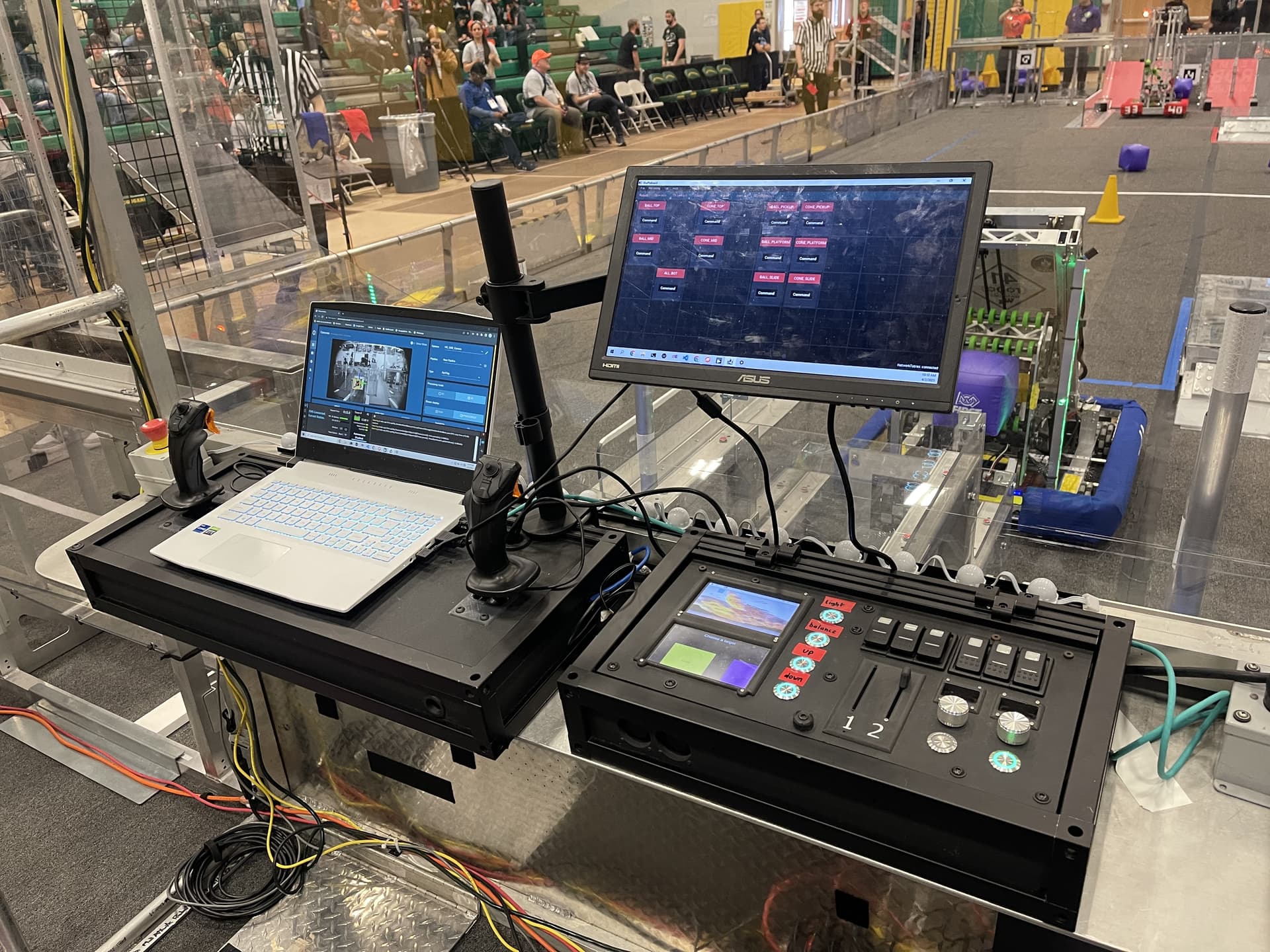

Definitely not something to make your first upgrade too, but here’s ours. (also not the best pictures)
What are the little screens mounted in the console?

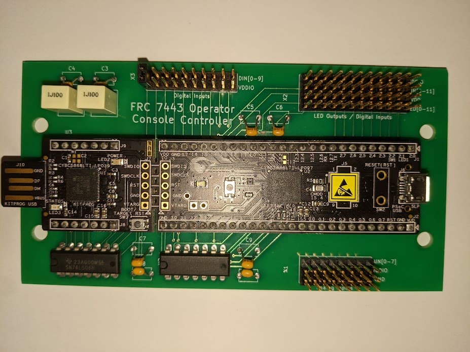

How do teams incorporate external buttons/sliders in code?
You can make a controller with an Arduino or similar. Then the code just reads it as a generic controller.
Usually using a breakout board that enumerates as a usb joystick- you can make this yourself using a microcontroller board (raspberry pi pico is my current favorite for this) with your own firmware, or there are COTS products that do this as well.
Has anyone built a 'Waldo?’ seems like with all the ‘pink arms’ that would be a good way to control one.
There are different options. One is to come in via USB, as a HID device that will be handled by the driver station and then the I/O becomes available through several GenericHID APIs. The other is to use network tables (or something custom) and to bypass the driver station – this is especially likely for information coming from the robot to be displayed on an operator console.
FIRST has offered little boards for this for some time. Back in 2014, there used to be more support in the driver station for a specific board, see here (this was the “Cypress FirstTouch I/O board” or PSoC). We still had one of these around, here’s a picture of a custom PCB that organizes the 8 analog inputs, 20 digital inputs, and 12 digital outputs:

They are small touchscreen displays powered by Raspberry Pi zeros from adafruit. Something like this HDMI 7 800x480 Display Backpack - With Touchscreen : ID 2407 : $89.95 : Adafruit Industries, Unique & fun DIY electronics and kits
Our system uses a custom PCB back plane which connects all the buttons and switches to an Arduino DUE and Leonardo (essentially just removes a bunch of wires and soldering) The DUE and Leonardo take all the analog button and potentiometer inputs and masks itself as a HID device (pretty much a joystick) and then they can be mapped like any other button in robot code/driver station. The touchscreen PI displays run a python script that creates buttons as well, and those are also then masked as normal joystick devices. I’m not the code guy, but you can take a look here. GitHub - Team41Robotics/Driver-Station-2020: The code for the 2019-2020 driver station for team 41 robotics

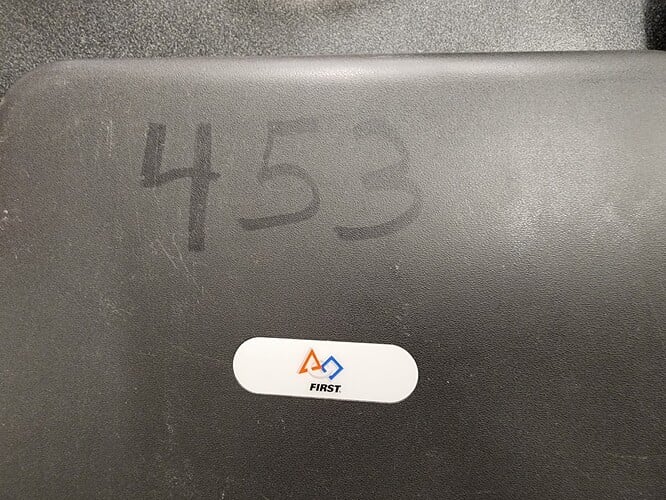

Just found these again tonight, haven’t been used since 2014 but for awhile we ran one of these bad boys and just some flight sticks. Still use the flight sticks but dropped the “official” drive station laptops in 2015
