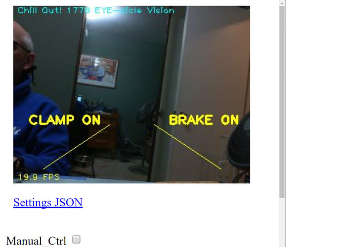

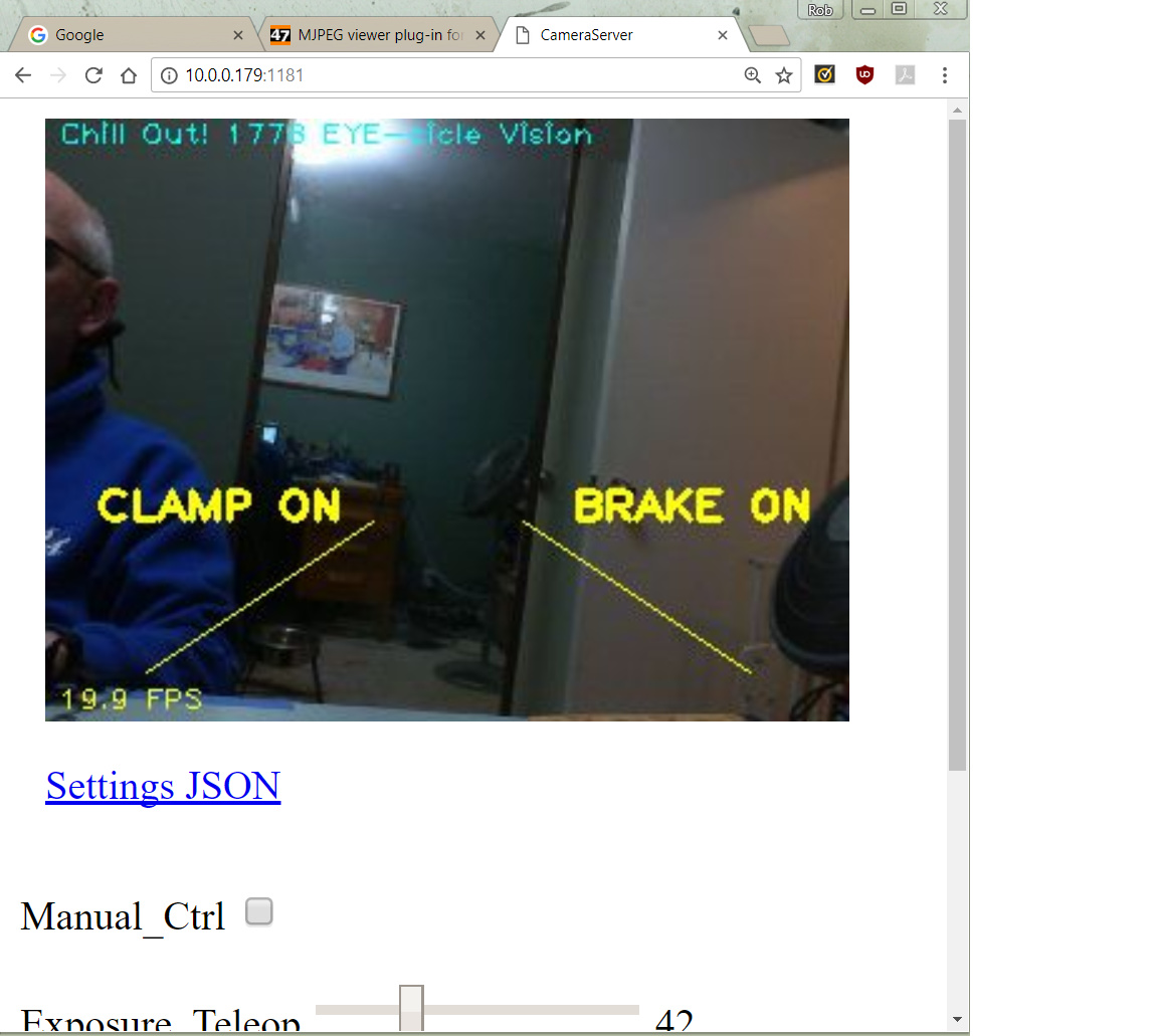

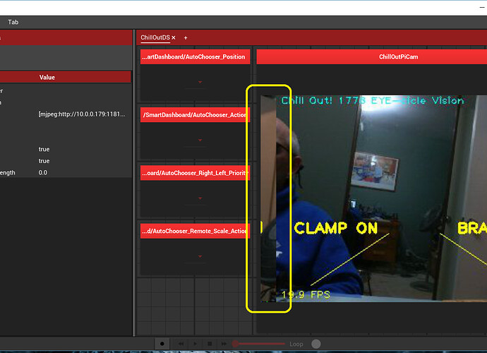

Chill Out 1778 is using a Raspberry Pi USB camera server for our robot this year. We are using cscore to stream our image data. We can see the image great just opening a browser to the raspberry pi IP address and port. When we set up a server window in Shuffleboard (to integrate this video with auto chooser stuff), it works, but the MJPEG image is wrapping. I have included normal (web browser) image and the Shuffleboard server image below.
Ideas?
Rob
Make sure you have the newest version of shuffleboard
Yes, version 2.2 of Eclipse plugins fixed this issue. Thanks for the tip.
