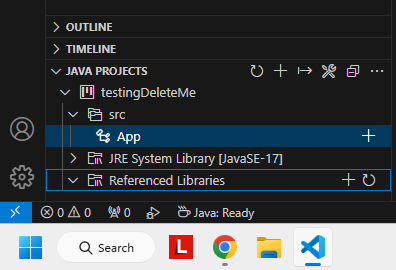

You didn’t say how you created your project. An easy way to add libraries in VSCode is to hit the plus sign in the Referenced Libraries area. That adds to the settings.json file.

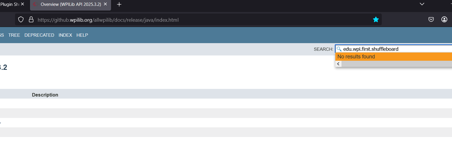

I searched the API docs for the classes referenced in the example code, namely edu.wpi.first.shuffleboard.api.* (and the classes/members therein), but as far as the docs are concerned, those don’t seem to exist (see attached). Am I just looking in the wrong place?
Those are the API docs from WPILib. The shuffleboard plugin API is part of shuffleboard. You can get those javadocs here: JFrog
