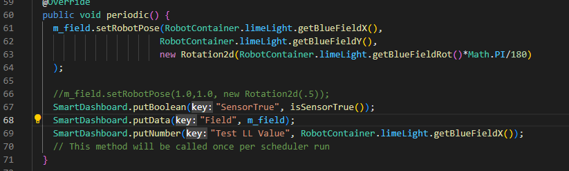

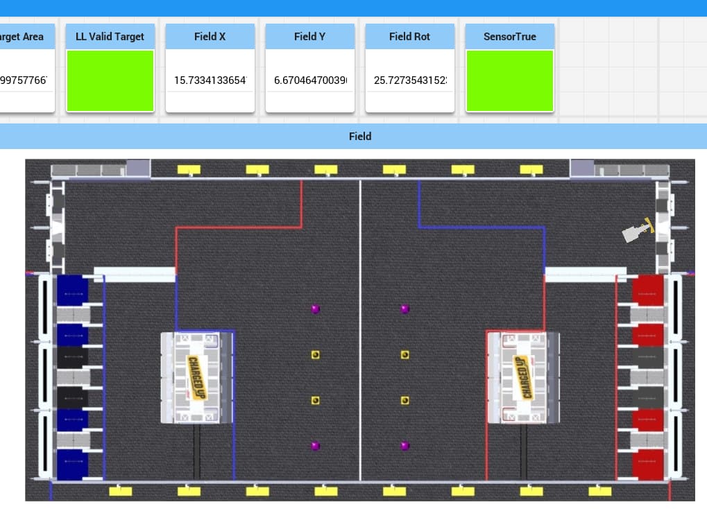

I am trying to learn to do robot pose detection using a limelight. I can get values from the limelight, but would like to visualize the pose on a Field2D widget on the shuffleboard. I can get the robot to show its position, but it does not update live if the camera is moved. It will update if I redeploy the code. If I use Glass the robot position updates live.
I can see that the Field X, Y, and Rot values are changing, but the image of the robot stays stationary when the camera is moved.
Is this a limitation of the Field 2d widget in Shuffleboard, or do I have an error in my code?
Link to code
LHSPantherbots/AprilTagPoseTest (github.com)
I am updating the field2d pose in the periodic function in the exampleSubsystem.java file.
If I remember correctly, I don’t think you have to run
SmartDashboard.putData(“field”, m_field);
periodically. I think you just call this once, then do setRobotPose periodically.

Shuffleboard has an issue that looks something like this: the values update in the side column but not the dashboard visuals. Restart Shuffleboard and try again.
