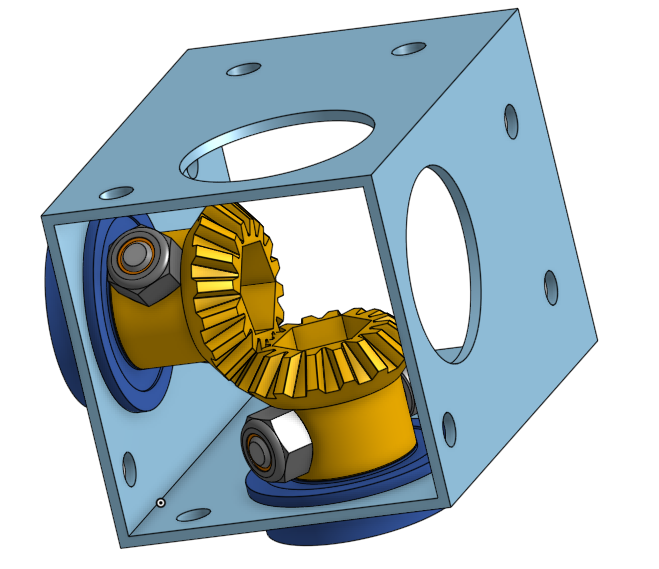

I was the fabrication lead for 930 during the 2019 season so I can give you a bit of our experience with it.
First of all, I’ll give you a little bit more information on how it’s actually constructed. The entire mechanism runs off of a single motor (we used a 775 pro with a 12T to 60T GT2 belt reduction) and transmits the power to each of the rollers using these nylon bevel gears from McMaster Carr they are kind of pricey, and you have to broach them to 1/2" hex (we did it using a tailstock on a lathe). In 2020-2021 I know 930 tried 3D printing them (PETG) instead but they ended up not being strong enough. These bevel gear sets transmit the force to the other shafts perpendicular to them, and we ended up putting these bevel gear sets at every corner for redundancy (so 8 gears in total).
We held these bevel gears in place with some 2" 1/16" wall aluminum square tube with machined bearing holes at the proper mounting distance. This was important to keep the gears aligned even if the rest of the polycarbonate intake was super flexible.
You can see closely in our FUN interview, or you can take a closer look at it in our CAD release from 2019.
Overall this intake held up very well despite being dragged up the rocket ship a few times, and otherwise being run into things, but at IRI after losing all pneumatic pressure and taking a few pretty good hits since it was always out in front of the robot, these gears were not too healthy and we ended up swapping out the entire mechanism before our next match. So the nylon gears take a good amount of abuse–until a point.
I think a big reason you didn’t see a design like this for the past two years, is that at least the style of intake that we used in 2019 really is optimized for grabbing one ball at a time from any direction. In a year that you need to pick up a high volume of balls like 2020-2021–a full-width intake that can grab more than one ball is going to work much better. In Rapid React, I could see either system being possible, but unless you find that vector wheels are not centering the cargo as much as you need, or you think that being able to pivot your robot into the cargo as we did in 2019 will be an important feature, just keep in mind it’s going to be more complex to replicate something along the lines of what we used than just putting vectored intake wheels on the intake axles.
Keep in mind if you make your plate small enough that the cargo can contact it from the side, you may still be able to get something similar with a vectored intake wheel system–but just be careful to make sure that the axle on the end can still take some abuse.
