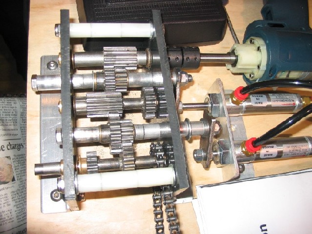

I had a chance to see the drive system designed and built by Team 33 this past weekend at the Richmond regional competition. It is, without a doubt, one of the most elegant designs I have seen in the nine years I have been working with the FIRST program. They have built a dual-motor, four-speed, shift-on-the-fly, AUTOMATIC transmission that is amazing.
It is the ultimate in simplicity - you can build it with a lathe and a drill press with an X-Y table. The gearbox itself is very small and compact - under two pounds. The gearbox and combination of the motors are separate subsystems, so the gearbox can be used with a single-motor (or triple-motor) design without any redesign. The shifting gears are all cut from 12, 14 and 20-tooth, 16-pitch pinion wire - the large tooth profile, small DP-to-diameter ratio, plus 15 mils of designed-in backlash makes on-the-fly shifting trivial.
But the best part is the automatic shifting function. The system detects wheel speed to determine the output of the gearbox. They have calculated the power curves for transmission in each of the four gears, and determined the optimal crossover points for the curves. The control system has been programmed to sense when the system reaches one of the crossover points, and automatically fires one or both of the shifting pistons to bump up or down one gear. All the robot driver has to do is push the throttle, and the system just goes. It auto-shifts all the way up to fourth gear for high-speed runs. Bump into something and need to start pushing harder? No problem - it just senses the drop in speed and auto-shifts back into first gear.
The Killer Bees have set up a great demo board with a prototype of the design all laid out, along with their design specs and performance analysis. They are very open with the design, and indicated that they will be writing up a white paper on it later in the year. If you are going to be at the Detroit or Canadian regionals, make sure you find a way to see this drive transmission in action (and if you end up against them in competition, you will definitely see how effective it is). My only regret is that I didn’t get a chance to get any photos of their gearbox - if anyone has any, please post them!

Enclosed is a picture of their demo board - I did not want to intrude for one of their actual gearbox.

We have made two speed transmissions for the past several years. Each year we try to make them simpler and smaller. I found that with the kind of high/low shift range that I like to have (3:1 or more) that the robot would tend to lurch severely if you downshifted at high speeds. I really want to make a 3 speed with an intermediate gear to help this. It turned out it was easier to build a 4 speed than a 3 speed ( its really two small two-speeds in series). We focused the design around reliablity and ease of construction, the demo unit on display was made entirely by high school students in a few evenings using no special tooling.
Once I had a design with 4 gears I was pretty much forced to automate the shifting in order to keep from overloading the driver. I talked with a few Automatic Transmission experts at DaimlerChrysler on how to do a shift scheduler and viola…a fully automatic electronic robot transmission.
It really is pretty neat, providing a nearly flat power output across a very wide RPM band with a 5:1 total shift span.
I plan on posting the design and engineering here as soon as I get a good set of drawings made up (I’m not a CAD guy, I made the ones in the robot from a napkin sketch).

btw AWESOME transmission…just saw the pic

Is there a picture of the real thing? That would serve us both better than me asking a bunch of questions. Thanks.
Hey, if u have any questions about our trannys or how they were built ask me because I built them!

Raul posted a picture.
