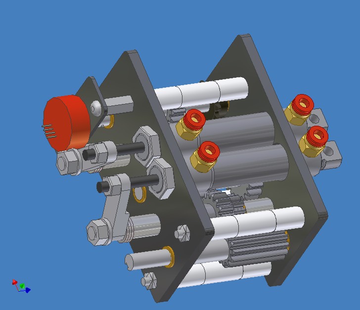

Well, I finally learned Inventor well enough to draw this transmisison up,
I will be posting this with full details in the white papers soon. here is a sneak peak.
I have posted the design for the Killer Bees’ 4 speed transmission on the White Papers board. Because the Inventor Files are so big, I could not post them all here, they are available for Download from the Killer Bees Website at http://www.ndprep.org/robotics/archive.htm.
Jim,
GREAT paper! Thanks for sharing.
I’m sure this will help out quite a few teams in the 2005 season.
I love the way you illustrate the power curve comparison for a 2 speed vs. 4 speed design. This is something I will show our students to help them understand these principles.
Thanks again,
John
If I were drooling any more, I would short out my laptop. Great work!
