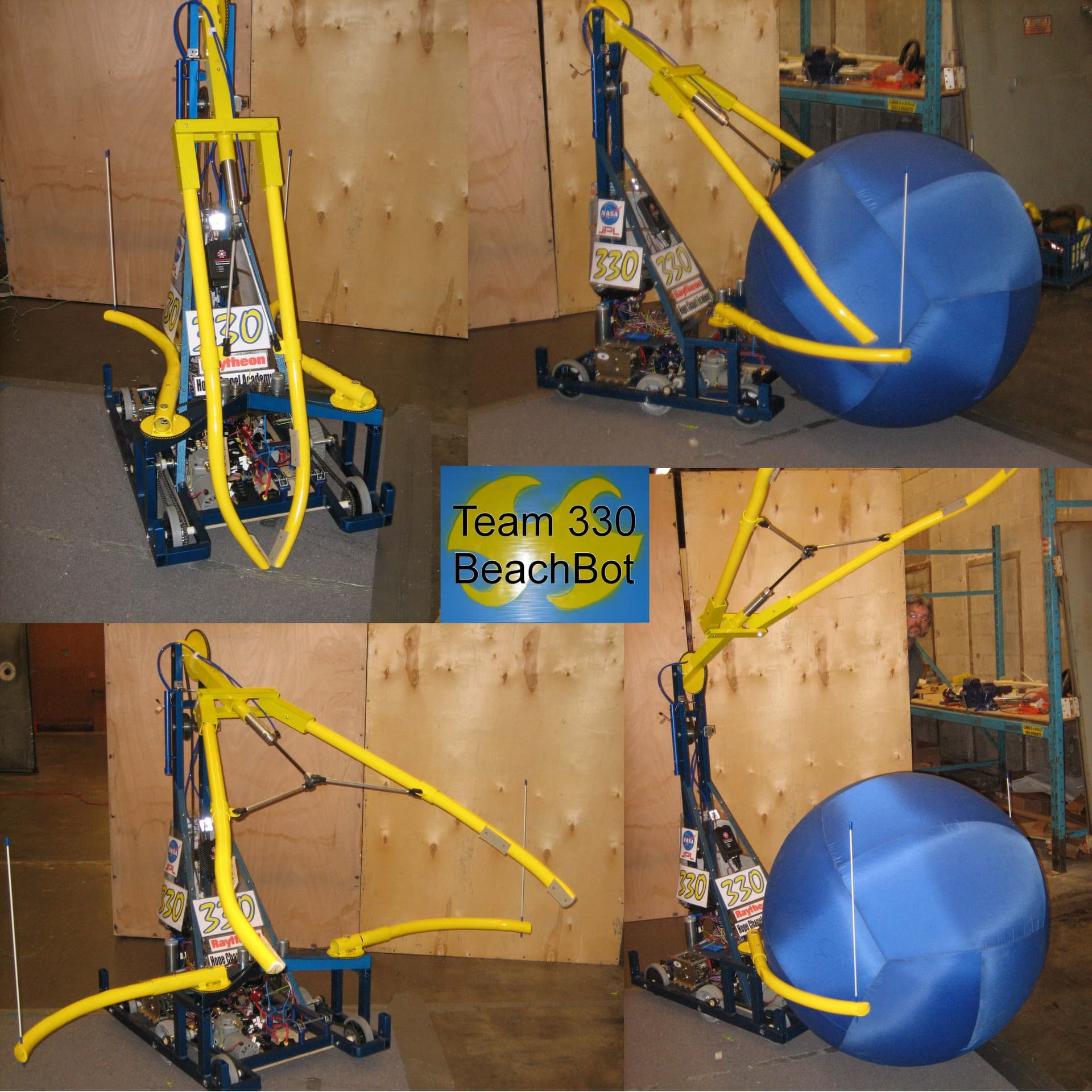

Old school 330 is the go-to example for making big arms.

Alternative is as many people above have said, you can put set screws in a hub (This is nice because you can use more than one which’ll keep the shaft centered), or move away from hex as you get further from the power source. (Ala, 330, who proved to all of us that a single jointed arm is generally always the correct answer.)
