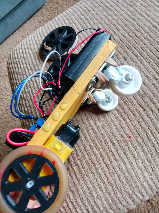

We built pi robots last year (for camp). We didn’t follow any particular kit/curriculum. The nice part was I managed to get each simple robot built for sub-$20 each. Though I’d want to allow for some more sensors, so the cost is probably in the $30-50 range for more capable robots (encoders, line follow, ultrasonic, etc). We used Pi Zero Ws, a L298N, and TT motors. The construction was wood and hot glue.
These are what we made during camp, and while a good start, there are opportunities to make it better mechanically.
As far as raspberry pi goes, it would be good to know if students could SSH into them on Chromebooks. I assume it is possible, but haven’t done it before. For students working at home, that might be the largest hurdle. The controller is another one. We ended up using Android phones, and bluedot app, but not everyone has that.
Curriculum-wise, I don’t know much other than they have some guides: Build a Raspberry Pi robot buggy - Raspberry Pi
Our basic use was to edit our python script in SSH and add it to rc.local so that it started up with the RPi0. Then connect over Bluetooth the the Android phone app to drive it. The python wasn’t too complex, but could be more so.
