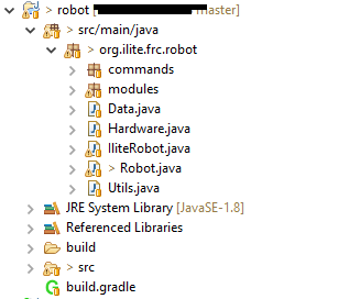

If you want to see a real robot project using this, check out this - I ported my teams code to gradle(RIO) during the offseason (basically for fun; I’m not sure anyone on the team knows about it). It has both 2017 and 2018 beta branches, which you can compare to see how easy it is to update using gradle.
Glad to hear this worked out!
For more complex Gradle setups, checkout my team’s Github for 2017 & 2018 (link in the signature). We’re setting up 2018’s project structure now, and experimenting with a few potential code frameworks.
