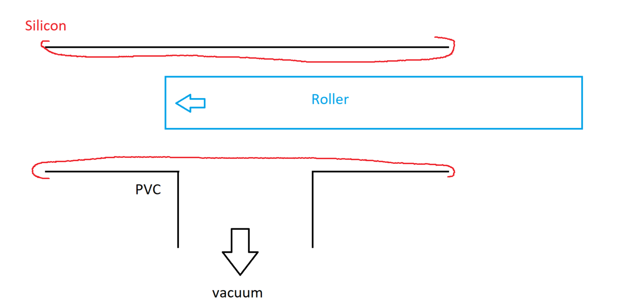

I’ll get a video of it the next time we do it, but we found great success by using some larger PVC tubing in a T shape and a vacuum table we have for investment casting (the metalshop does jewelry making with it). The vacuum pulls the air in a way that stretches the silicon tubing to the inside of the larger tube, we slide our roller tube in, and stop pulling vacuum, and it conforms to the roller. Sometimes we need to stick a welding rod in to let out an air bubble.
Obviously most people don’t have a vacuum table, but I’m pretty sure you could get similar results with a shop vac.
