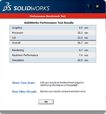

3928’s new CAD/CNC computer is using a Quadro P620 similar to this. It was released in 2018 and uses the Pascal architecture - same architecture as the GeForce 1000 series for gaming. It’s the bottom level professional card. A slightly better card would be the P2200.
Here’s the solidworks benchmark running with the P620. Using the Intel integrated graphics, the same pc had an overall time of 120 seconds.

I got a Quadro P620 as my permanent graphics card for the new PC I build a few months ago. It’s handled everything I’ve needed as far as CAD (Solidworks and Onshape), light video rendering, and web browsing with 3 monitors (can handle up to 4). It probably won’t stand up to professional assemblies with millions of parts, but for student, hobbyist, and FRC purposes it should do just fine. It’s probably not much better than integrated graphics as far as gaming, but it’s not really designed for that. Here are my benchmarks with the PC linked above for comparison:
