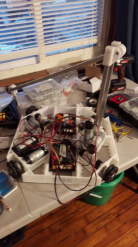

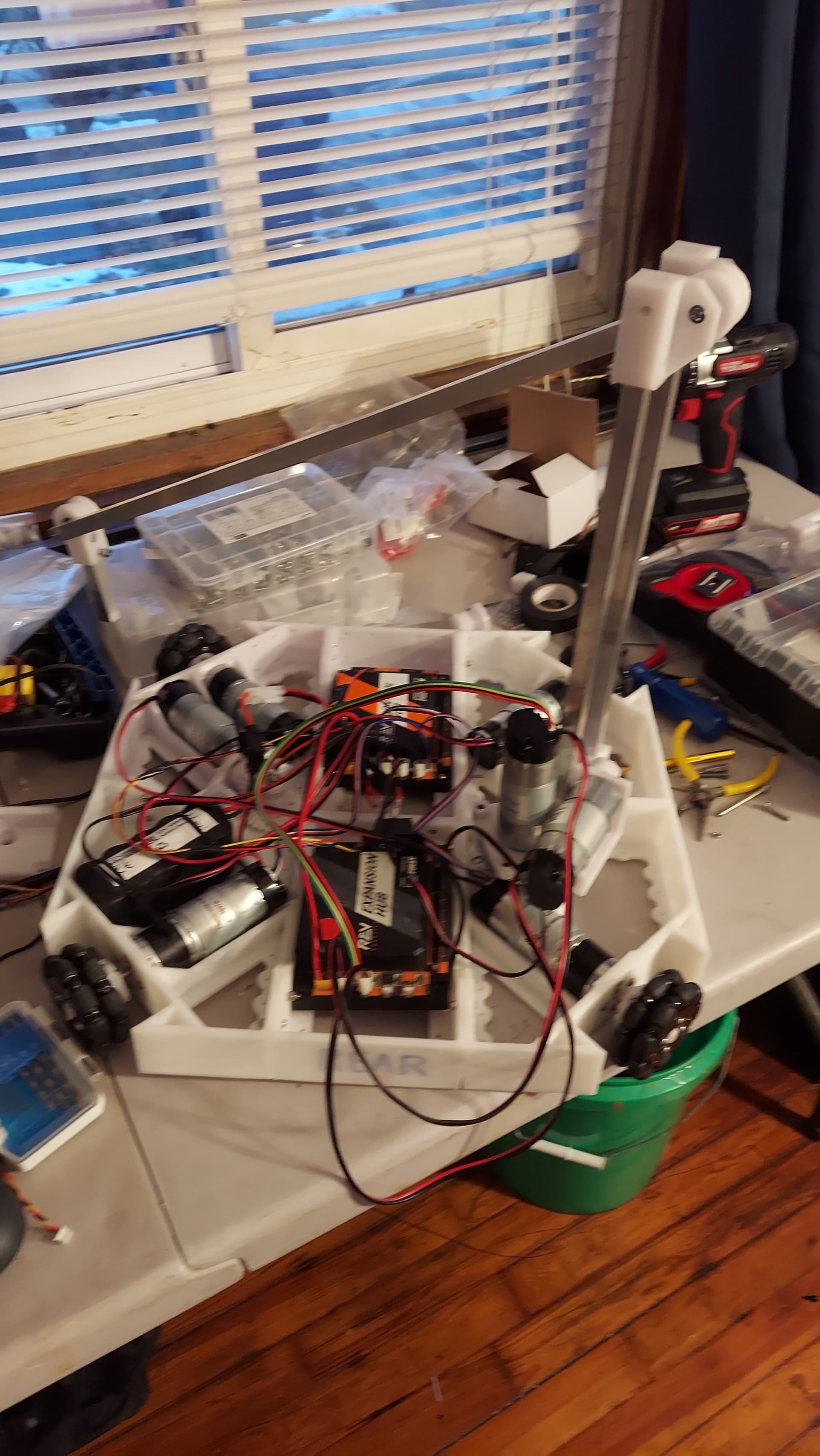

Yes its 3d printed on an Ender 3 in 6 pieces that are bolted together. This is Version 4 I think.
This is a pic of it put together with most of the arm I dont have any pics of the frame without the motors and the electronics on it

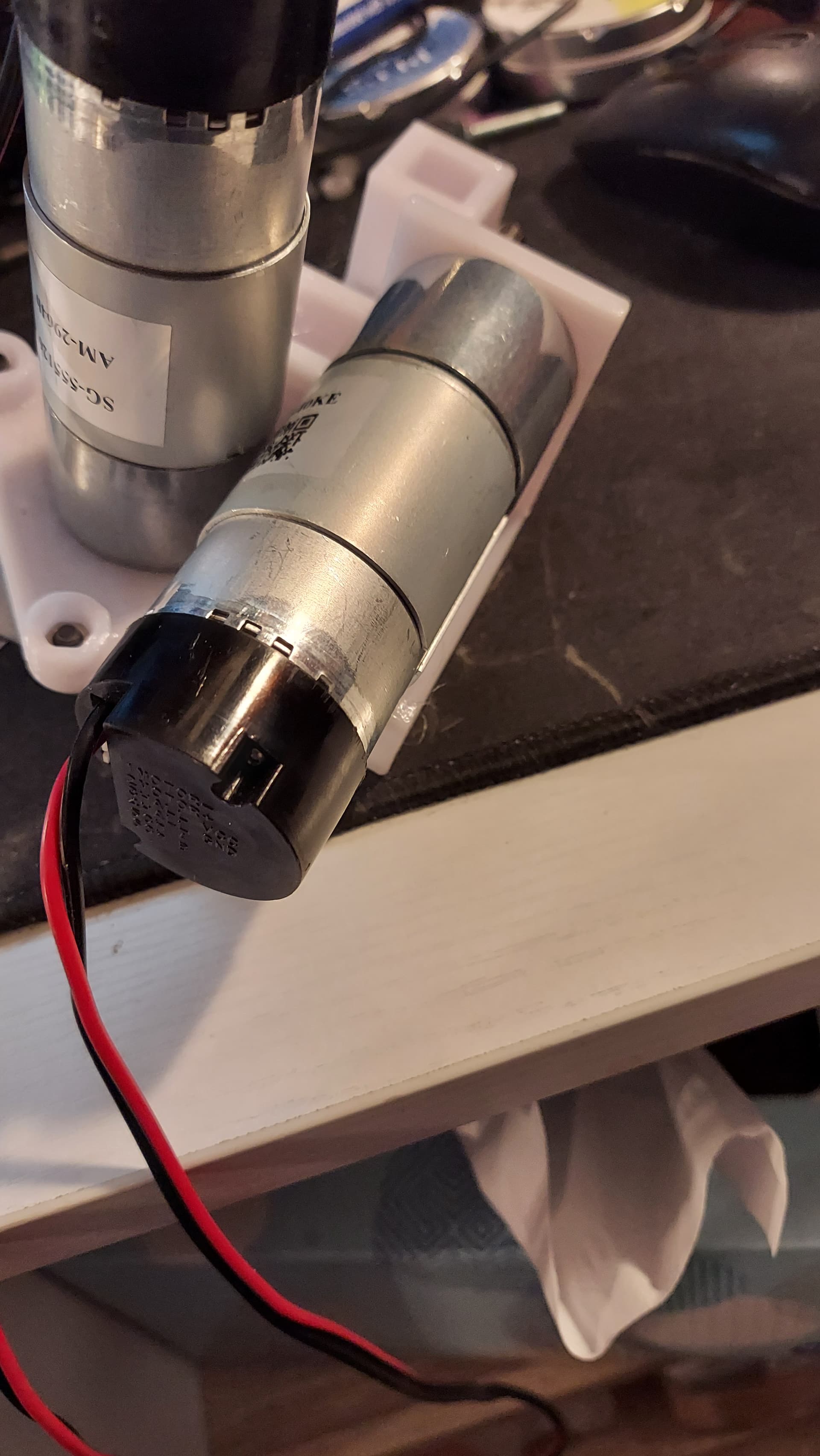

Think is printed from petg about 1.4kg Its thinnest wall is 5mm solid printed with a .5 nozzle .55 outside perimeters .8 to .9mm inner perimeters up to 9 perimeters and .28 layer height. Reason why its printed on and ender 3 as we (the team) wants to print on the printer they have available. I can print it faster on a bigger printer.

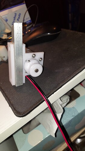

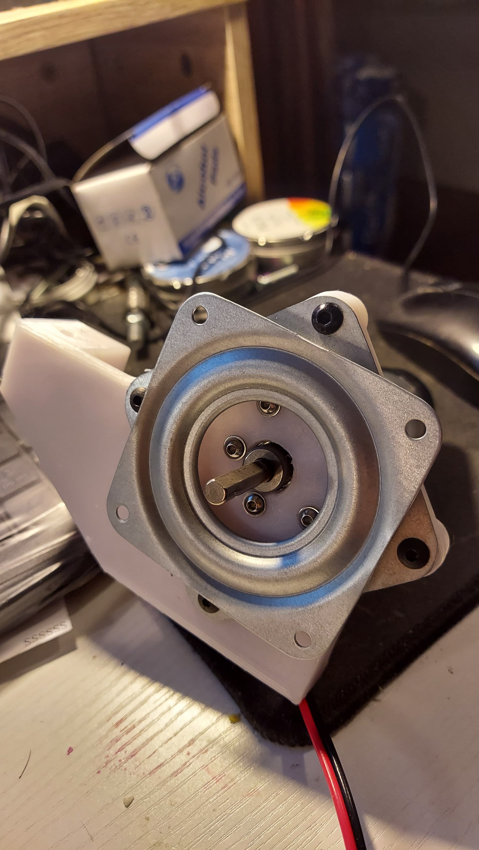

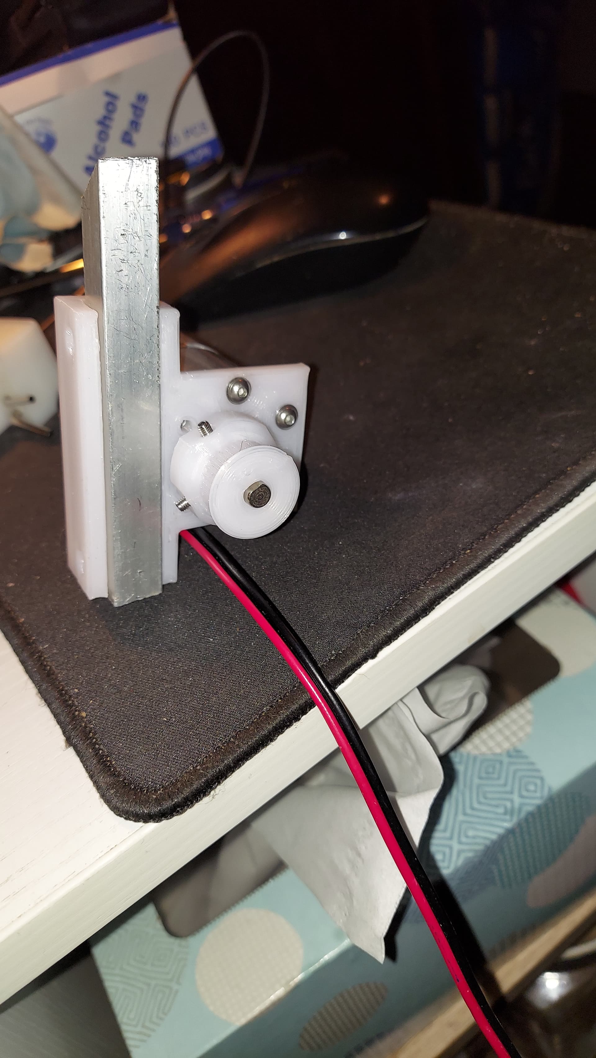

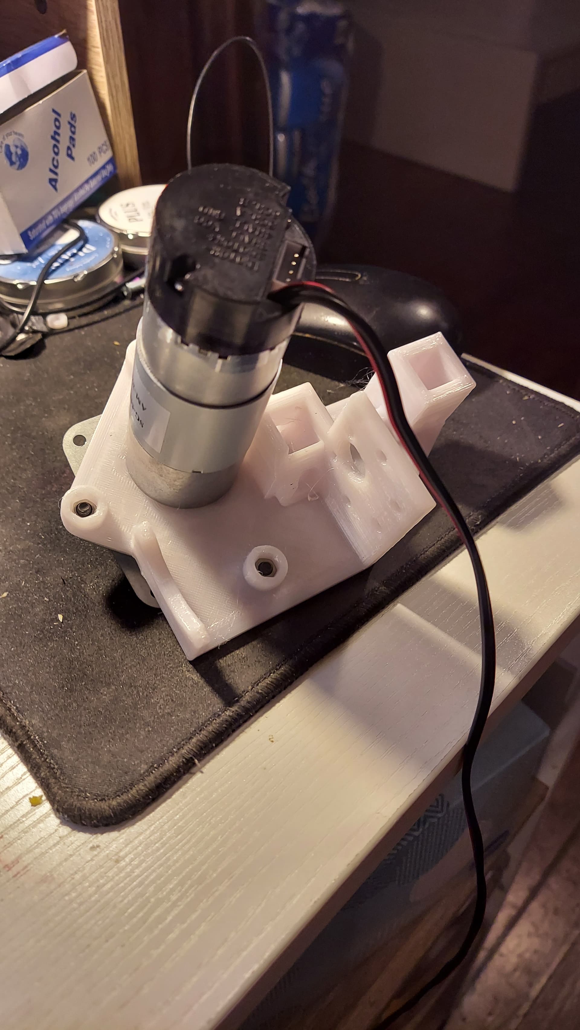

Here are some pics of stuff that goes on it likethe LZ Zusan and some pulleys and stuff

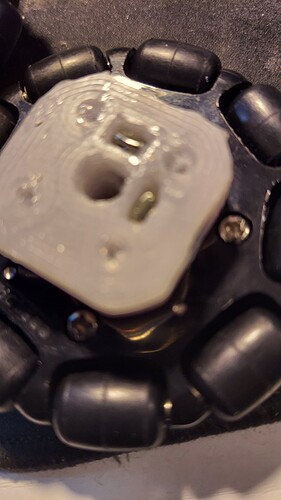

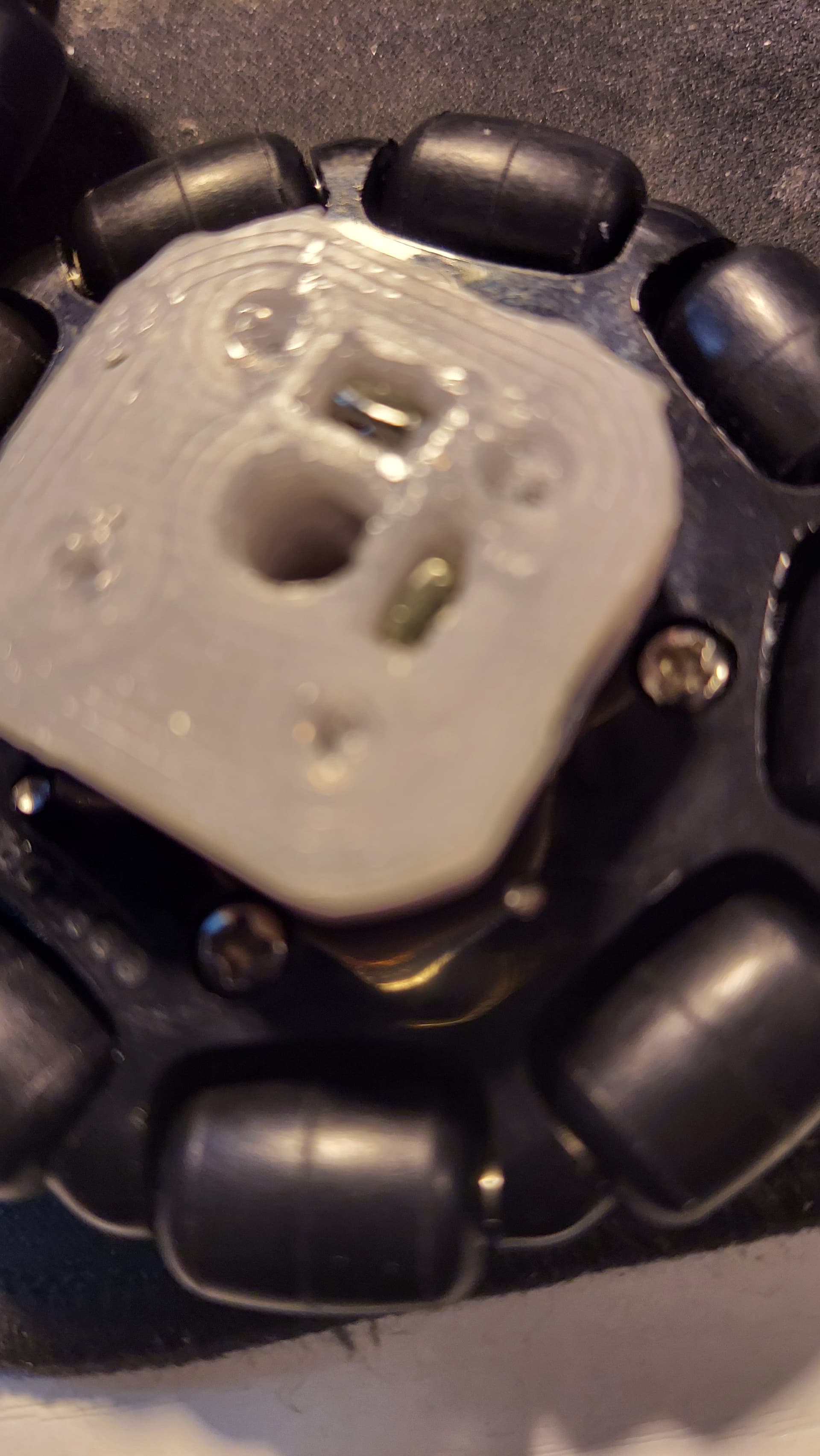

I included the wheel hub to show how we interface with the D Shaft we print square sockets to slide in some square m3 nuts and then use set screws and of course a press fit tolerance D cutout for the shaft Seemsto work well we dropped the robot a couple off times and in testing ran it sometimes (unintentional) full speed in the wall or a table/chair etc leg. Its maybe overkill but I come from FRC and this is my first FTC year and I know 5mm wall thickness usually if used properly survives FRC (ab)usage
