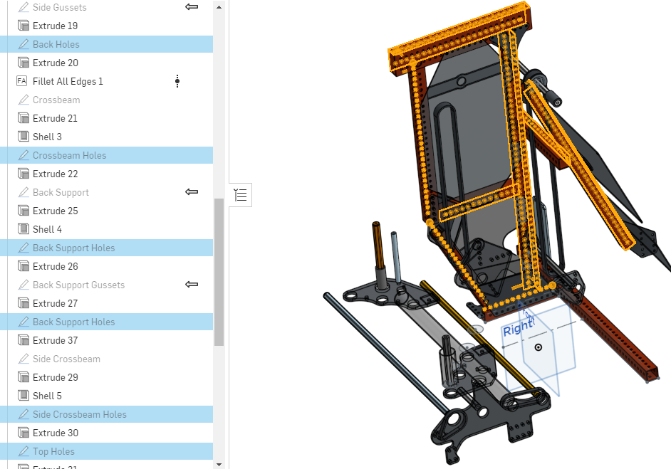

We Typically draw all the tubes in a sub assm in a single master sketch and extrude them from that single sketch, this means that we can go back and change all dimensions for the sub assm in one place.

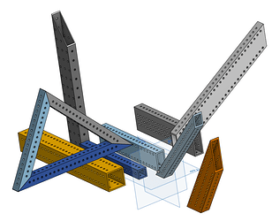

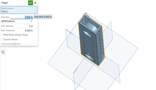

By request of @jjsessa I’ve added a script to convert an extruded block of any size into a hole-patterned tube. Link is here. (“Tube Converter”)

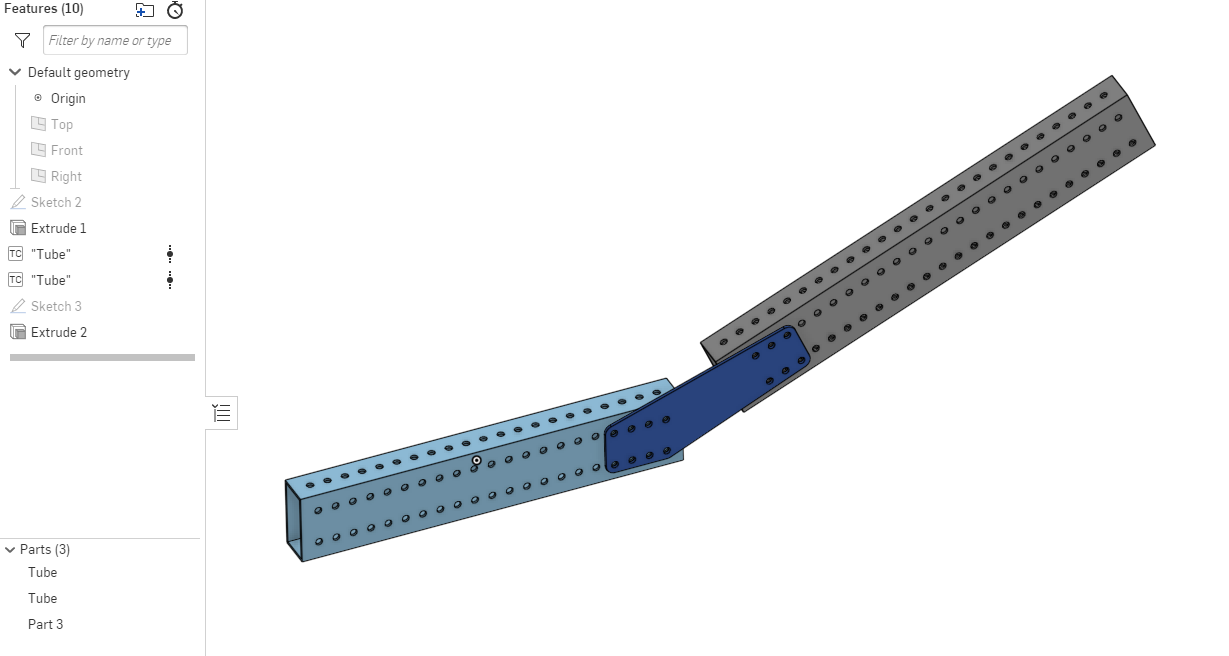

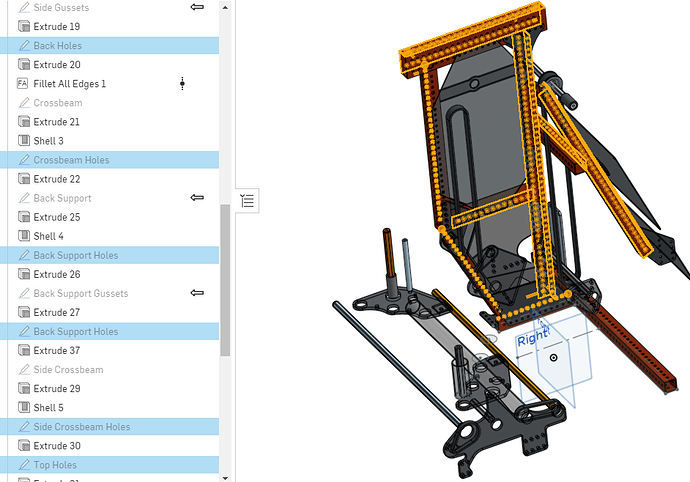

Absolute life saver, especially on tubes that are slanted which would typically require its own sketch + extrude to put holes into.
turns this mess of sketches and features for holes into a single feature per tube:
no way.

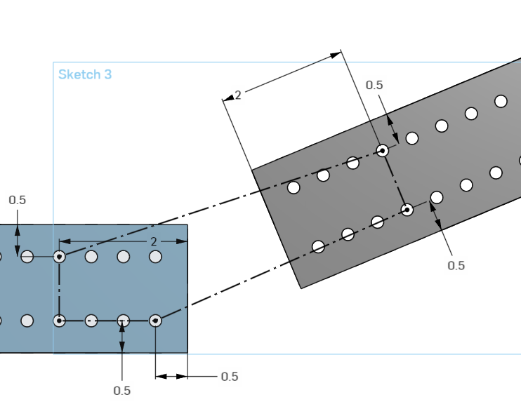

The only “catch” about it is that for things relative to the holes on the tube you have to model it more parametrically since the feature patterns the holes from the center of the tube, but it is good practice to do so regardless
eg:
parametric on the left side, not parametric (uses convert entities for the holes and models based off of those holes) on the right side
From this:
To this:

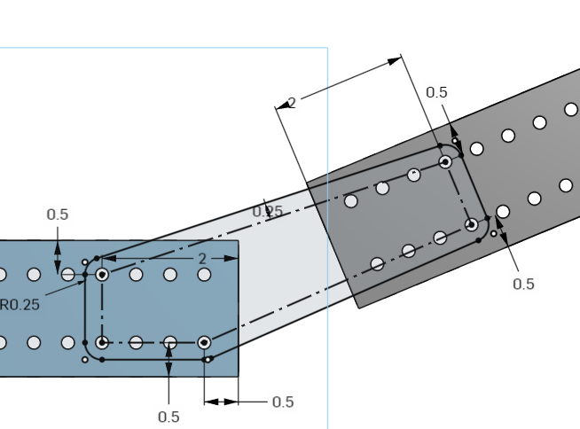

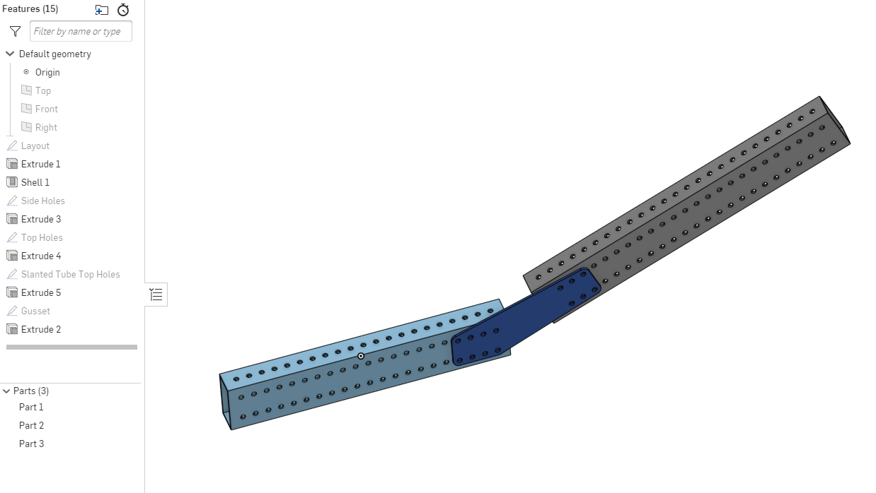

@juju_beans our solution to this problem has always been to model gussets as slots with only the corners of the gussets constrained. This means when we change a tube length we just quickly jump back to the broken gussets, delete the concentric constants and move the corners of the gussets back to the correct holes. Not completely parametric but probably saves more time in the long run.
cough cough parametric gusset feature script? cough cough
Input is multiple tubes by query and a number of rows of holes to cover, output is a gusset in place?

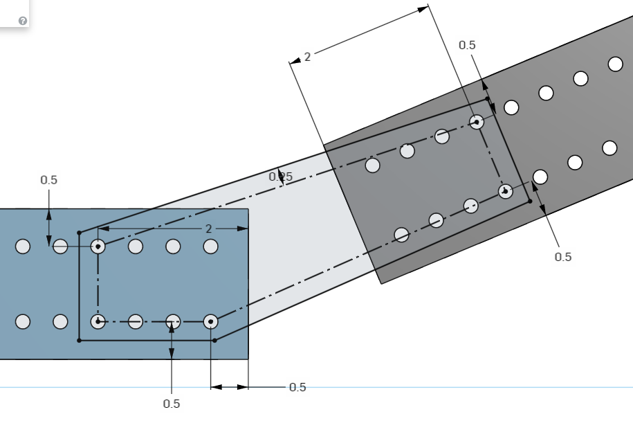

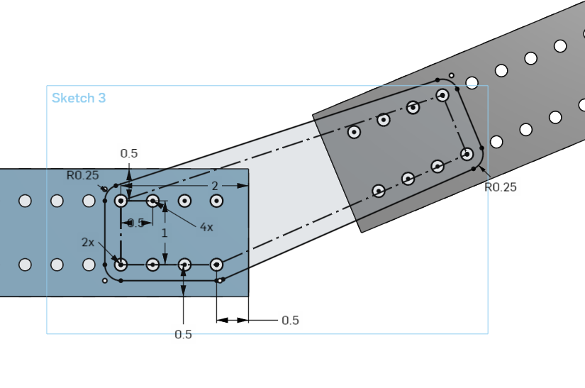

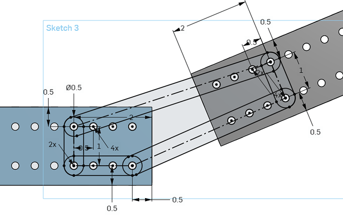

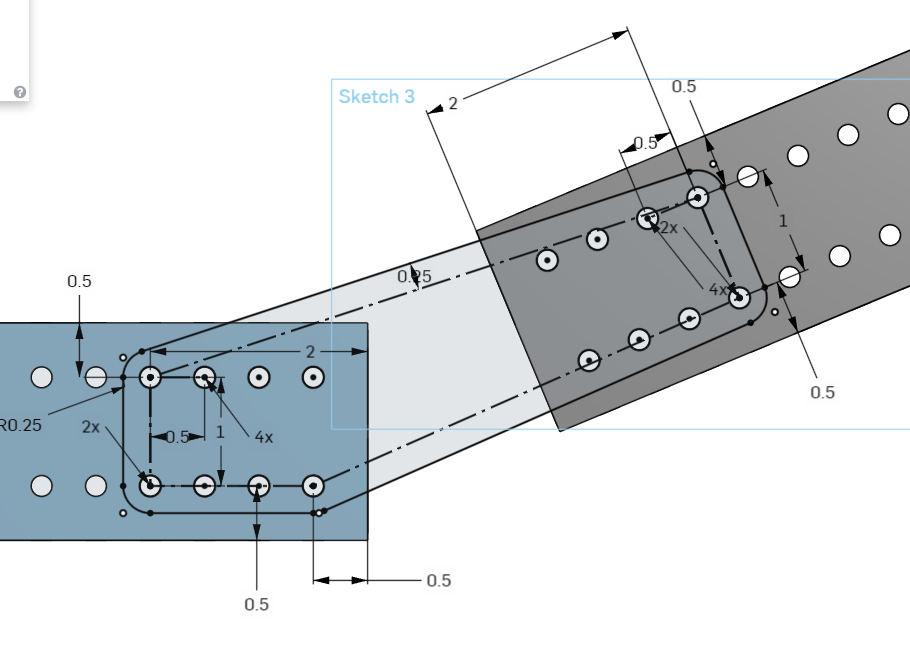

Something like that. Here’s how we draw our gussets:
Construction lines:
Offset the consturction lines:
Fillet the corners:
Put in holes:
Linear pattern of holes (the parametric way):
If I’m lazy I just end up doing convert entities on the holes on the tube, but I’m not sure if that’s the best way for a script to do it.
The same result can also be achieved with slots instead of offset entities, alleviating the need for the fillet step, but it makes the sketch messier:
edit: actually I think the best way might be just to select the outside holes, would make the script easier (?) since it would just draw slots connecting all the holes, but you’ll need something to detect where to put holes in the gusset.

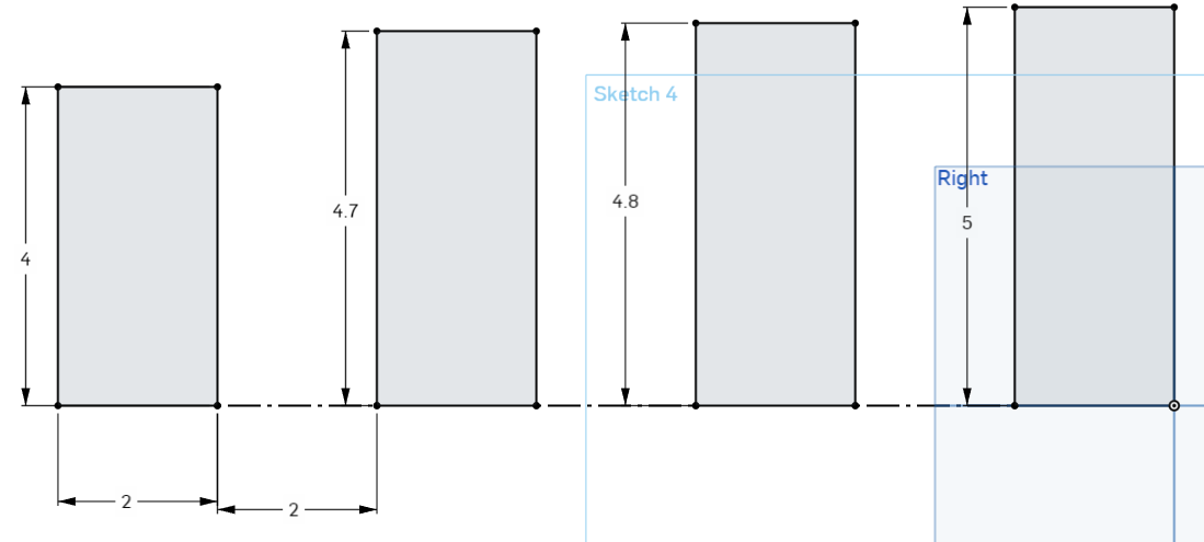

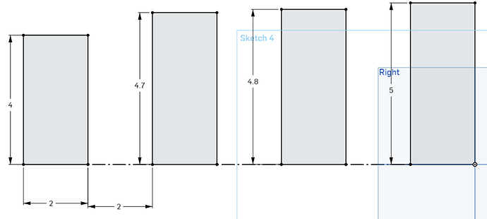

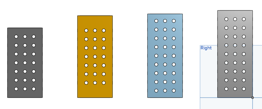

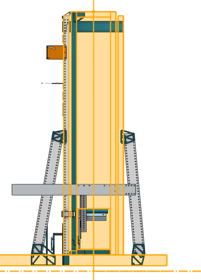

  2. I noticed there is a threshold somewhere between .7 and .8" over an integer length where the featurescript decides to add another row of holes. Could this be adjusted when running a .5" pattern? We would generally like for there to be another row of holes added at the .25" mark above a .5" interval in length. See below screenshots for example. The 4.7" long tube has a large gap at both ends indicating that another row of holes probably should be added sooner in the featurescript logic.

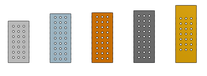

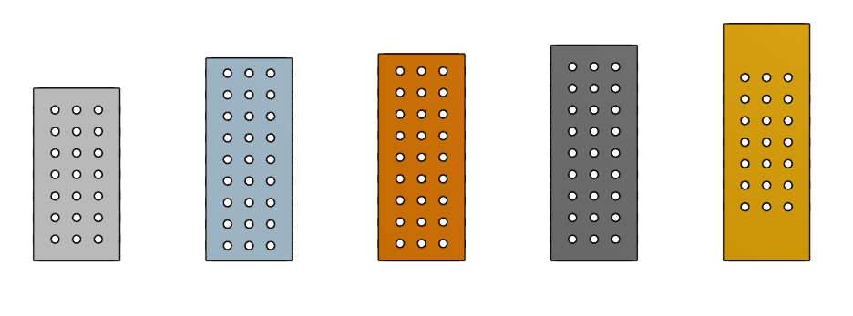

Mike, good catch. The margin is actually based on the hole size because we want to make sure that there are no partial holes. It looks like I was too conservative and set the margin to 2 hole sizes instead of 1 at some point. This is fixed so your 4.7" tube should now have the proper holes.
I’ve also added a margin adjustment box in case you really want an extra row of holes that the script otherwise wouldn’t let you add.
The first 4 are the same as yours, the 5th has a 1" inset margin.
The new version should be published now.

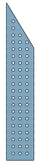

Another feature request! Sometimes, there’s a tube that we’d prefer for the hole pattern to start .5" from one end, rather than centered between the extents. This is particularly applicable for tubes with an angled face on one side, we typically want the square end to be nominal (.5" from end of tube) and don’t care where the hole pattern ends up on the angled side.
Does this make sense? Is this possible?

Thank you for this feature script. I had never used one before and this was very easy to implement and works very well.
(It’s kind of hard to see but this tube has the pattern starting at 0.5" above the bottom)
New version should be available. The option is “Centered on tube” / “Offset from End” and you can choose which face to base off.

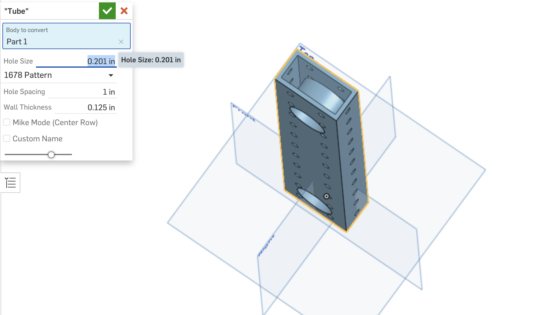

@dydx I’ve loved working with this new tube featurescript. Would love it even more if it worked on tubes with features already in them. Example - I have this tube here that I made and put bearing holes in a previous operation. The FS is doing a good job of hollowing it out, but is creating weird geometry around the hole I already have in there. Would also be nice to have some cases to avoid existing geometry - say I make a tube with critical features then want my normal hole pattern to work “around” it.
