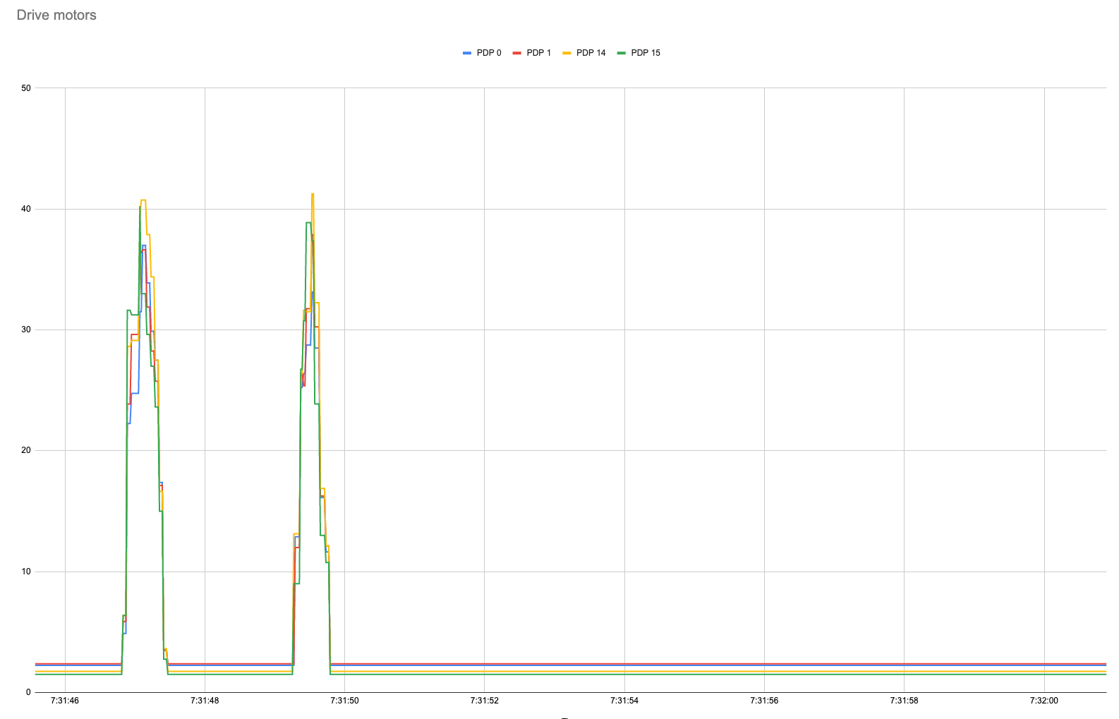

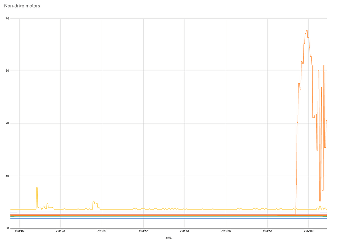

I extracted a couple of charts for the auto period in Elimination 20.
The first shows PDP channels 0, 1, 14 & 15, which I believe to be your drive motors. We can clearly see two bursts of activity: one for drive straight, and the other for turn.
The second shows all other channels. We can see two small bursts of activity on channel 5 during the drives. There’s a big burst on channel 13 right at the end of auto. The remaining channels seem to be drawing a constant 2-3A throughout.
What are channels 5 and 13? Can you identify the channels for the shooter and feeder?
