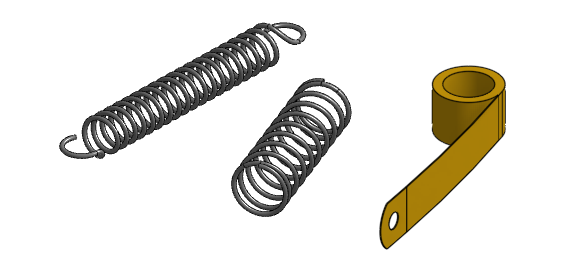

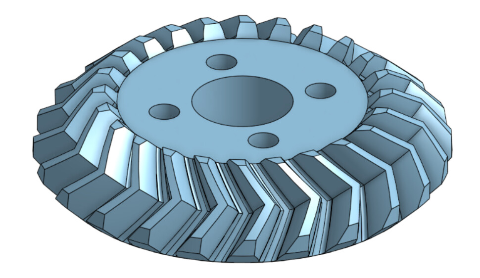

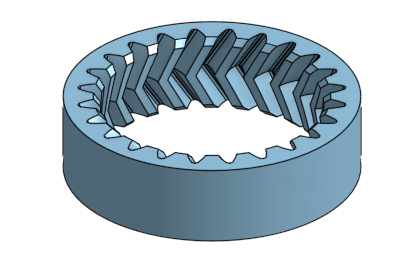

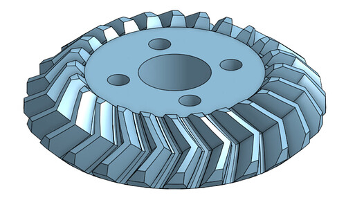

Some updates as of V24:
  • Internal spur gears added as an option to the Gear page
  • Bevel gears have an option for a mate connector at the apex of the pitch cone to help with positioning
  • Constant force springs added to the Spring featurescript. If you input the total length, it calculates the OD of the body based on how much spring is left. Extension and compression springs have the option to generate either coils or a simplified cylindrical body. If you want a dynamic spring, you can use an assembly context.
