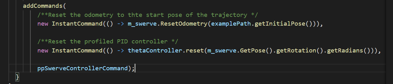

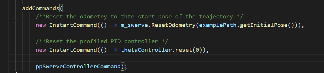

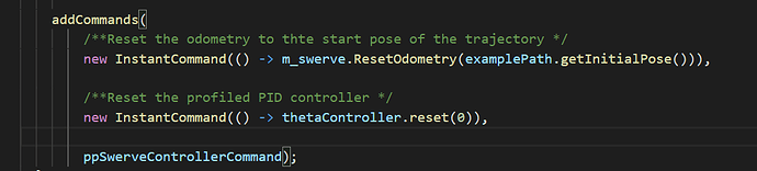

The Profiled pid controller needs to be reset before each trajectory in auto. However , l was puzzled when and where to call the reset() method. Based on my understanding, l should reset it like below:
Besides, which value should l reset?
Any help is appreciated!
You would reset the theta angle to the odometry heading, not 0. You can also use the drivetrains ChassisSpeeds calculated from the current module wheel speeds to specify the omega angle velocity if you think that is important.
Should the unit be radian?
Yes
Besides, should the other two controllers(xController and yController) be reset?
As long as they only have a P gain, they don’t need to be reset. Past error doesn’t affect the proportional gain.
Thanks .

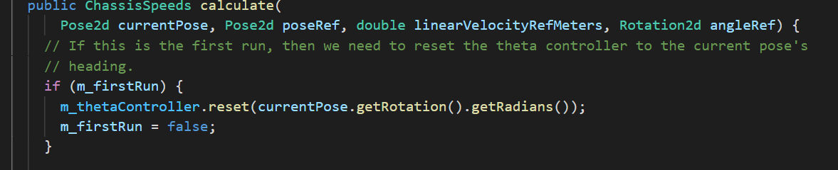

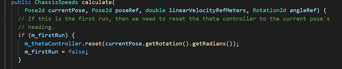

It seems that the holonomic controller do reset the thetacontroller, so why doesn’t it take effect?
That’s only for the first call to calculate, as you can see by the m_firstRun boolean.
Yeah, if l enable the auto mode again and again ,will the first run be reset to true?
No, because you use the same HolonomicDriveController.
