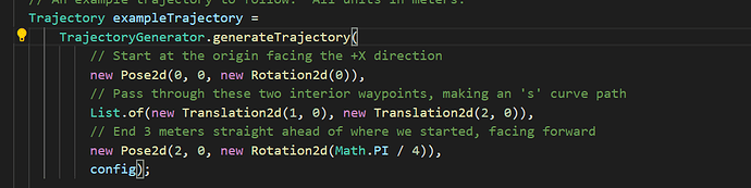

Hello , l have run into some trouble when running the trajectory. l just use this simple trajectory. However , when l let it run. My robot won’t turn 45 degree at the end of this trajectory. It doesn’t turn at all. Can you help me with it?

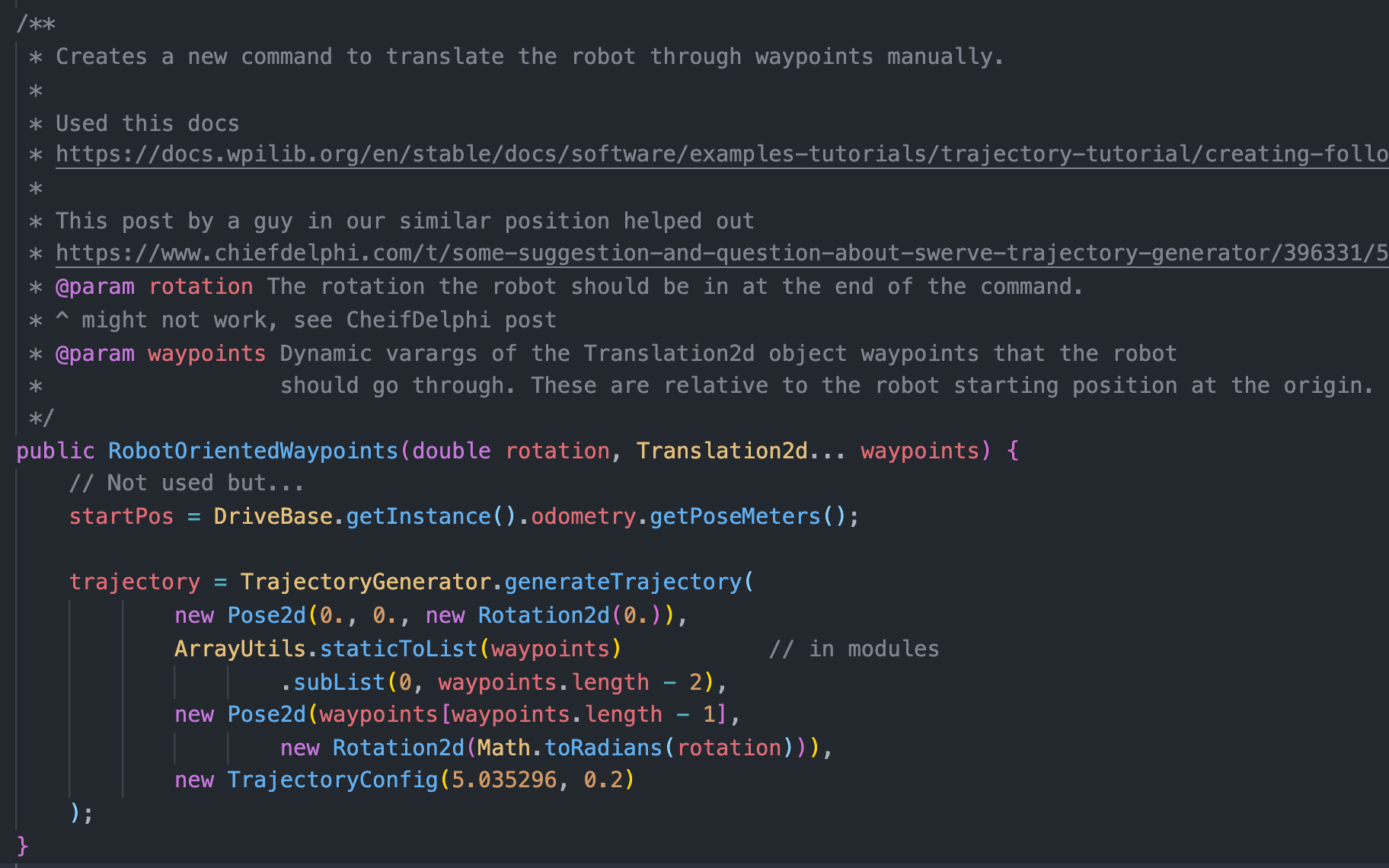

We are working on the same thing and I wrote this today. We are planning to test it at our next meeting Tuesday so I will post if we can get the rotation to work. Sidenote, we have trajectory generation from PathWeaver working for rotation so this is probably an easy fix.
Thanks , do you use swerveControllerCommand or holonomicDriveController?
We actually use neither. We wrote the swerve drive base to follow states from kinematics. During auto, we use a timer to iterate through states of the trajectory, pass through a Ramsete controller, pass through swerve drive kinematics, and we get the states for each swerve module. During teleop we do a similar thing but we send controller input through the kinematics library. The feedback is done using a mix of odometry and gyro.
To follow up, I didn’t work on it today, but the person who did got rotation on path weaver to work (generally). It actually had not been before. There is still refinement to be done but that should be simple, we will post our observations about manual trajectories when we test them Thursday.
As for what he did to solve it, I don’t know, he forgot to push to git, I will reply with an explanation of that as well to see if it helps.
