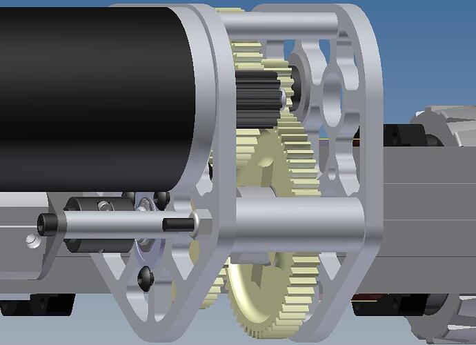

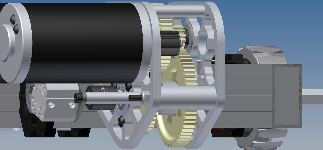

  3. The gearbox in the picture has me confused. Where is the output shaft? It doesn’t look like there’s anything on the inside of the chassis that can be chained to the sprockets?

  3. The output shaft is in line with the wheel closest to the gearbox. That wheel is directly driven from the gearbox. There are two sprockets on this inside of the gearbox, like this, which transmits power to the other wheels

This render of the gearbox in the original post shows open spaces on the hex shafts for versahubs and sprockets like the picture Akash posted shows, just with the 3 CIM version of the gearbox. (Sorry about screwing up the page formatting!)

  3. The output shaft goes through the bottom of the gearbox, through the frame tubing, and into the center wheel. This way, if a chain/belt run breaks/skips, your drivetrain can still drive.

Maybe I’m missing something, but it seems as though the WCP DS 2 CIM gearbox does not have room inside for sprockets/pulleys inside the gearbox. Using the WCP DS - Dual Speed Base Kit step file from the Vex website, there is no room on the output shaft inside the gearbox for pulleys or sprockets. A couple ways off the top of my head to solve this:
  1. Modify the 3/8 hex shaft (I assume this is the “Standard Input Shaft” listed in the included items?) to be longer and use longer standoffs to gain the necessary room.
  2. Do not modify anything but use additional standoffs and/or structure to space the outer plate of the gearbox away from your chassis rail.
Your solutions may vary.

One other thing I was surprised to find once I finally got a chance to tinker with the files is that there is less than 1/32" ground clearance for the 2 CIM gearbox (3 CIM is likely similar) when using the 3.25" Versawheel:
I’d betcha that that’s the standard version of the DS gearbox. There’s a “WCD” version with room inside for your sprockets or pulleys or whatever. It also includes a wheel truck.
We did a mod similar to what you described in 1 for the offseason, in order to turn a standard DS into a WCDish DS with space for only one more output sprocket. It was fairly simple to do, but requires a lathe. Of course, if what you really want is the WCD DS, then you should buy the WCD DS.
