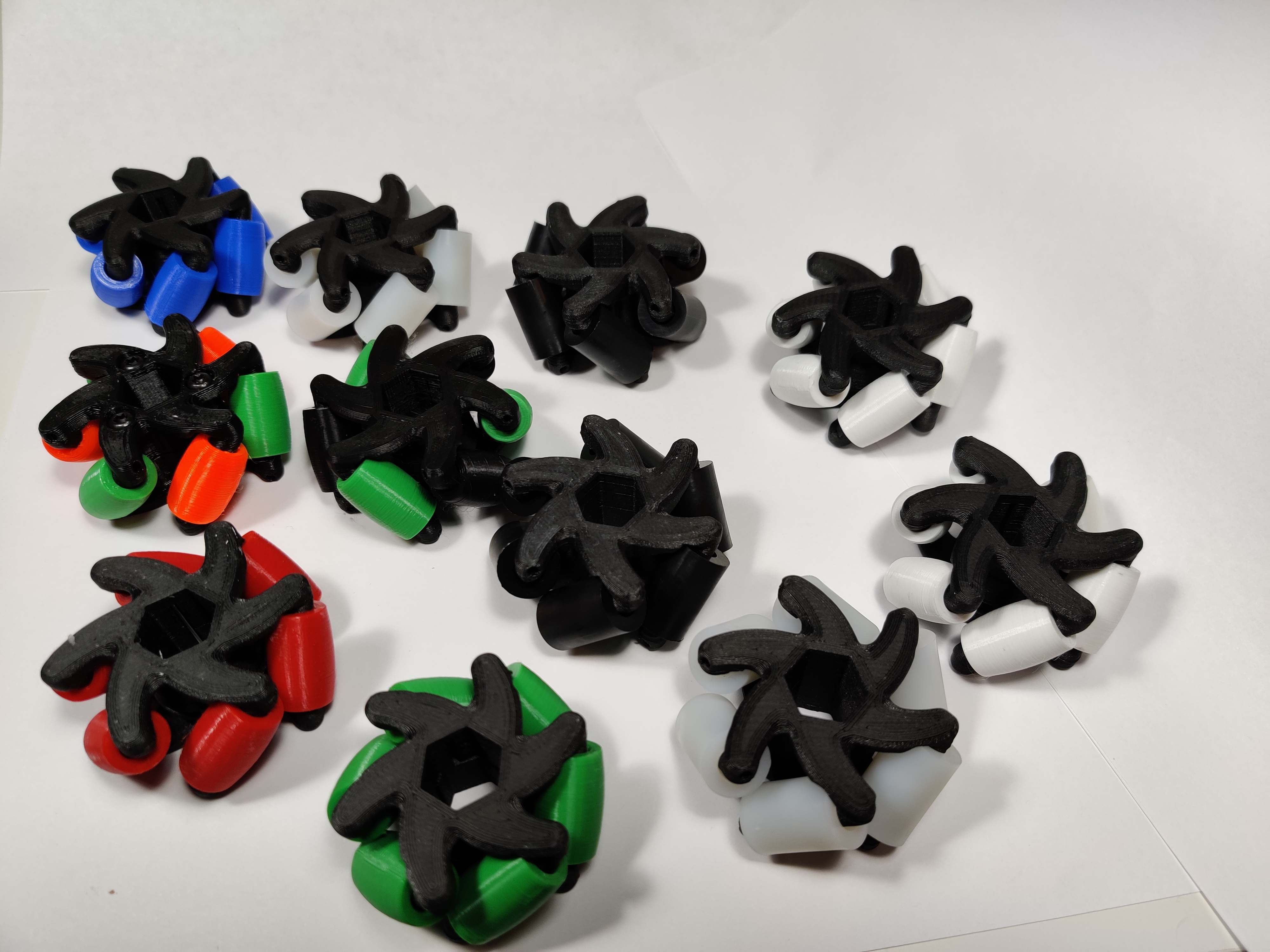

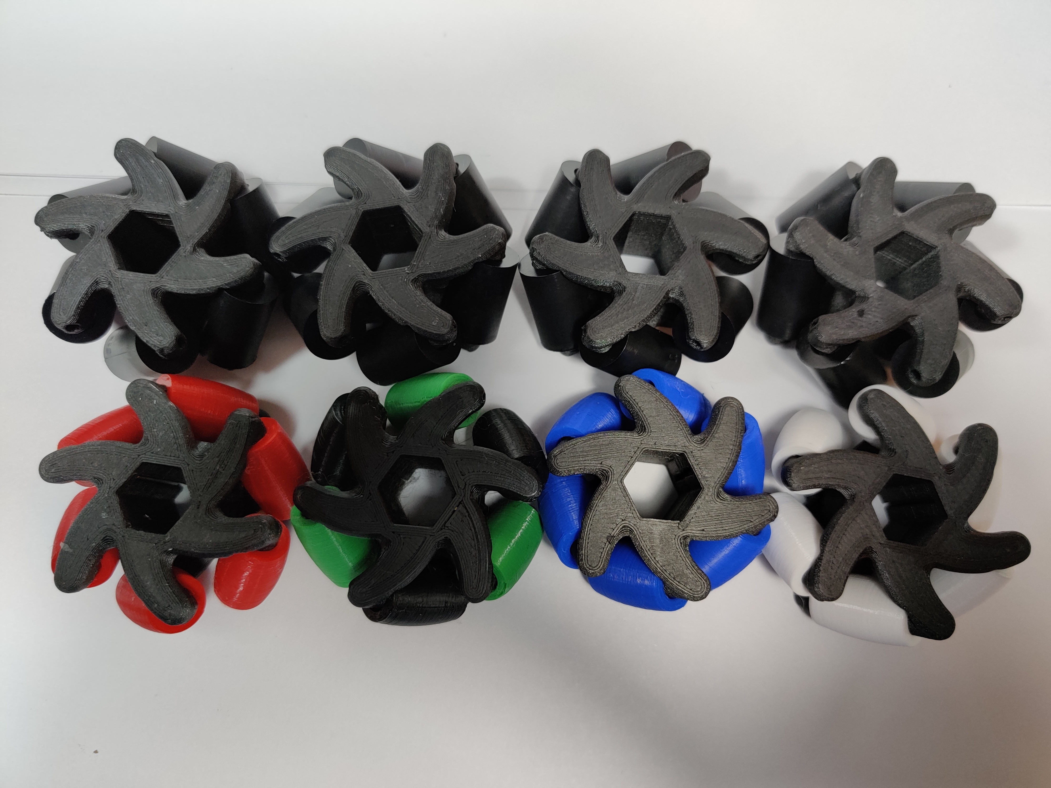

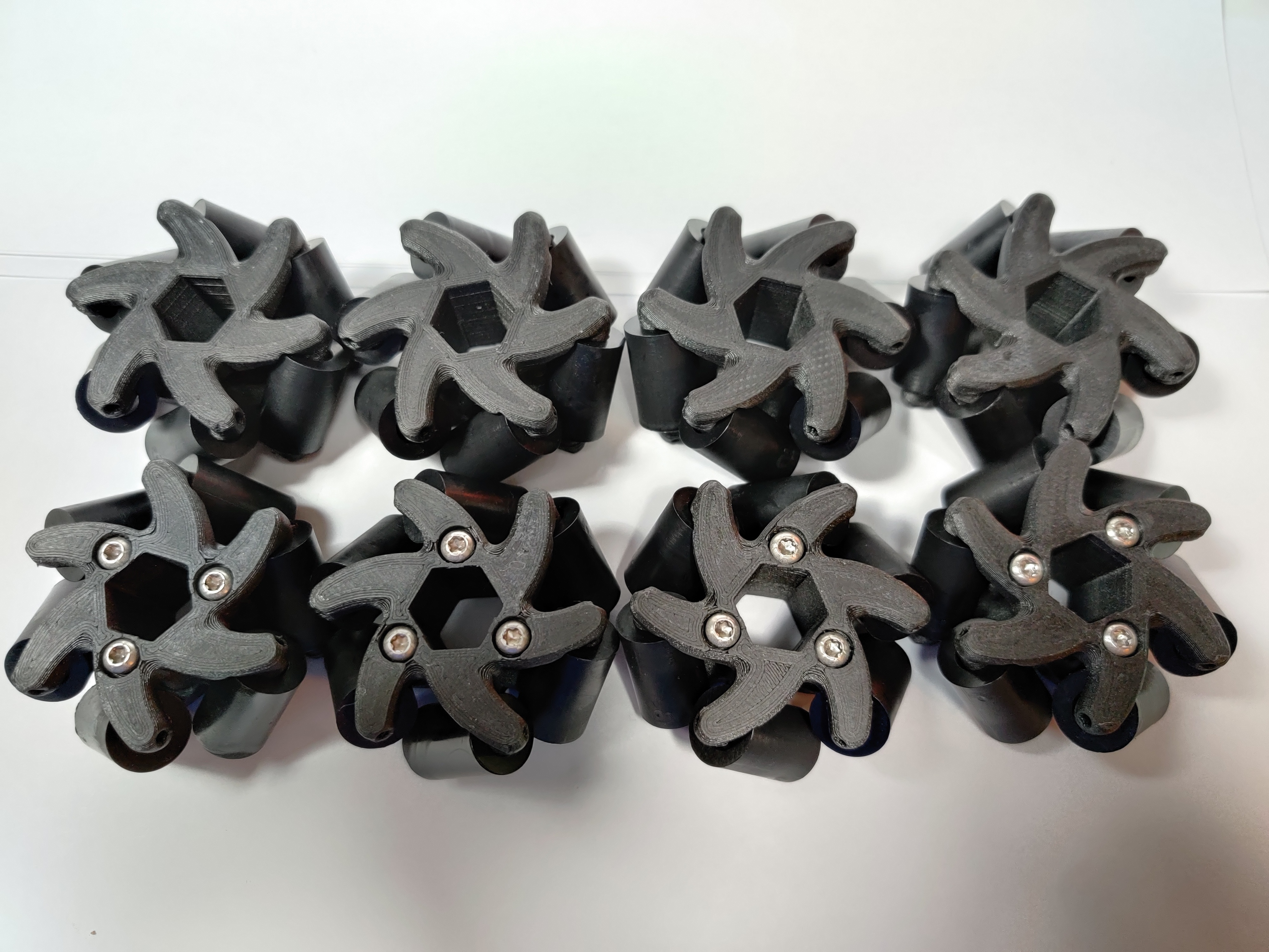

Our Mecanum Wheels are Live: Here
Looks slick. How well do these rollers spin under significant load, such as with a game piece jammed between an intake and a bumper?
The nylon rollers have a lower coefficient of friction with the Markforged core than they do with the gamepiece. This means the roller will always spin against the Markforged part before free spinning on the gamepice. As for the PLA and PETG rollers, their rounded shape means the ball will tend to roll off of them rather than jam. This all being said, I would recommend keeping compression under 1.5 inches with these for optimum centering effect.
Thanks. I know there’s been some issues with 3d printed mecanum rollers not playing nice for more aggressive intakes, so that’s good to hear.
