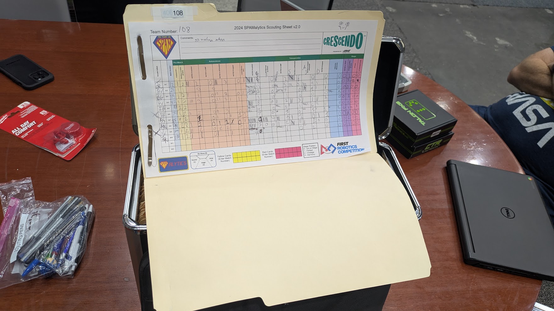

The purpose of SPAMalytics is to provide a foundation for teams interested in data collection and analysis, but who don’t have a system of their own yet. Think of it as the Everybot of scouting.
SPAMalytics has very simple requirements. First, you’ll need a device that can open the Google Sheet. Second, you need to print a scouting sheet for every team competing at your event on Legal (14" x 8-1/2") paper. We use two-pronged manila folders and a file box to keep our sheets organized at events.
